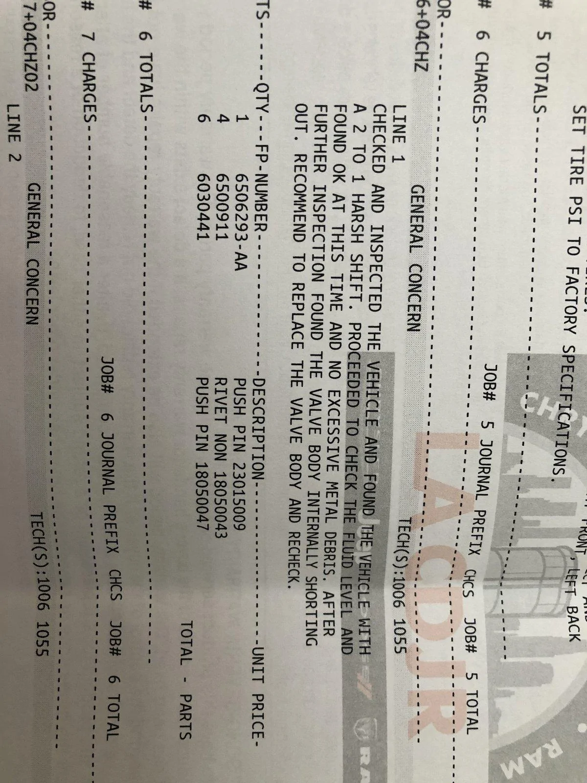

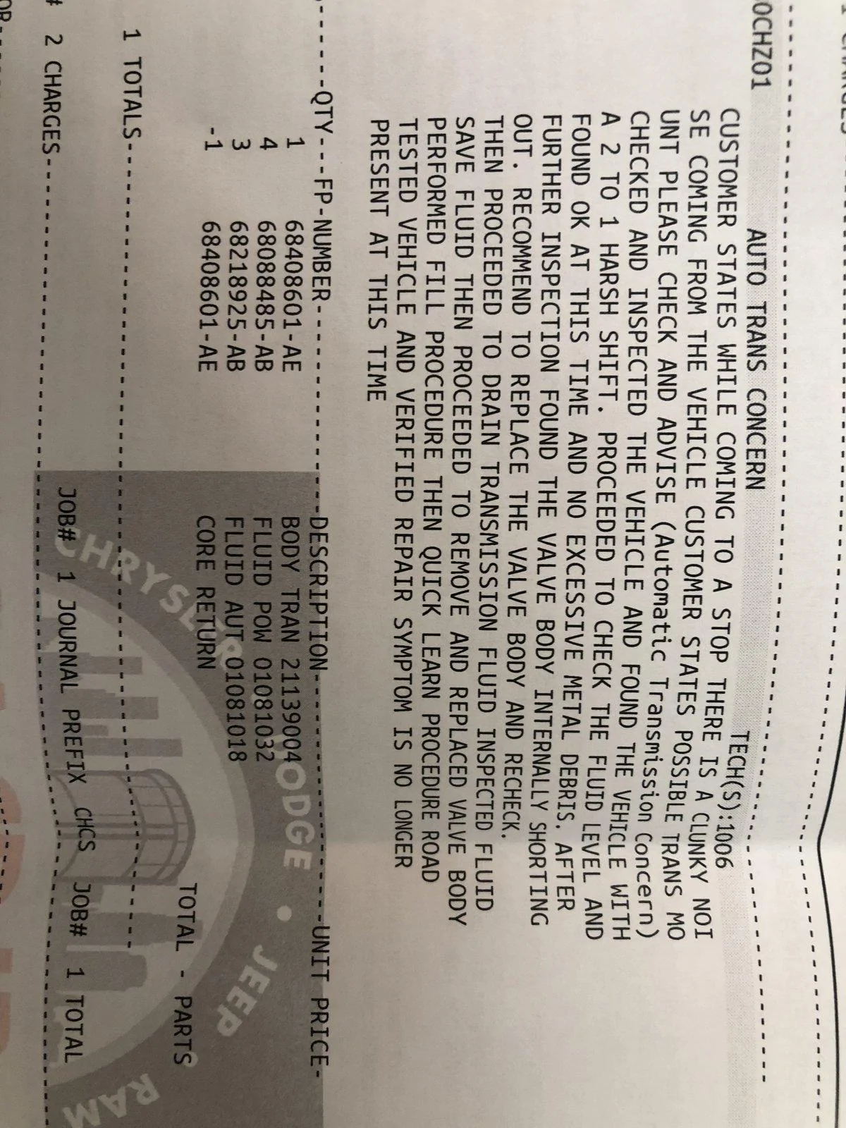

Posted on here numerous times about my harsh and clunky shifting. Dealer finally recognized it as a problem and replaced the valve body. The write-up states the valve body was "shorting" it also seems like they re-used the fluid. I'm no auto trans guru and wanted to see what you guys think about this. Brand new Jeep already needing a major repair like this seems not ok? What makes a Valve body short out in the first place?
Jeep Gladiator Harsh Shifting - Replaced Valve Body IMG_5095
Jeep Gladiator Harsh Shifting - Replaced Valve Body IMG_5096

Just like any other electric device. Why would this be different? And yes, modern fluids in modern SEALED transmissions - no surprise they'd pump it out, use it again. It ain't cheap fluid.
It used to be a transmission shifted when governor pressure over-came throttle pressure. It was a balancing act that included springs. There was no other input other than a link to the throttle either via cable, linkage or a vacuum modulator sensing engine manifold vacuum (low vacuum meant heavy load and increased throttle pressure in the transmission.
Now you have so many other inputs - and it's "computer controlled". This actually dates back to the 1990s - there was a transmission control computer box for the automatics used in Jeeps in the 1990s.
It's gotten more complex - shifting is controlled not only based on load and road speed, but engine temperature, trailer load and more.
These can malfunction like anything else - and of course any electrical problem to most people is a "short" because they don't know the difference between a short, open, or ground........... so it's automatically called a short no matter what it was.

Following, thanks for the pictures. How often did this happen to you? I have the same issue downshifting at low speeds, but it doesn’t always happen
It happened almost every stop. The valve body did cure the "clunk" i got when stopping, however still having rough shifting problems
