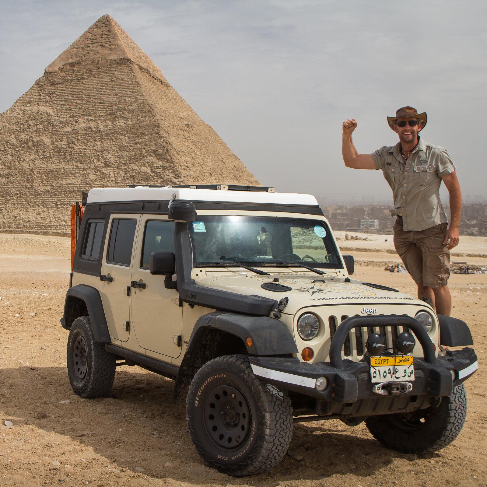

Hi All,
This is me and my JK running "Mopar Winter Wheels" Part Number: 52124455AB
Jeep Gladiator Has anyone bolted the Mopar Winter Wheels onto a Gladiator? giza-pyramids-jeep-dan-victory
I'm wondering if anyone has actually bolted them on a Gladiator?
Backspacing-wise they should be OK, but they might have a problem clearing the rear brake calipers (which are much bigger than on my JK).
Has anyone ever actually tried one on a Gladiator?
Also I know there are other wheels that look similar (including the spare steelie), but I'm interested in these ones exactly.
Please only reply here if you have experience with these wheels on a Gladiator.
Thanks,
-Dan
