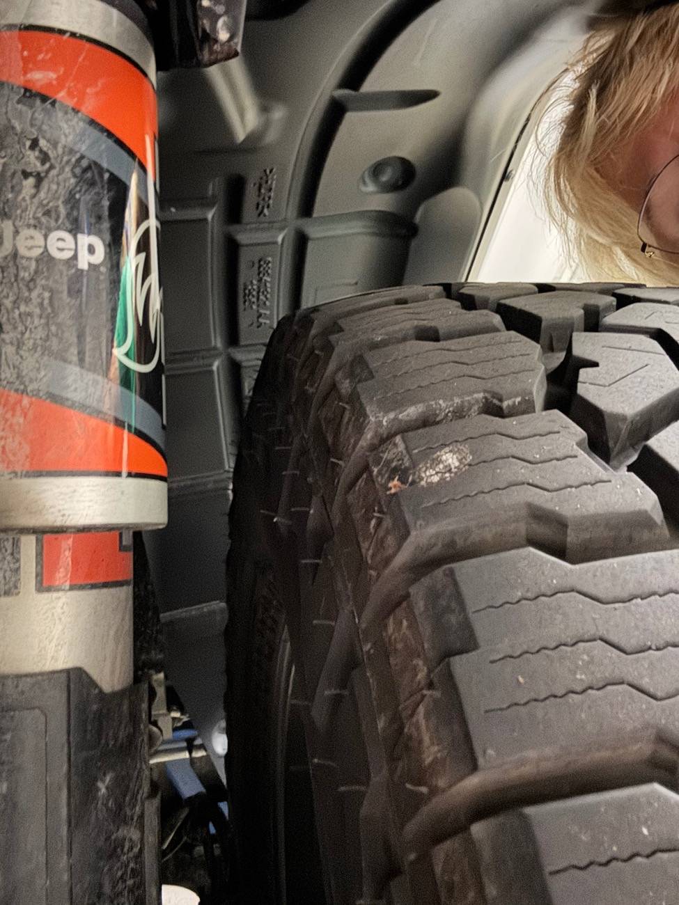

However…. I’m seeing there’s only 2” of clearance in the rear with the Fox shocks. No concern on the front - the Fox shocks are tucked next (& behind) the coils.
This is all good information, as its making me think a little harder. I‘ll definitely take the wheels off to look at the specs. Information online varies (and can‘t be trusted).
I’m assuming that 2” clearance in the rear is something I’ll want to stay with…..for suspension travel. Not that I’m ever gonna go offroad to flex it….but, that’s a concern also.

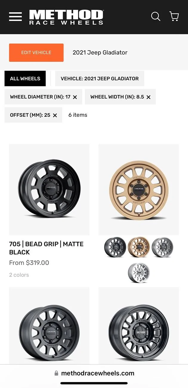

That wheel size will probably work. The tricky part is finding it. It’s probably not a popular size. If you go with an 8.5,+25 (I found it on Method Wheels for example) then the wheel will stick out a bit but the tread of the tire will probably be at the edge of the fender. Someone else may have that setup but I still have stock wheels.

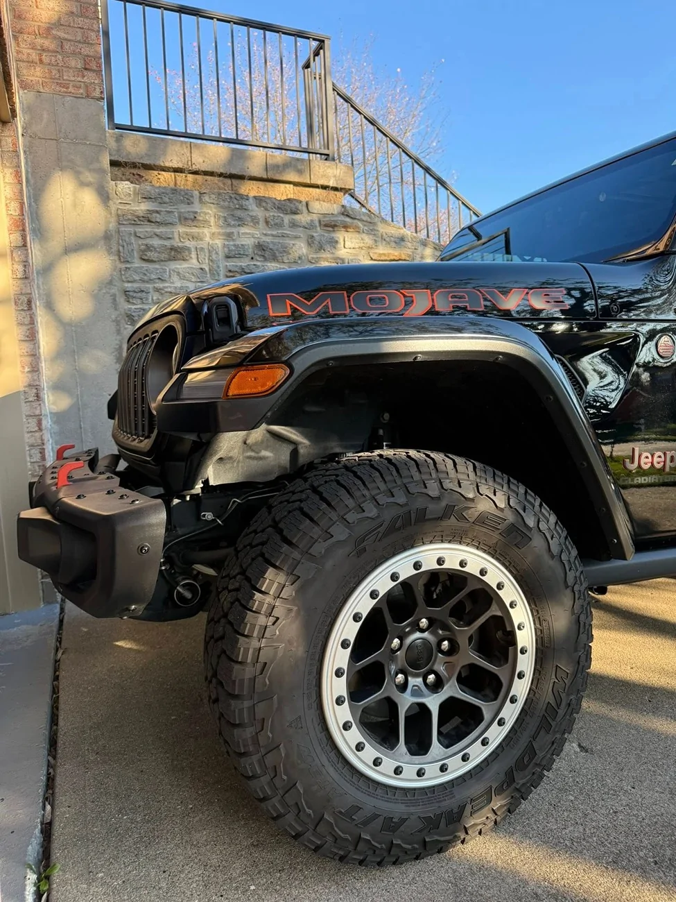

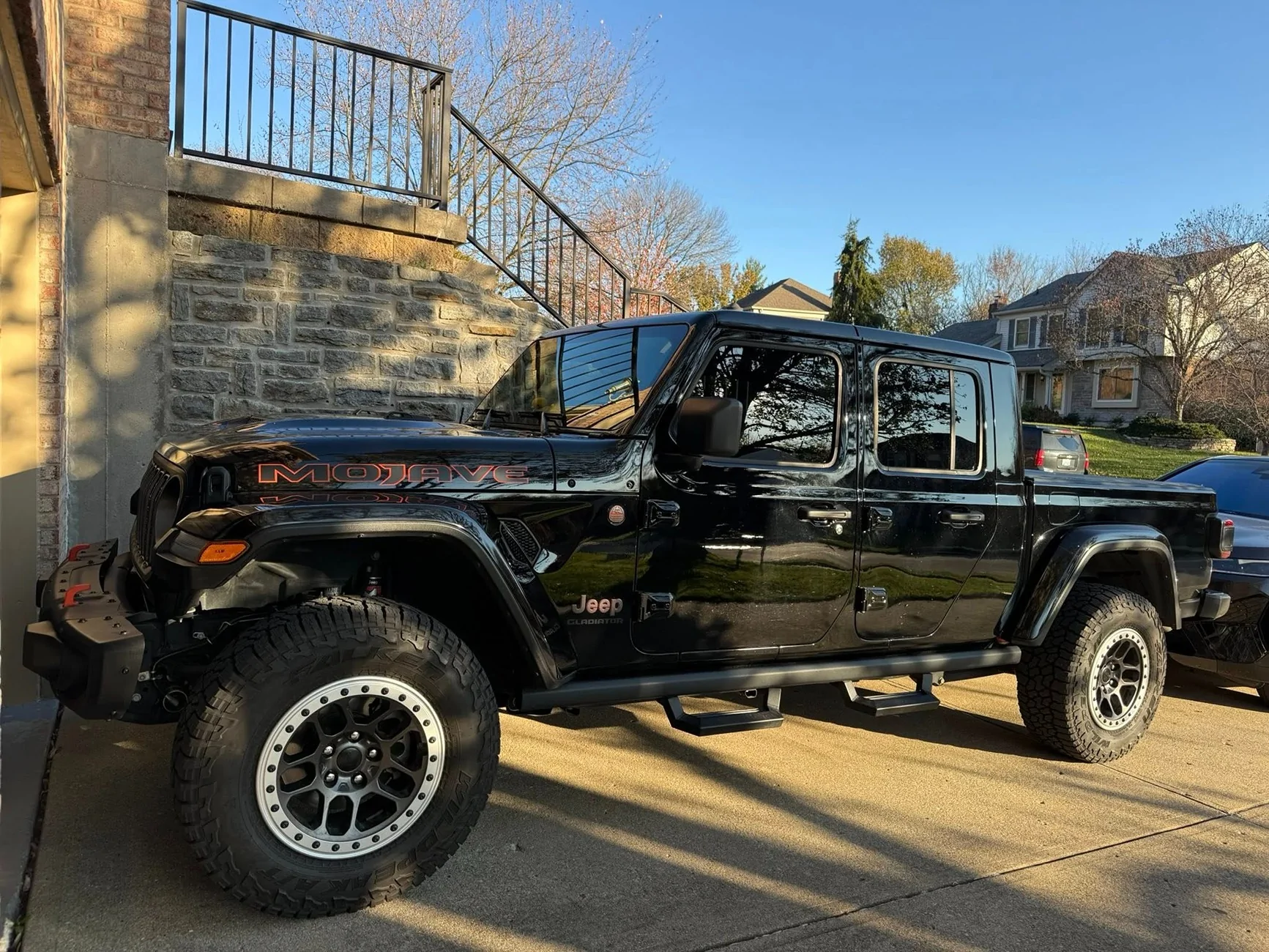

OEM 285/70/17 with 8x17 Rubicon XR wheels. They are +12 offset, so it poked 0.985 inch.
