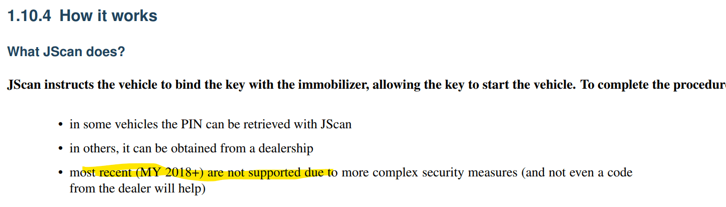

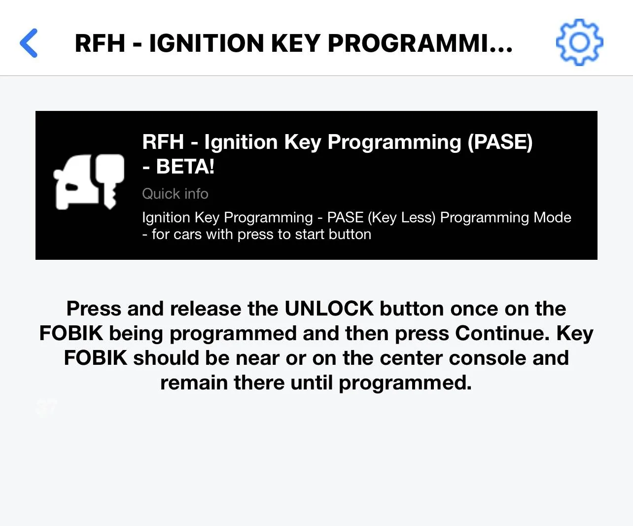

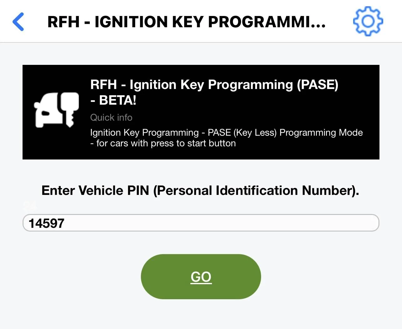

Jimmy, thank you for checking into this. I appreciate you showing the pages and walk through the programming. I agree it would be to their benefit to be able to read the static 5 digit pin. In the meantime I will contact my guy at the dealership and he will help me obtain my static 5 digit pin so I can program my fob.
249
40,510
54,105

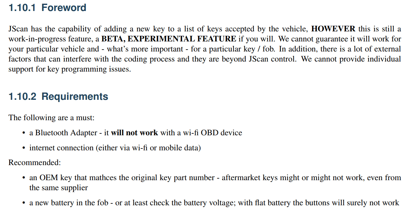

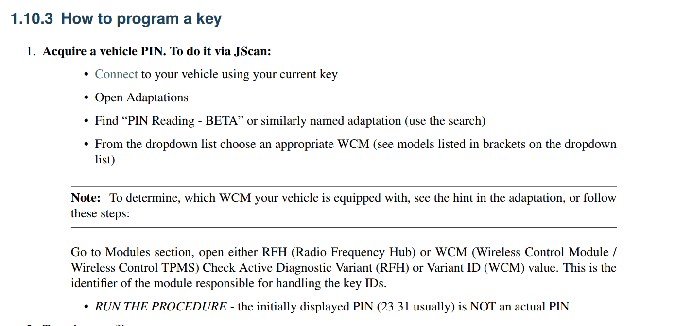

AlfaOBD can not obtain the PIN either (FYI, AlfaOBD and Jscan both use the same chrysler program to obtain the info they use to build their apps)

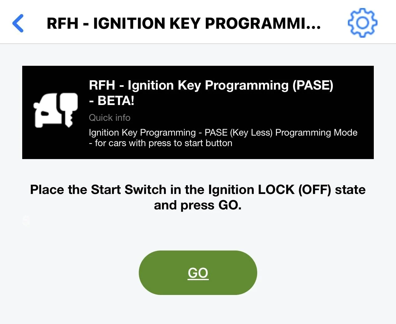

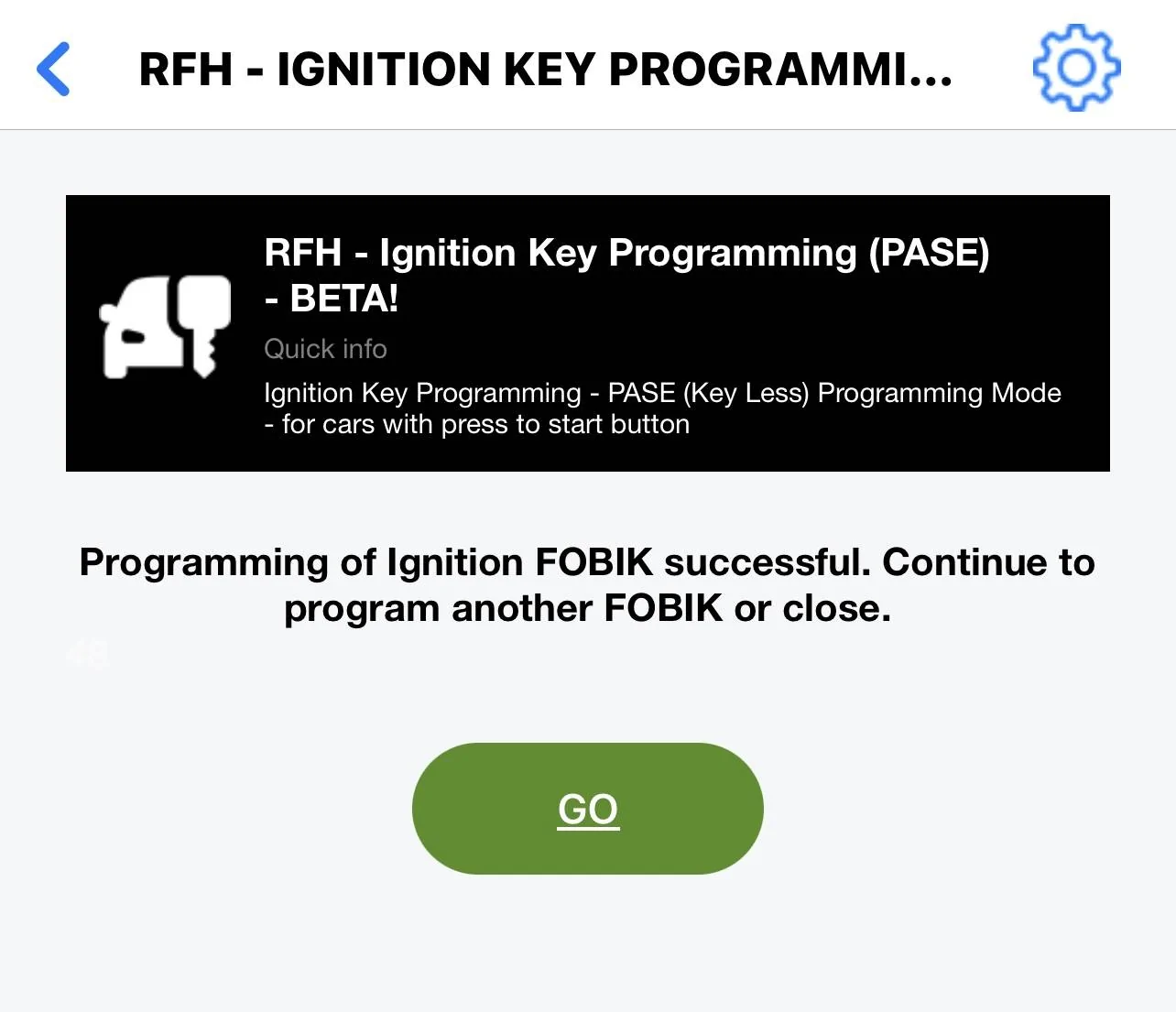

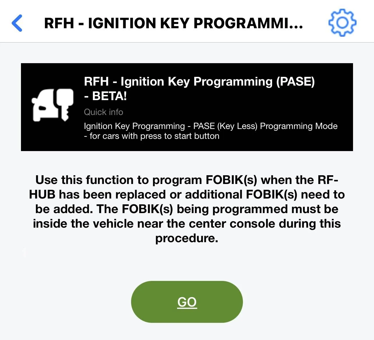

I can tell you without a doubt, that Jscan or AlfaOBD can not program a fob on the newer RF Hubs even with the correct PIN. I’ve tried it every which way with multiple different RF Hubs from multiple different 2018+ vehicles (with the exception of 2018+ ram classic).
Actually, I’ll go try again right now, since I happen to have a 2021 Ram 2500 module set on my bench setup right now. I’ll get some pics of what goes on.

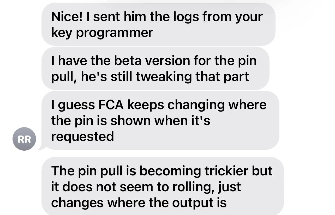

I wonder if Jscan developer is in the US, I could send him my programmer to figure out how it pulls the PIN.
Europe - you can reach him best via a messenger message on is FB page (OBD JSCAN facebook page.)
He usually responds best and fastest that way.

I didn’t even know this, but a guy I collaborate with on mods borrowed my programmer, and already sent him the logs, which he used to dial in the programming, and is still messing with pulling the PIN.
