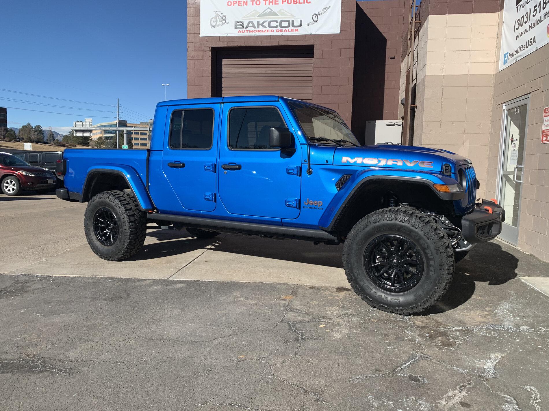

Alex here, new Jeep owner. I lifted it in the first week I had it. New tires and wheels. Thought I would share:

Looking sharp!
Give us the lift details.

Thanks for the kind remarks! I have heard some people call the lift "The Ginger Beard Lift". I followed along with what Epic did and it came out very nice. Here is the list of parts used:
# 1375300 - JT 3.5" Spacer Lift, No Shocks - Utilized front swaybar links in the rear. - Utilized 2" worth of rear bump stops (1.5" upper, 0.5" rear pad). - Utilized front 2" bump stops. - Utilized 1.5" rear coil spring spacer. - Didn't use the rest of the kit, put it in a box on the shelf.
# 05-01-309-050 (x2) - 0.5" rear coil spring spacer, bolted together with the 1.5" spacers from
the first kit listed above : # 1375300.
# 05-01-109-200 (x2) - 2" Front coil spring spacers.
# 1764000 - JT front swaybar front disconnect kit.

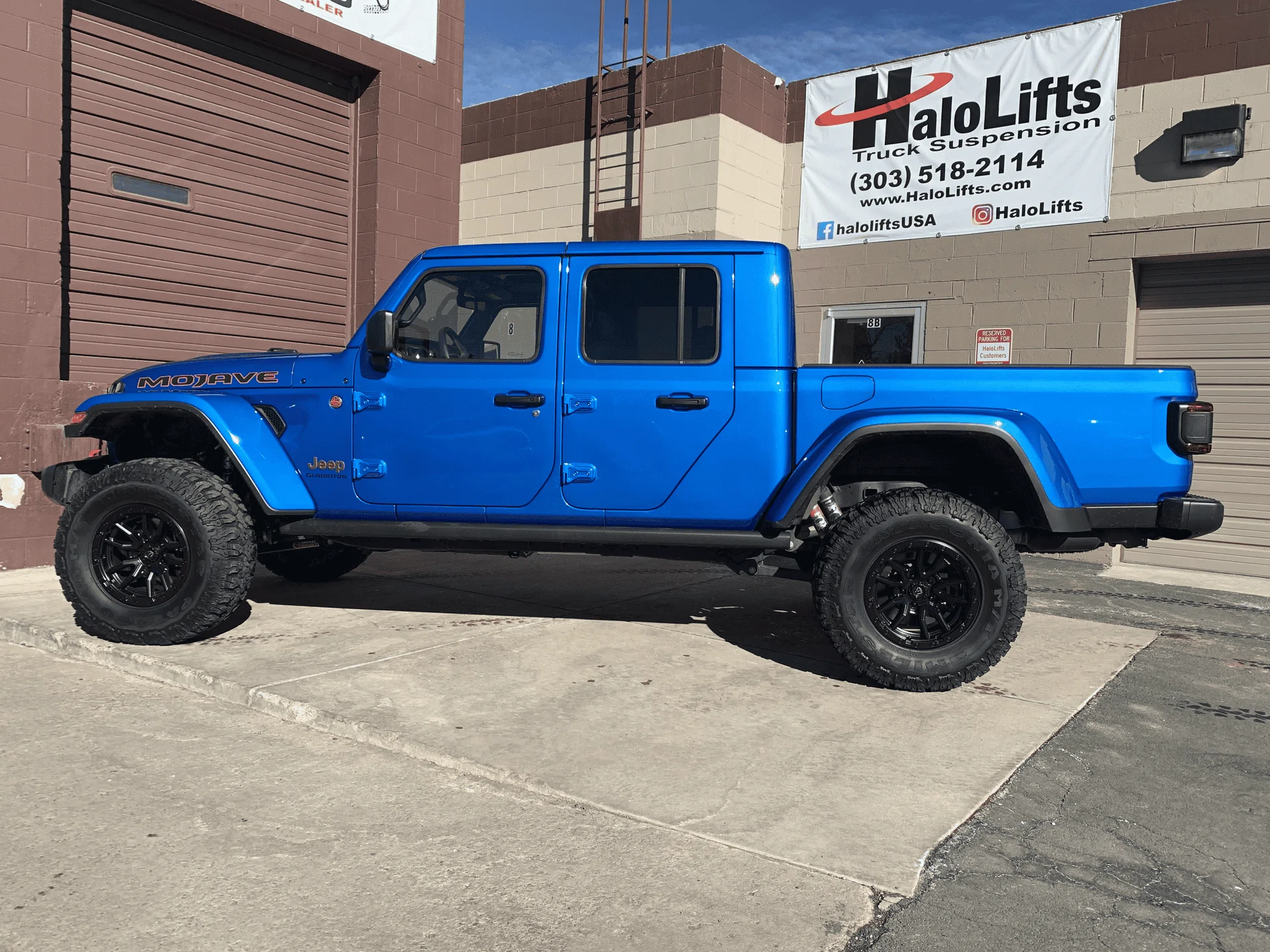

Looks great! I’d like to see some pics from different angles.

I had this pic, I'll take some more.
