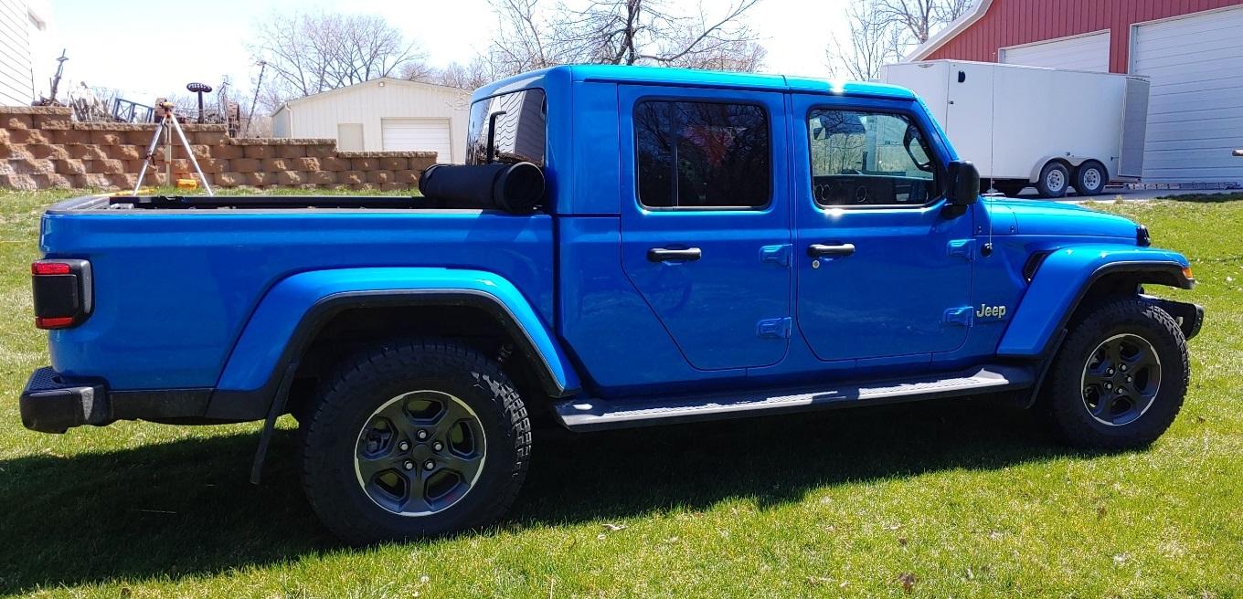

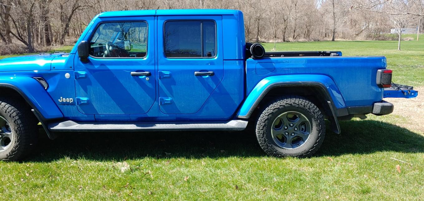

This is my truck with 1060 pounds of retaining wall caps in the back over the axle. With no rake I'd have been bird watching on the way home. To me, it's a truck first, then a Jeep. Well, that depends, tomorrow it will be a Jeep first, maybe a truck.......

What did you do to the rear suspension to make it stay level with 1,800 lbs. in the bed?
My Max Tow would squat like a stripper at a pole if I put 1,800 lbs. in it. I put 1,300 lbs. in it one day to shoot a video for YouTube, which was MAXED OUT with me in the driver seat, and the bump stops were on the perches it squatted so bad. And that's with the springs that are allegedly the highest spring rate you can get from the factory.
Heck, today I have a Ram 1500 with a 1,645 lb. payload rating AND Timbren SES helper springs rated for 8,000 lbs. and my truck will still not sit level if I put 1,800 lbs. in it.
You must be running air bags.

No air bags. It's got max tow springs and Daystar 3/4" spacers, that's it.

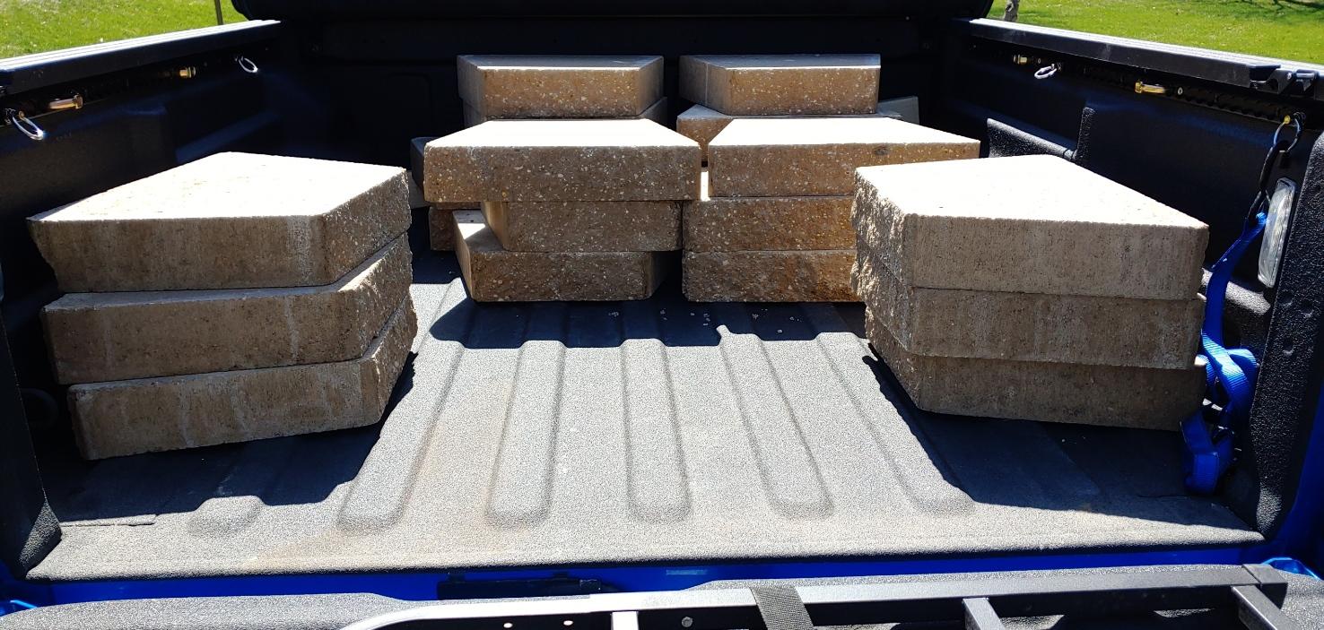

The picture is with 20 caps each weighing 53 pounds according to the specs (and what the guy lifting them out figured as well) for a total of 1060 pounds that trip. They were well distributed, 100 more pounds ahead of the axle than behind it.
The bigger load was also spread in the box and I tried to keep more ahead of the axle than behind but they were mostly spread through the box.
I counted the blocks 3 times and each time came up with 150 blocks.
The specs say they weight 12 pounds each. Carrying them, I'd guess that's pretty close. They are at least 10-11 pounds, but likely 12 because two of them is similar to carrying 25 pounds of cat food.
Even if they were only 11 pounds, that's about 1600 pounds, at 10 pounds, that's 1500 pounds.
This one taken right after I parked the truck in my yard with the 20 caps, 53 pounds each. So this is sitting with 1,000 pounds. The other pic below this shows how I had them stacked and you can count the 20 in that pic - 8 of the caps (two stacks of 4 each) are ahead of the axle, so 424 pounds was in front of the axle.
6 of them (2 stacks of 3) were right over the axle (318 pounds)
Maybe that's the trick - how they were loaded.
