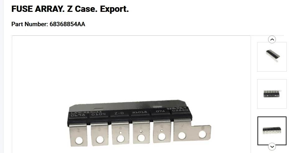

is this the fuse array you are referring to?
Yes, that handles all high current devices, including the charging system (alternator to batteries)
If that's blown, any number of things can happen, including battery (batteries) not charging.
Make sure you get the right one as there were earlier versions that supported lower amperage for non-tow package JTs. They changed them sometime around 2021 model year I believe.
That is the high current fuse array - it's on the end of the PDC on the engine end where the studs are (where N1-N8 are)
Any one section blown, you replace the whole thing.

ok all is good now. i did put the battery on the charger last night for good measure and it needed it. i havent driven my truck in the past month. its been back and forth between shops. i did take off the 320 amp alt and put my stock unit back on. i replaced the fuse array, because it was indeed no good. after all was buttoned back up, i fired it up and it was charging like it should have. Oh and i did pull the 42 fuse just because you suggested it. the IBS had already been unplugged from my previous research before this post. thank you for all of your advice. but be a little more open minded about people wanting to add amplifiers and lights and what not to their vehicles. i have been doing stereo stuff since i got my first car. but this smart charging system was a first for me. lesson learned and onto to other things.
