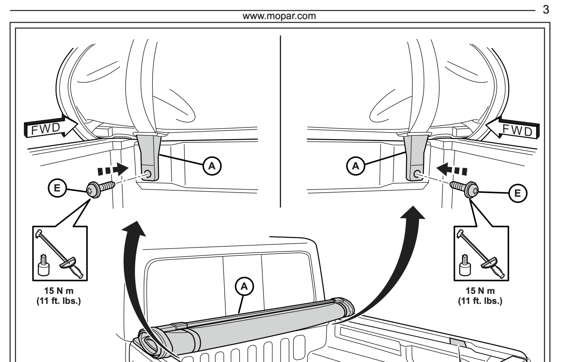

In the picture below, the mounts with the "A" pointed at them do not look like mine from the take-off. Where they show the bolt hole, that lines up with the bottom hole on the bed, which has bolt threads. The take-off version has a "tab" there that inserts in to the bolt threads. Then there is a higher hole above it, that aligns with a hole on the truck bed that has no threads. I can't find a part number for that bracket "A".

there are 2 different versions of the cover for 2020 and 2019 there is a threaded hold there and sometime in the 2020-2021 production they took that away so the newer version on the cover comes with what you need to attach it basically a nutsert. There are lots of threads on this and most people just get a bolt and take care of it that way when buying used

July, 2020, they stopped threading that hole. Other cover manufacturers used it, too.

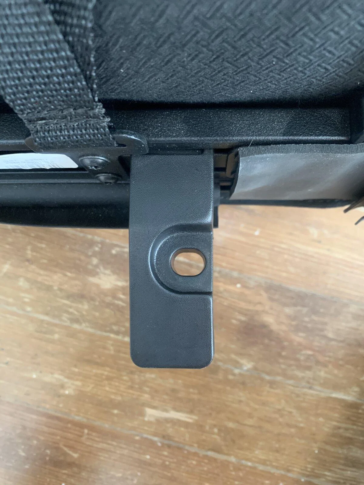

I just found this thread, in which the installer realized that the bottom hole was unthreaded. My bottom bolt actually IS threaded, but the mount I have only makes it available for the upper hole. See picture below. But I guess the answer is the same - put in some kind of nutsert in the upper hole, or find a way to get a nut behind the bed (which still would have problems since there's no way to get a wrench in there to hold it when tightening).

Thanks @Kevin_D and @johnparjr -
Yeah mine is not like that

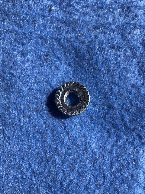

I used nuts like this...
Jeep Gladiator Help! Installing a Soft Mopar Tonneau Take-Off IMG_6562
Once they make contact, they won't spin, so you don't need to get a wrench in there.

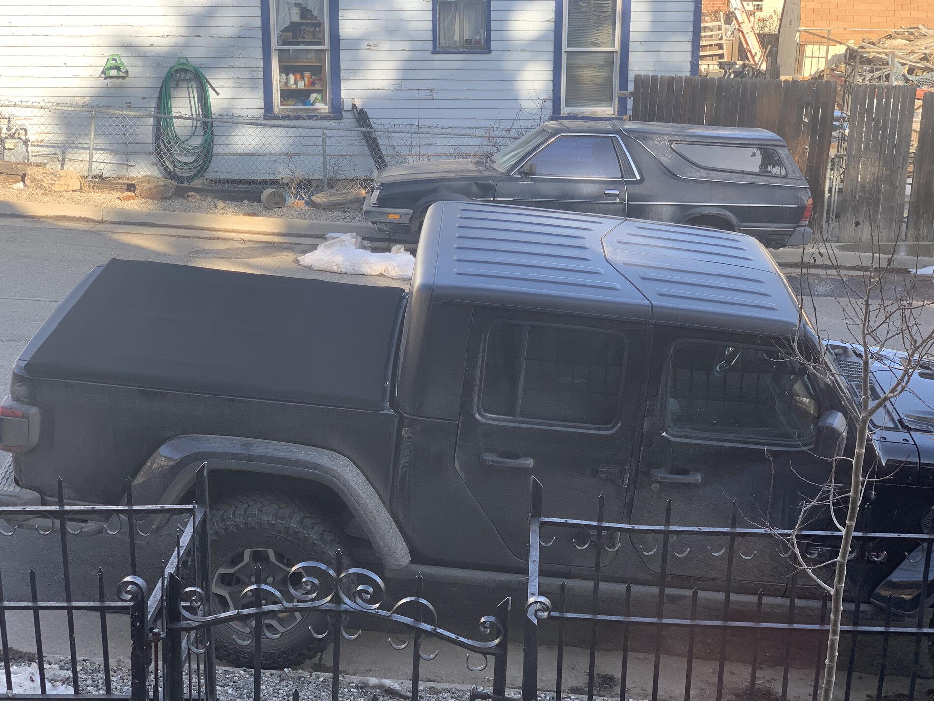

Thanks for the replies all. Update - got this installed in time for a few heavy snows this week.
For anyone who finds this thread in the future and is in a similar situation, I used a nut like that shown by @Kevin_D. The trick for me was to use a ratchet to hold that nut between the bed and cab. I had my wife hold the ratchet and slowly move it around while I eye-balled to get it lined up. Also helps keep the nut from spinning while you get started.
Pretty easy process once we thought to use the wrench.
Jeep Gladiator Help! Installing a Soft Mopar Tonneau Take-Off IMG_2641
