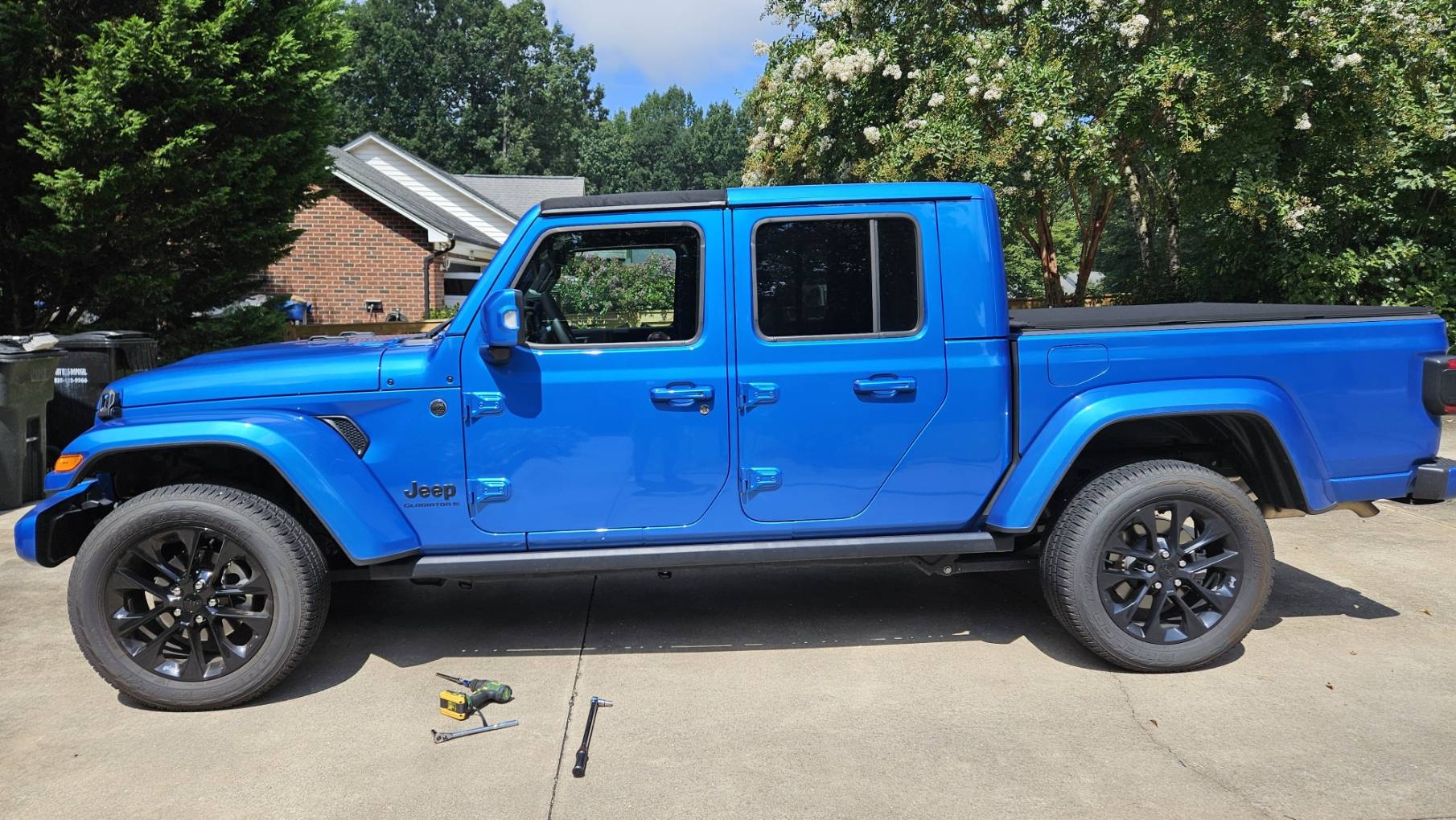

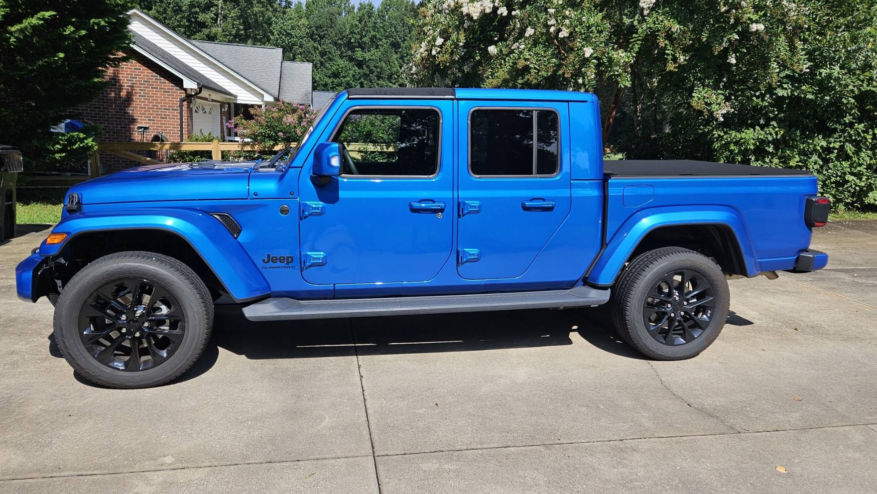

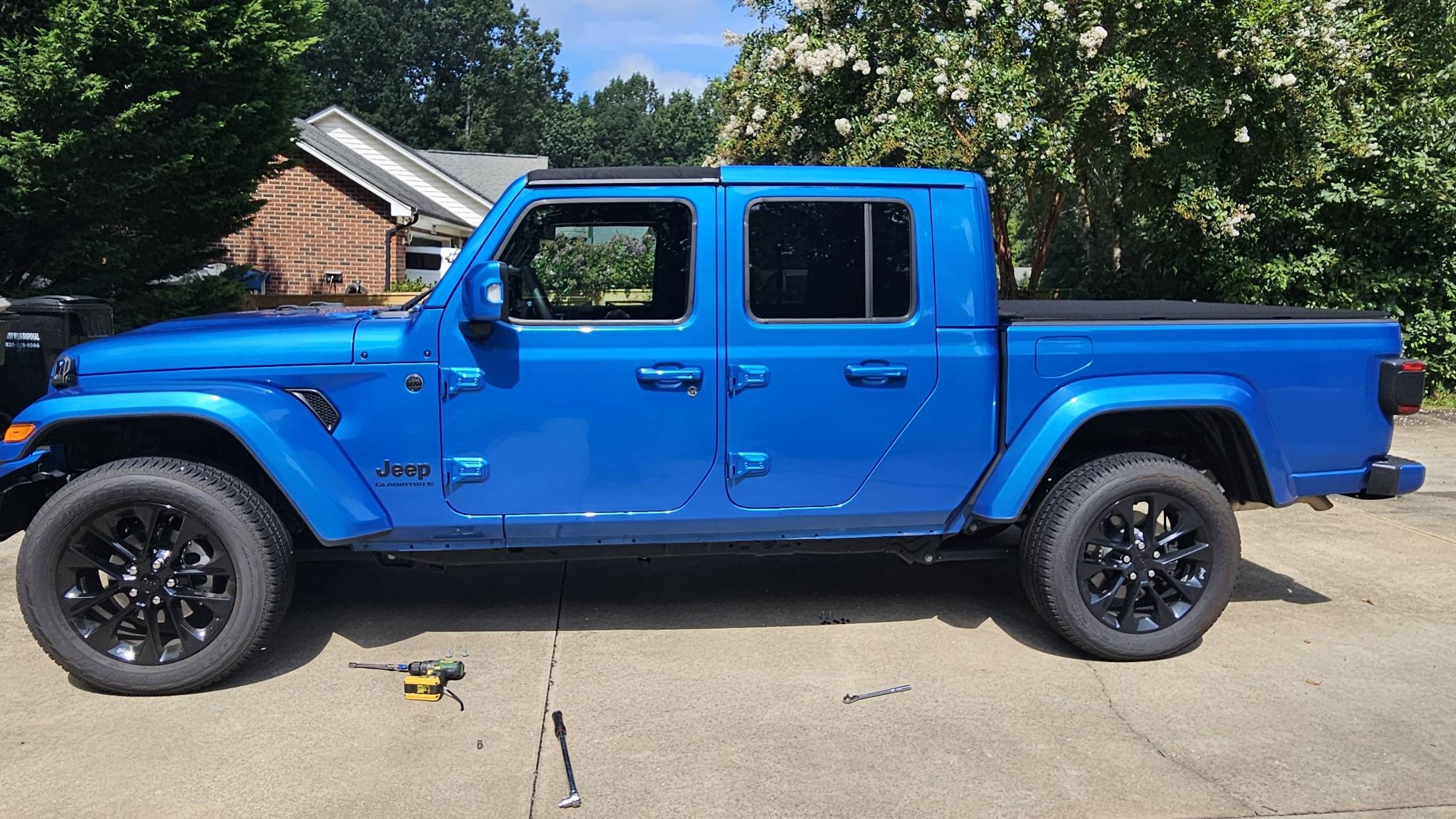

Paid $20 for the take-offs from a Rubicon. Took about 40 minutes total. All hardware is the same for both. I personally think it looks way better and I hate the placement of the steps.
Per Side
8x 10mm bolts @ 10lbs (it is technically 9.3 or 9.7lbs)
4x 13mm bolts @ 20lbs
Once you remove all the bolts the steps just stay in place. Then you just pull them out. Same for the rails, you put them in and they stay in place.

Agreed it looks way better, my Mojave came with side steps as well. I was talking to my brother who has a 20 JTR and a 23 JTRD and he had an extra set of rock rails that he gave me since I gave him the trail rail system out of my 20 sport S when I traded it in. The swap took all of maybe 20 minutes and looks a lot better
