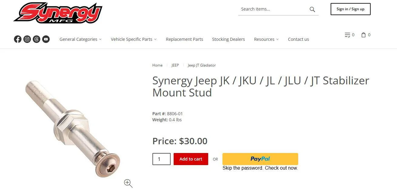

1) Track Bar stud at axle side
Jeep Gladiator high mount for fox 2.0 ts steering stabilizer 1733780540801-

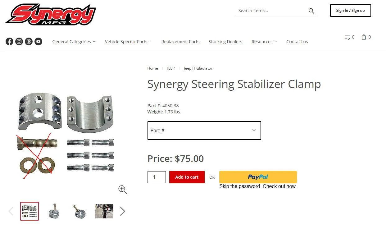

2) Tie Rod Clamp (will not use Synergy supplied bolt for Fox TS, only OEM)
Jeep Gladiator high mount for fox 2.0 ts steering stabilizer 1733781312194-n0

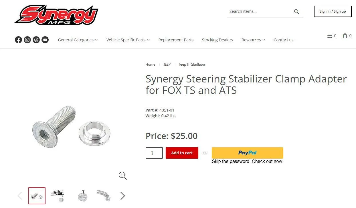

3) Clamp adapter bolt for Fox TS (replaces the Synergy bolt above)
Jeep Gladiator high mount for fox 2.0 ts steering stabilizer 1733781354608-wg
