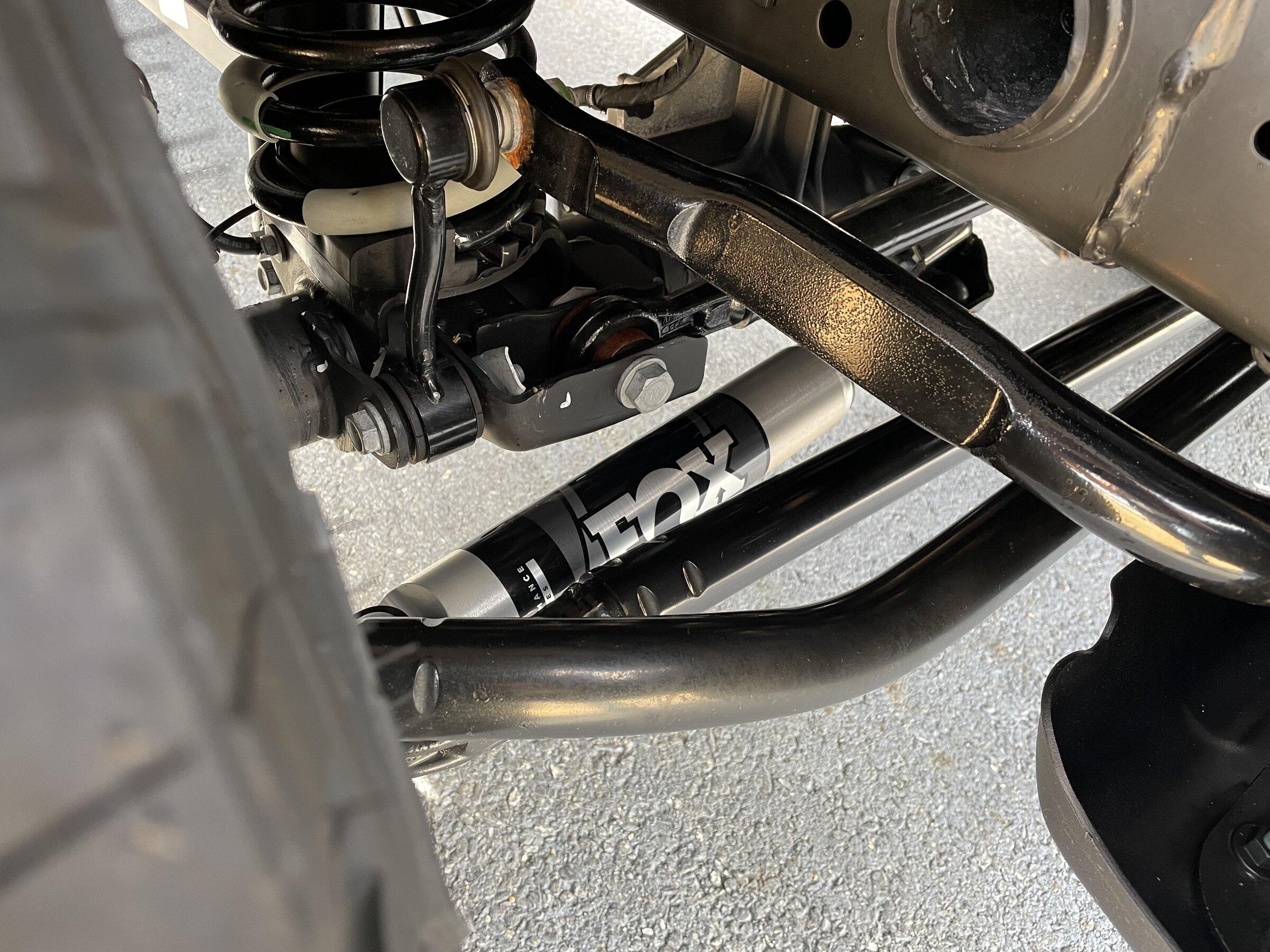

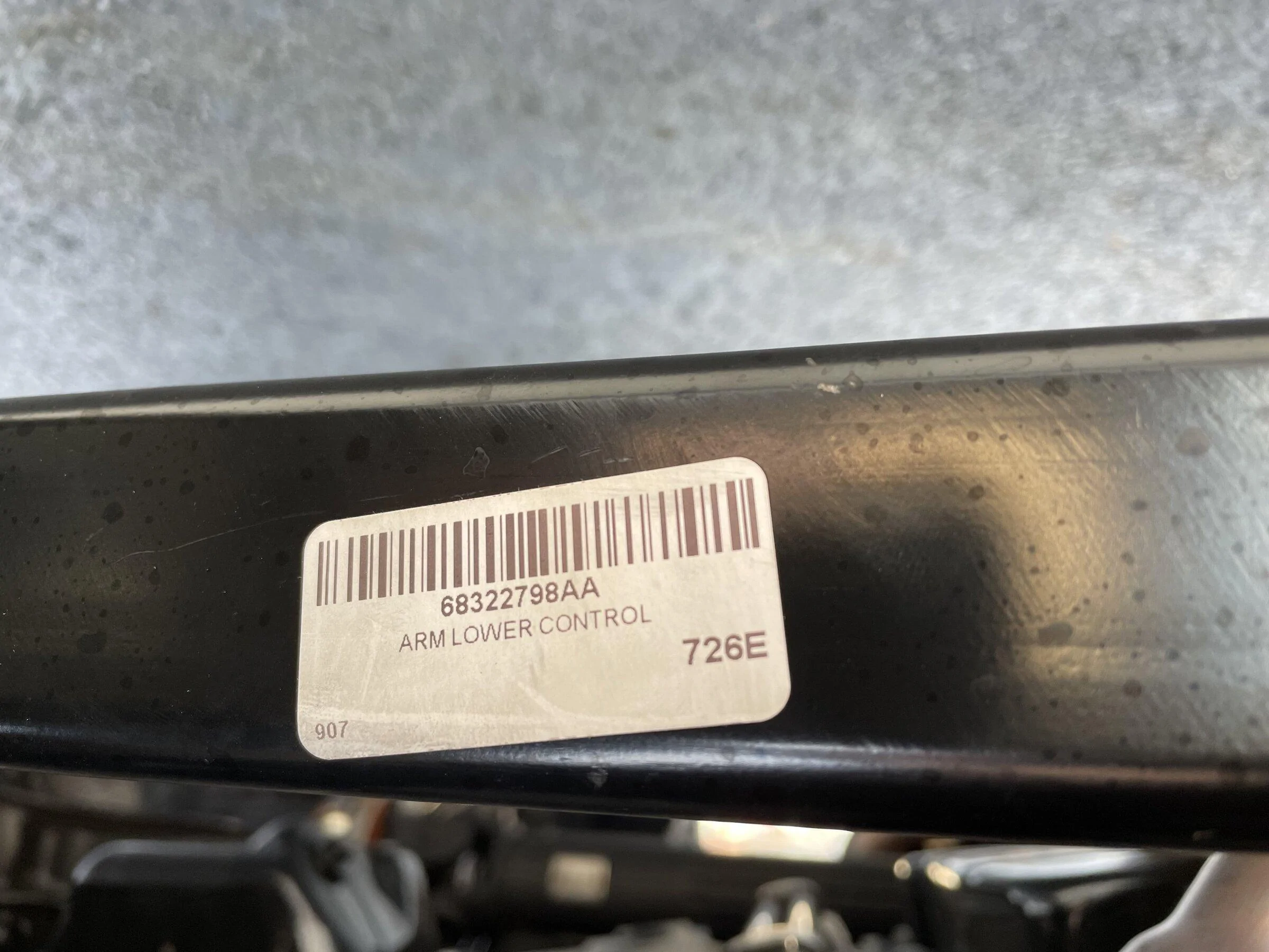

I installed the Fox stabilizer and the lower control arms from the Mopar 2” lift when I installed a teraflex 1” puck up front. Along with an alignment. 21 gas Rubicon. Drives like different vehicle. 1 finger steering at highway speed with no issue. The LCA’s are ever so slightly longer but all that is needed. Gives you a couple degrees caster which along with the stabilizer made a huge difference in my case.

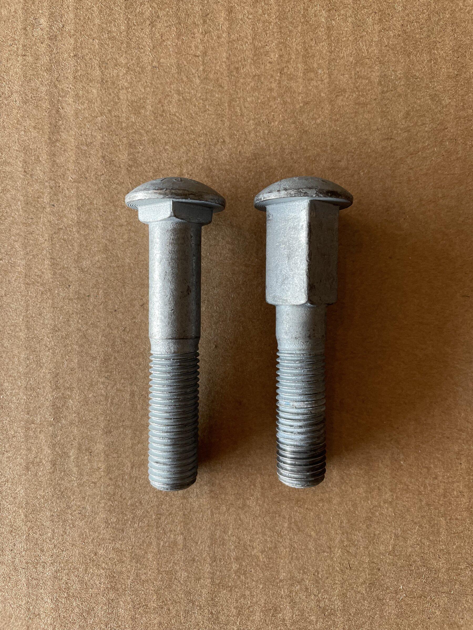

My ‘21 was built Oct 26, my bolt looks to be the old style, no issues here...installed easily.

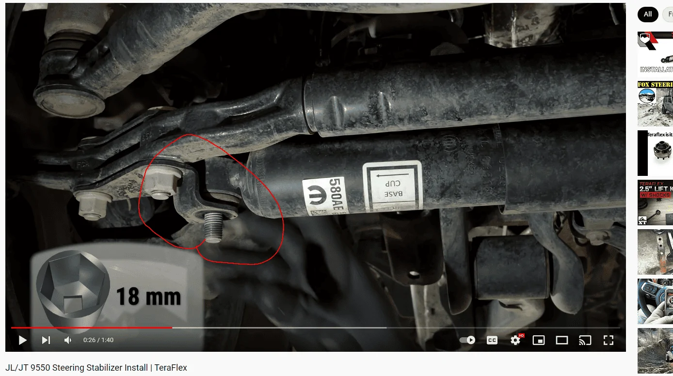

I bought a FOX Steering stablizer Thru-Shaft -- and I cannot get that carriage bolt out after removing the 18mm nut.
How did you manage to get that bolt out?
