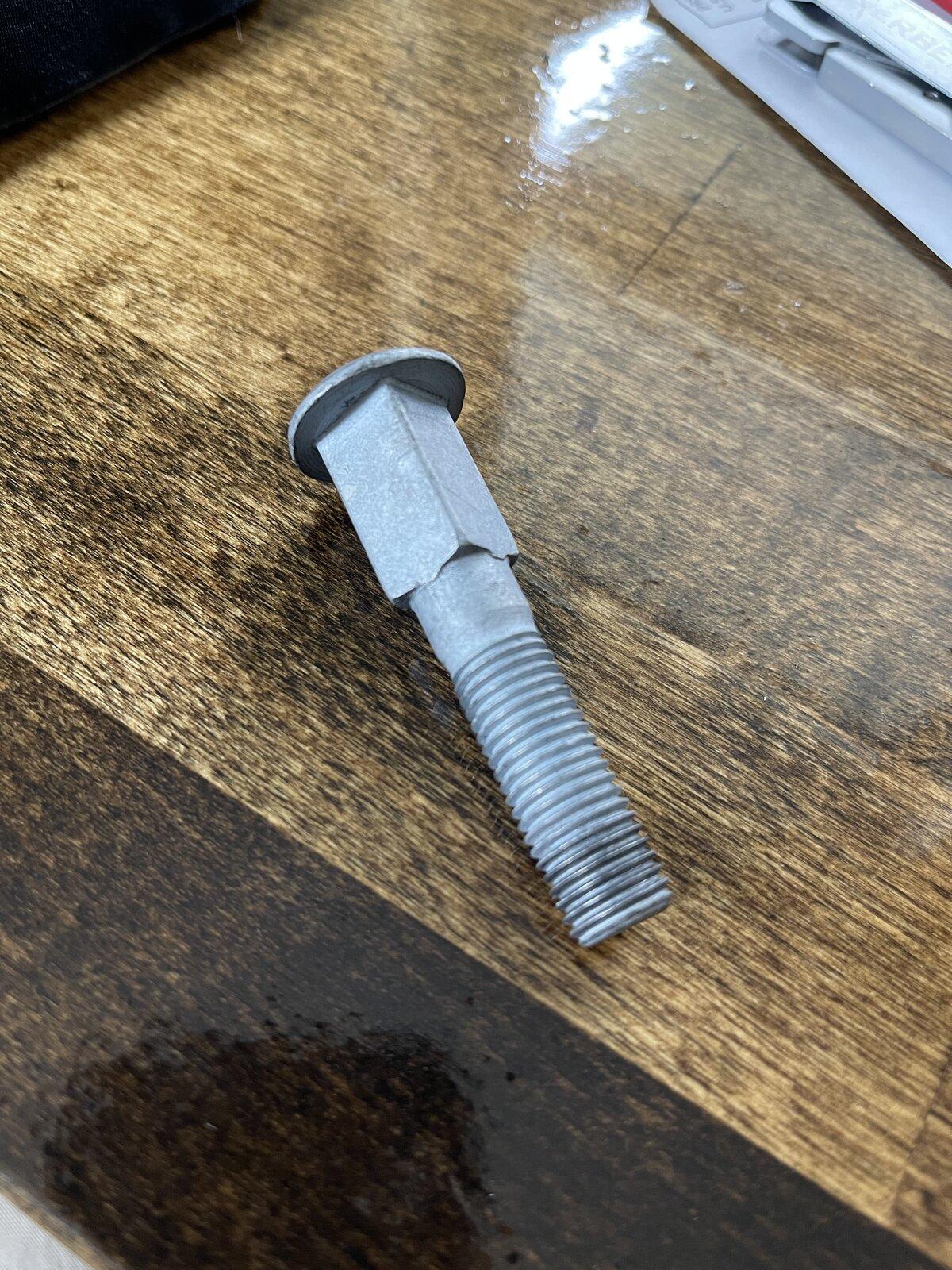

When trying to install fox stabilizer part #985-24-173 on my 2021 gladiator my stock stabilizer has a larger bushing on one side to accommodate the square bolt end that is used to secure it on the wheel side. The new shock does not have this larger bushing so it does not fit. Has anyone else had this issue. Fox says it fits but it clearly doesn’t. Thanks!
I just took a flap wheel to it and rounded most of the carriage shoulder off. Looks just like the alternate OEM bolt shown above.
@Motostew & @freebird_78, what is the build date on your door jam sticker?
What’s the part number of the bolt that is needed from the JL? I’m about to be in this boat I fear...
The older bolt is Mopar #6510774AA.

The earliest Jeep with the new long, square shank bolt, we've found so far is the 1/21 .

Does anyone have a pic of the new one? Pretty sure I have the old style, but it's not clear what the new one actually looks like to confirm. 8/20 build date.

North ridge 4x4 is stating that if you are built after mid year 2021 you need to order a different bolt.

I'm imagining it made assembly slightly faster as the carriage bolts short square section easily pushed up and spun as they were shoving it together. Seems like one of those 6sigma changes where they asked workers for a recommendation and someone said a longer square shank on the carriage bolt and it was like huh thats a no cost change.

Its looks like the change was made so that the steering stabilizer could be only installed in one orientation.

Just ran into this problem… here’s the new bolt
