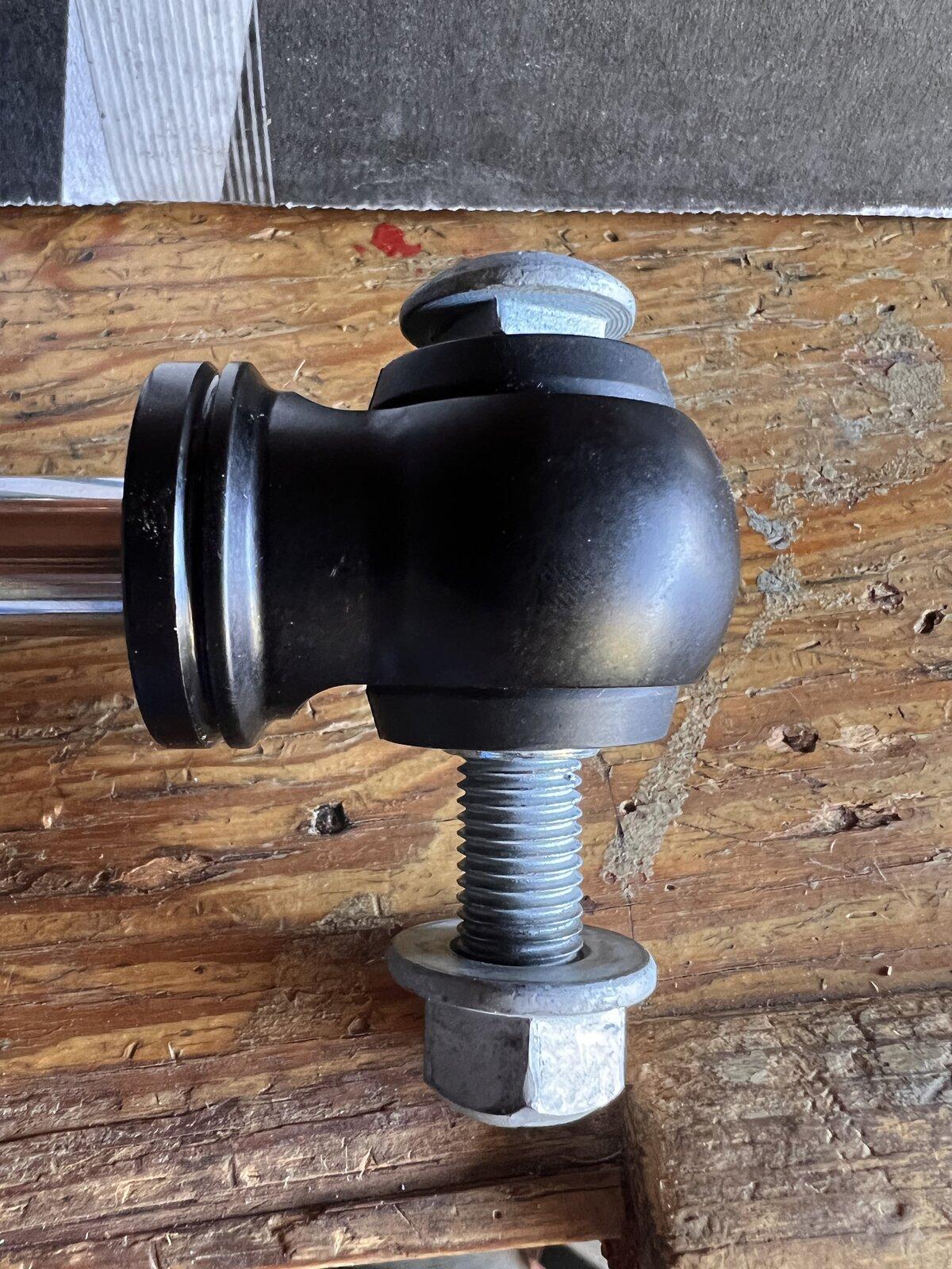

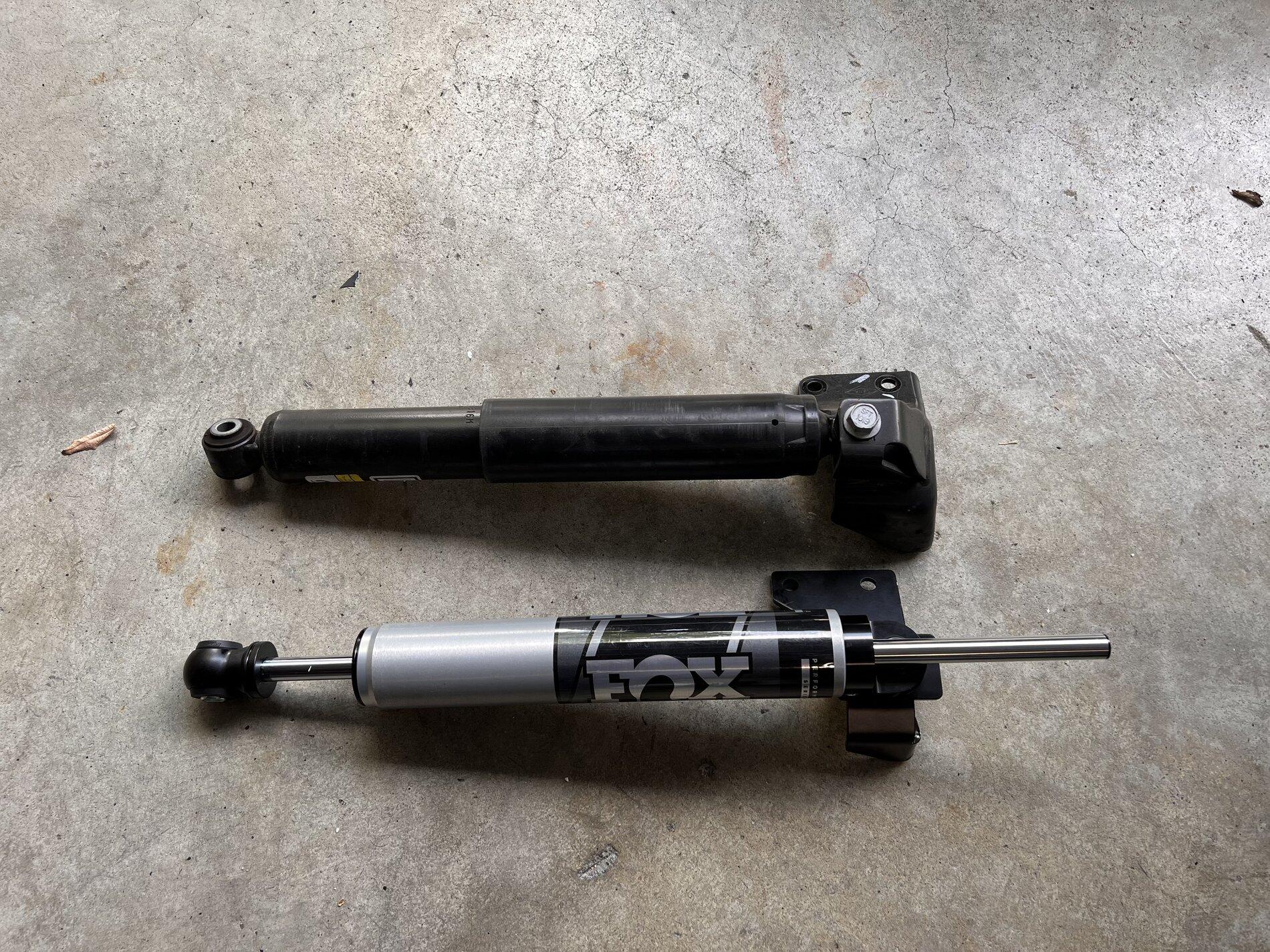

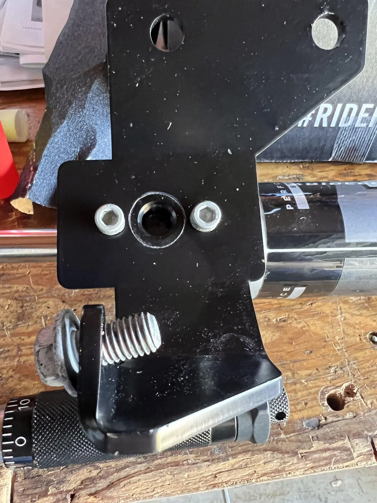

Does anyone know the torque specs for the factory hardware that you reuse on this kit? Specifically the nut for the bolt on the wheel side and the 3 smaller bolts for the bracket?

Went with standard specs of 25 and 45 ft/lbs for small and large respectively.

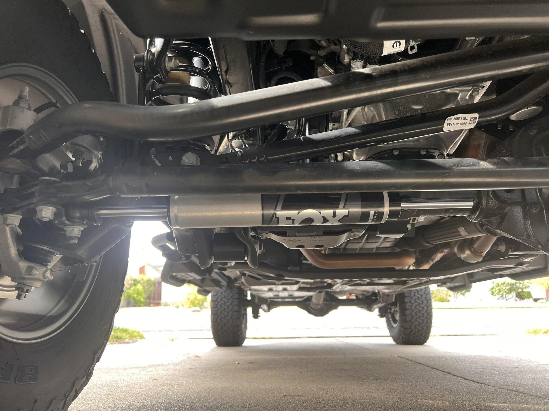

how’s the ride with the TS? i’m looking at that too, thanks

Will give it some more mileage. Initial thoughts are: it’s not night and day difference, but that isn’t necessarily a bad thing. It’s not noticeably stiffer that it makes turning difficult, but it does seem to make freeway driving more pleasant - it seems less drifty and less impacted by bumps at speed, which is exactly what I wanted.
