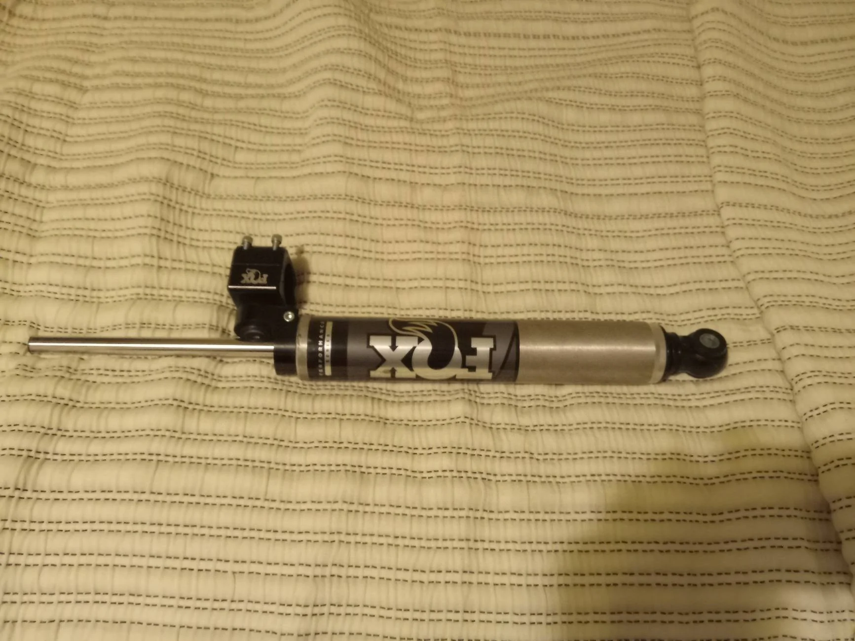

Hello again to all! I attempted to install a Fox Performance Series TS on my 2023 Rubicon tonight. My issue is installing the end that attaches to the bracket on the differential. I am attaching pictures of the stabilizer and you can see what mine has which is the aluminum piece with the 4 Allen head bolts.
When I look up this stabilizer the picture shows a bracket that replaces the stock bracket and the collar for lack of a better word I would need as well.
Do you think that I can buy them from Fox? Does anyone here have one or even a picture of that end installed? Any other place to source?
Also if anyone has directions that they could send in a pm I would appreciate it. That might show what is included with a diagram so I will know what to ask for. I got this from a member here so time back but maybe didn't get all that I needed.
Thanks for you help-Bill

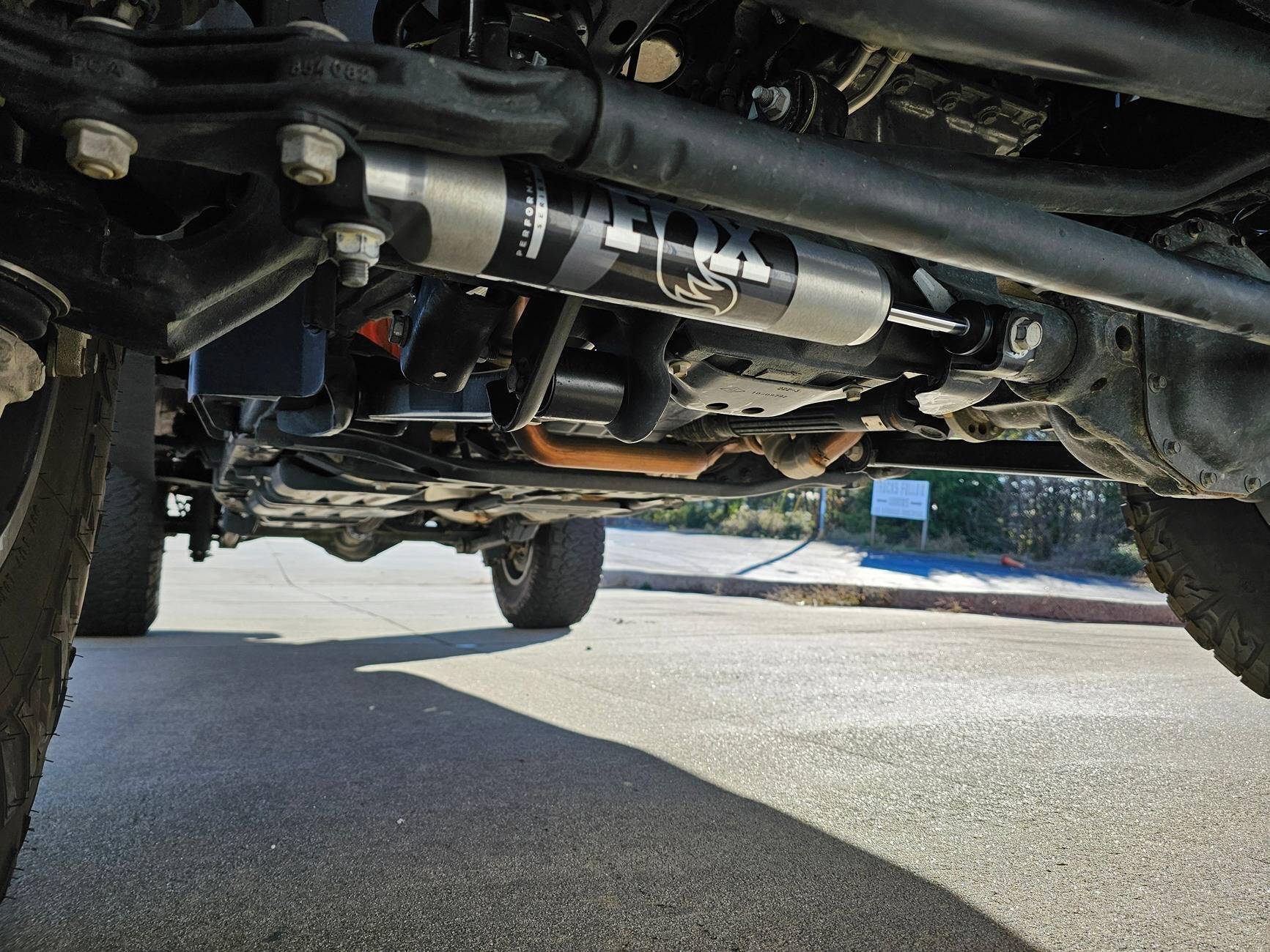

I believe what you have is to mount like this and not on the diff. It locates it higher so it is not as vulnerable to rocks.

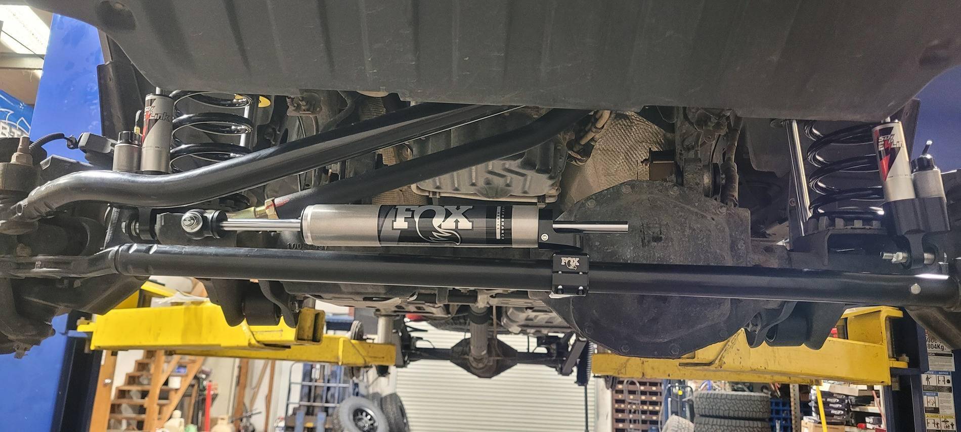

Thank you! The member that I got it from had a Mojave and took it off prior to trading. On the top picture that is exactly what I have. If I am correct by the previous reply I would need to buy the parts needed to install or relocate.
I called Fox Suspension and the gave me the part numbers for an adapter, bracket and two fasteners or bolt. I purchased all for like 64.00 which included 15.00 for shipping.
I may later relocate as in the top picture. Does it make any difference how it drives any either position for better or worse?
Thank you again for your help!

Assuming you bought the diff mount bracket, you will have to remove the existing tie rod mount. That bolt is in there tight with red loctite. So, use a quality hex wrench and some muscle. It will break loose. Heat is not an option because of the o-rings in there.
I don't believe it makes any difference other than better location. I have an after market tie rod, so I had to go with the other bracket and high mount.
