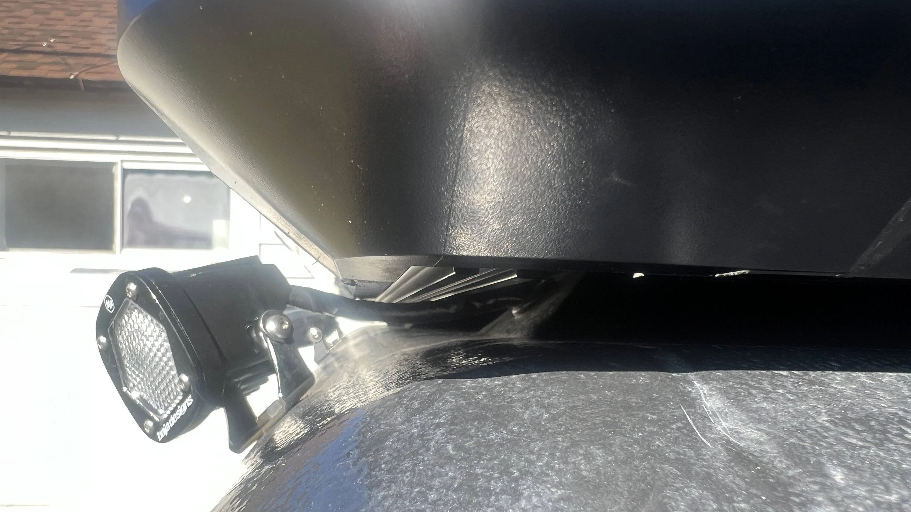

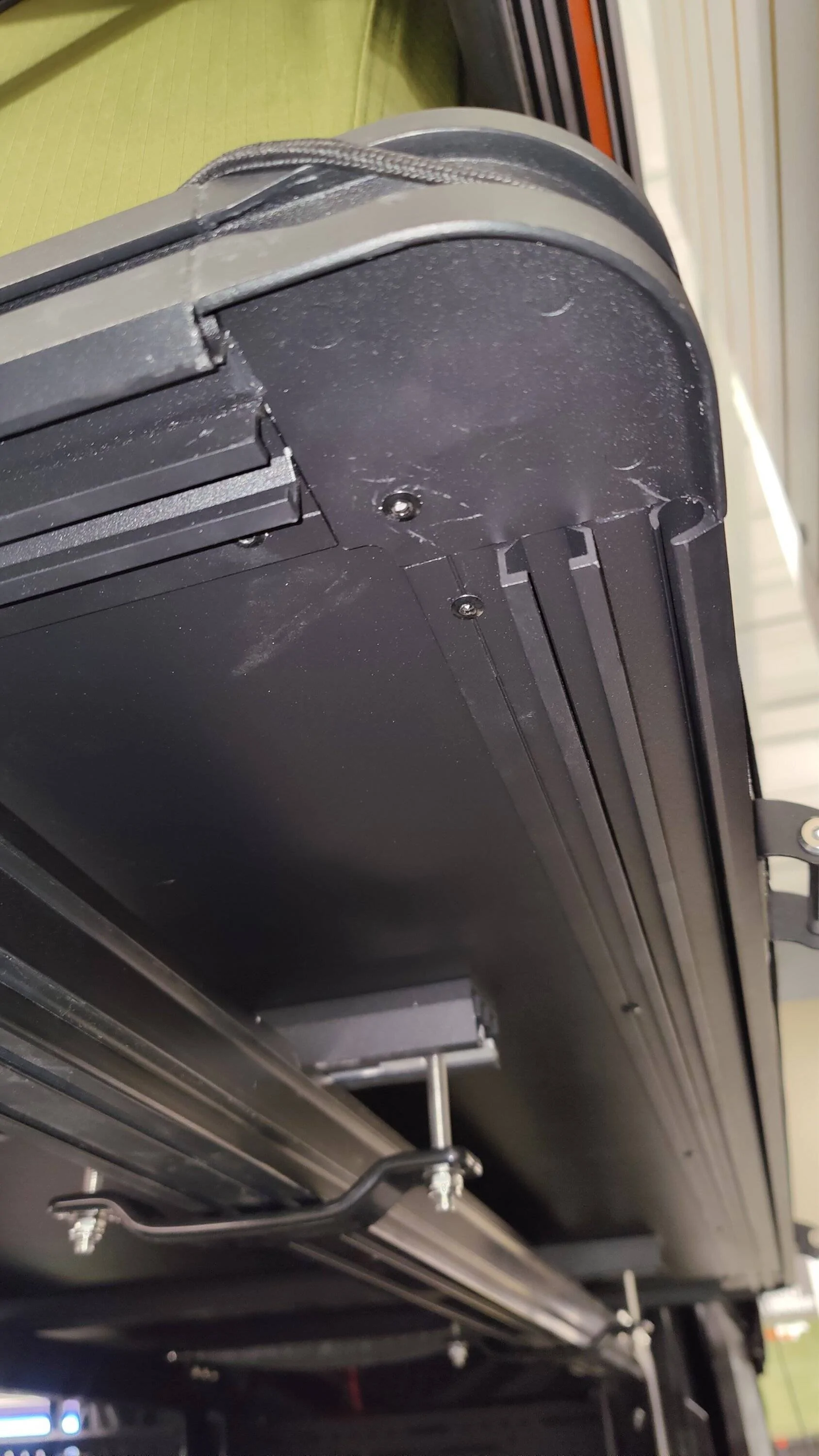

This is really cool because it has allowed me to mount my awning and shower cube directly to the tent, and the tent then is bolted directly to the canopy (my canopy does not accept cross bars). Here is a photo of a prototype bracket I am talking about.
Jeep Gladiator honeycomb aluminum in base and roof of RTT's IMG_2409

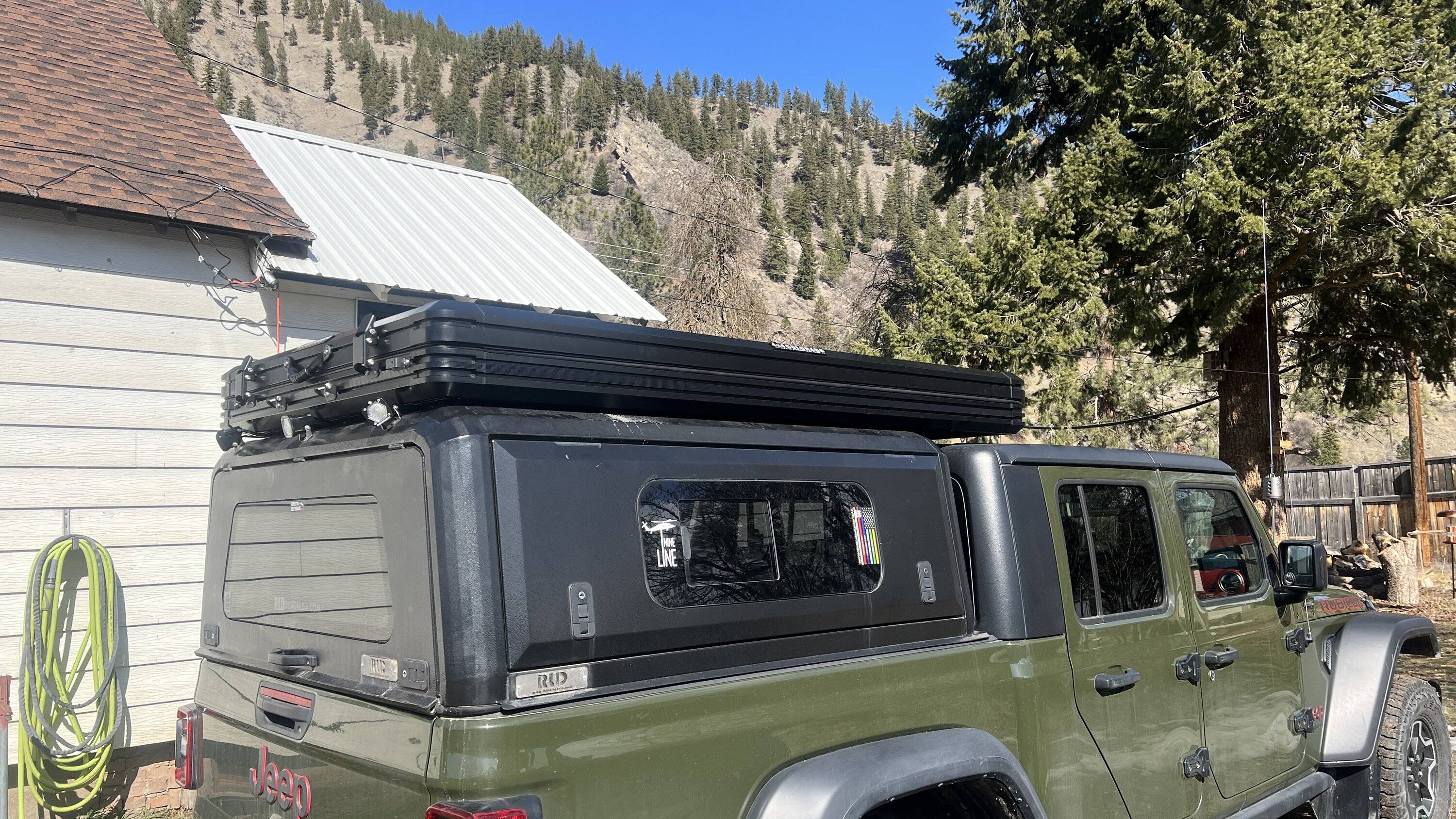

So bracket bolts to the tent, and awning to the bracket. Pretty sweet really. And here is a photo to give an idea how the tent is bolted to the canopy. My canopy is stainless steel (supposedly) so I think it's pretty darn strong, and has the highest dynamic load rating of any canopy at the moment.
Jeep Gladiator honeycomb aluminum in base and roof of RTT's IMG_0190
Jeep Gladiator honeycomb aluminum in base and roof of RTT's IMG_0191

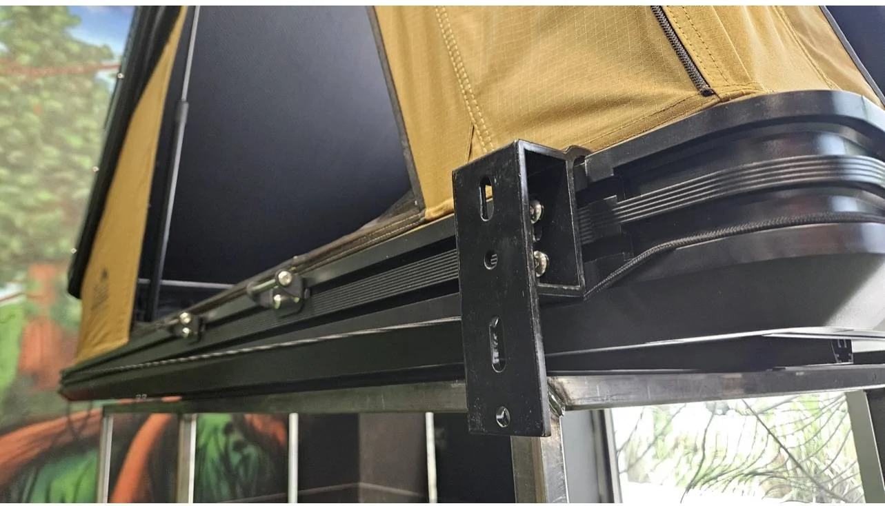

However, the new tent I am considering only has 1 T slot, not 2. So it's more like a 1540 series extrusion. The base is basically the same, honeycomb aluminum riveted together to the extrusion edges and corners. Here is a photo that the company sent me by request.
Jeep Gladiator honeycomb aluminum in base and roof of RTT's IMG20231128145159
So.....I need to find a way to make the new tent work with the awning/shower cube. If you reference the prototype bracket, the hole mounting is I think 4" apart (standard) for the awning, and 2 or 3" (standard) for the shower cube. It appears the base structure of the new tent is not as robust. And if you look super close you can see where it is sealed for water intrusion and where it is riveted. Surprisingly the honeycomb base only goes into the extrusion what looks to be 1 or maybe 1.5 inches. Kinda surprising... So to make this new tent work, I need to probably have a custom bracket made. There is a shop in town willing to do that. But I would like ideas on what will work. A standard L bracket with braces? Or maybe a C style clamp with a bolt that goes through the extrusion and a flat 4" face for the awning to mount to? Or maybe some hybrid system where it also bolts into the canopy (I would prefer not to drill more holes in the canopy, but not the end of the world either). Any metallurgy guys or gals here? Any fabricators who know how to work with aluminum have any ideas?
