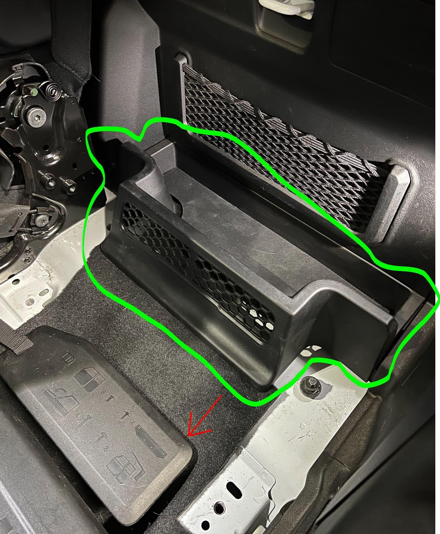

How do you remove this bask thingamajig from behind the 40% rear seat (besides the two nuts I already removed)? Trying to make room for a fridge platform! Please help.

I believe it’s screwed into the main back wall. But I could be mistaken. Screwed in from the back side that is…

It's hard to tell from the picture, but it looks like it is molded into the back panel. If not, the back panel may need to be removed to get it out.

The back panel clips into it. Should be possible to get a trim tool under the back panel, pop it off and just wrestle it out. Its only held in with little plastic clips, not the obnoxious metal ones at the top of the panel which are almost impossible to get out without breaking something.....

Got it out but had to remove the 60% seat and loosen the back panel. Sadly the back panel cracked trying to loosen it. Probably should have just yanked the basket a little harder. It came right out with a crowbar. ;)

Rip shit up, then anything leftover just cut it off.
Also there's a pretty useful option that (I think) goes in that same spot to hold all your loose bolts from top or door removal etc.
