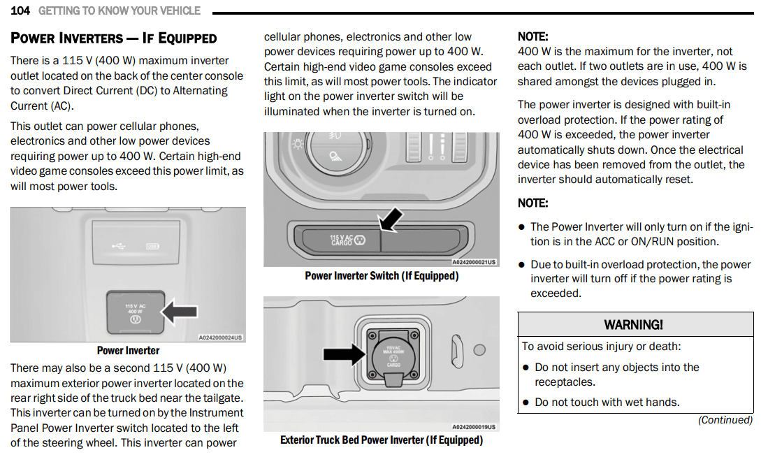

Hi all, I'm getting ready to order a Mojave and have a question on how the inverter functions.
I'm trying to decide if I want to spend the money to get the plug in the bed.
Does the key have to remain on for the inverter to run?
Will it run in accessory mode? If yes, how long before it powers down?
Is there another way to power it up without having a key?
Will it automatically shut down when battery voltage drops below a certain level?
Thanks,

It will run in accessory mode.

Don, a lot of questions can be easily answered by downloading a copy of the owner's manual.
Also, the ACC will shut down after something like 20-30 minutes to prevent killing the batteries. There's a thread here somewhere about that in relation to using the radio at a drive-in movie.
Jeep Gladiator How does / how long does 120v inverter stay powered up? 1634535238501

Thanks.
Great point. I'll download it today.
