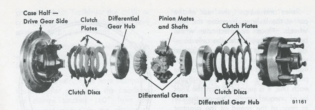

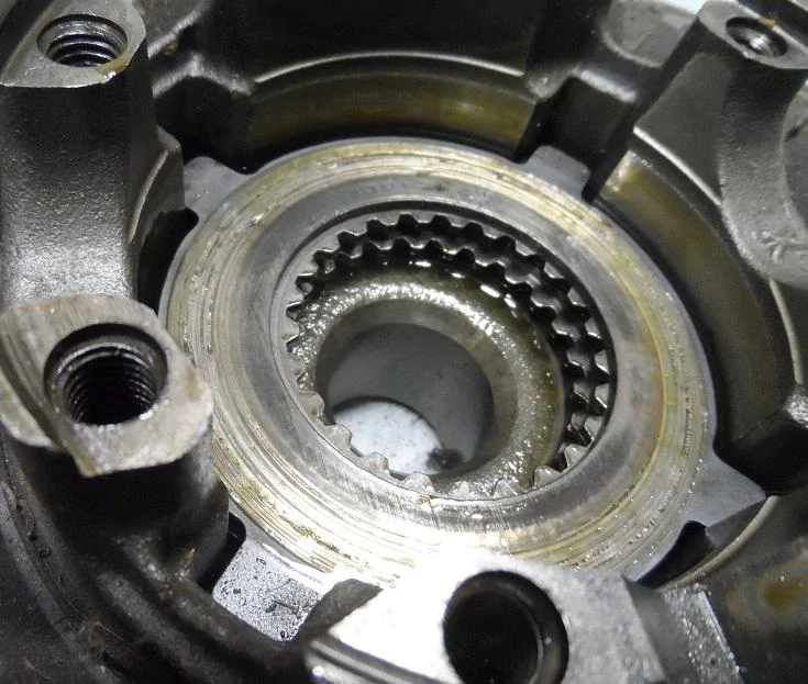

Jeep Gladiator How does BLD work? How do I actuate it? posi-plates_2015
Jeep Gladiator How does BLD work? How do I actuate it? posi-plates_2011
This is one style - some use cones, some use variations on the clutch packs or even additional carrier gears.

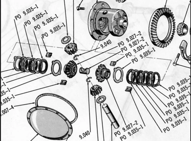

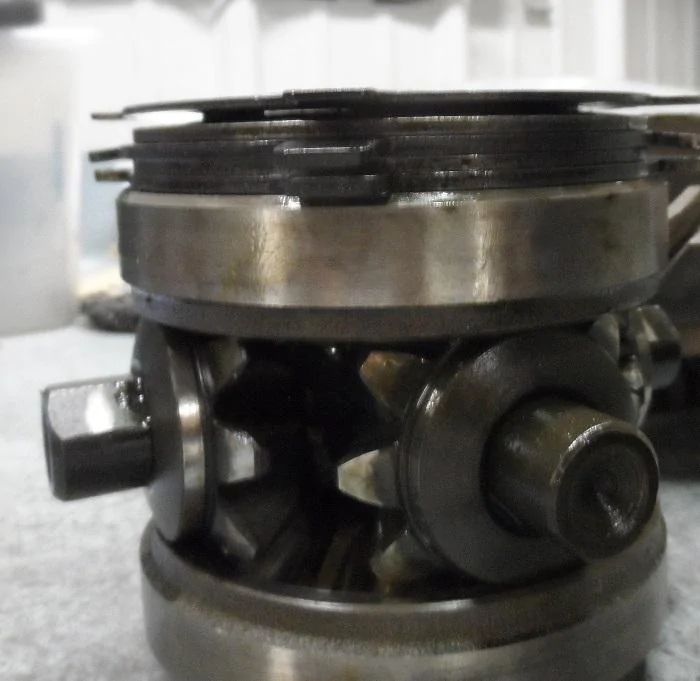

Jeep Gladiator How does BLD work? How do I actuate it? 1655334452821
Jeep Gladiator How does BLD work? How do I actuate it? 1655334507794

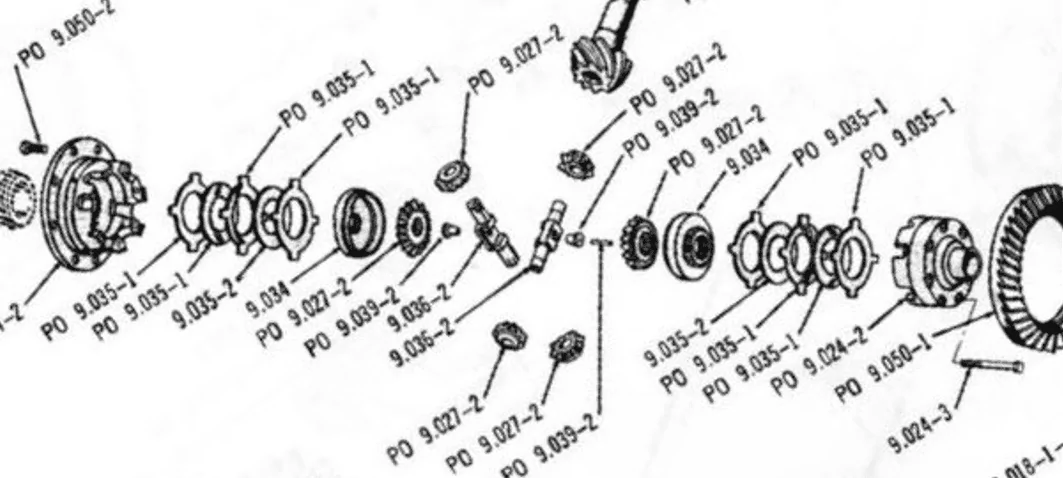

And another variation -
Jeep Gladiator How does BLD work? How do I actuate it? 1655334576471
