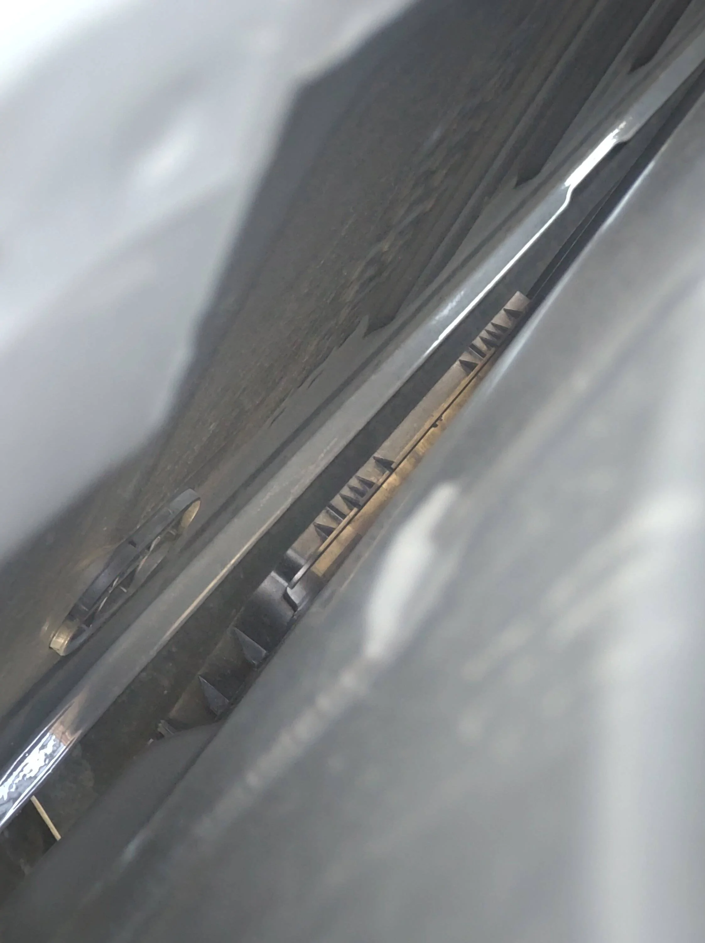

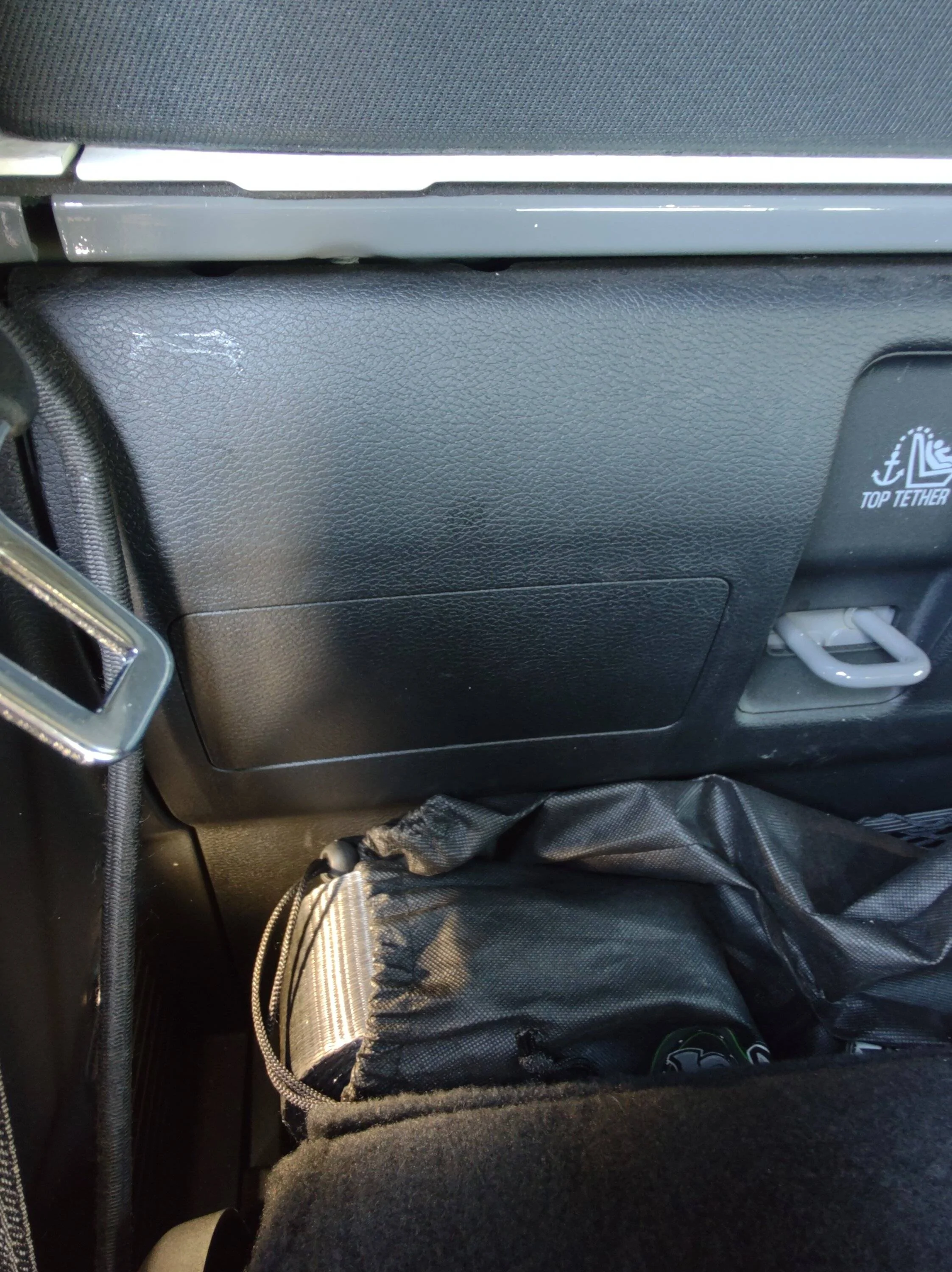

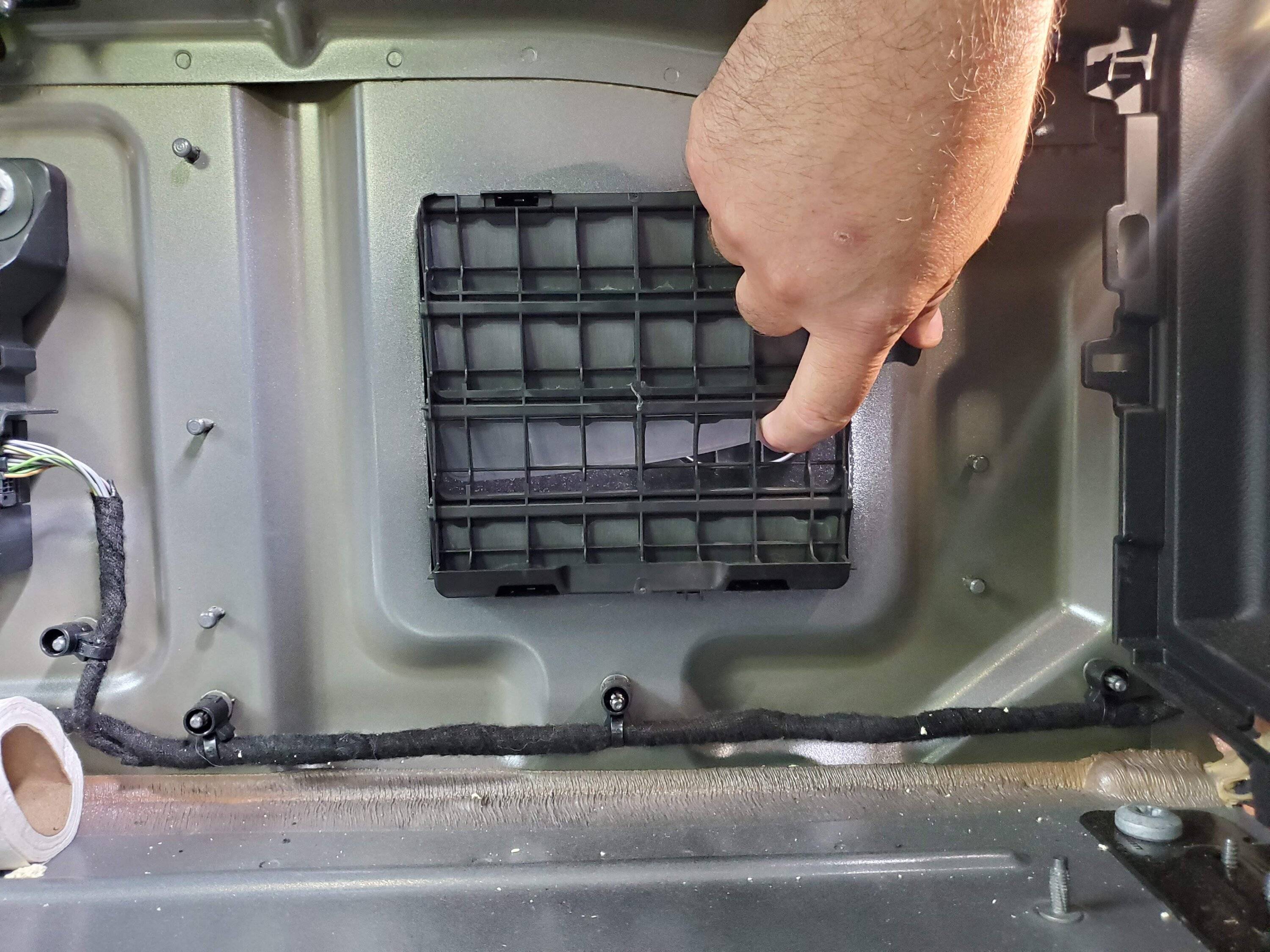

So I finally bought a backup camera/rearview mirror set-up. Trying to figure out the wiring from camper to cab. Has anyone used this spot? It looks like that little plastic cover if almost directly on the other side of the interior cover. I've got a camper so I was thinking about the bed drain down up between the cab and then into cab. it is a little higher up than the floor drain plug. Anyone?
I would not recommend using that vent. That is the pressure release for the cabin and it has flaps that open up when you slam the doors.
Any cabling you run through there will likely allow moisture to enter the cab. I suppose you could just remove that one flap and seal the whole thing up, but I don't know how good an idea that is...
The other issue is getting that back plastic wall off. I took mine out to build my seat deletes and I destroyed it. those clips suck..
