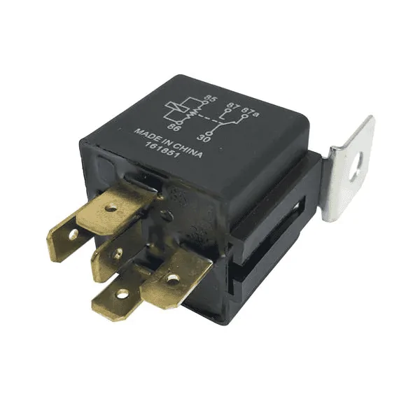

Just a standard 5 pin 12v relay. You can either use female ends and connect directly to the relay, or get a pigtail.
It's been a while but I believe you would run the backlight power off 87A, normally closed, and when the relay is fed the trigger from the AUX switch being pressed it moves the power source inside the relay from 87A to 87, cutting the power supply to the backlight.

One possible way would be...
30 - Fused 12V source for power
87A - backlight wire
87 - main light wire
85 - ground
86 - 12V input from Aux switch
