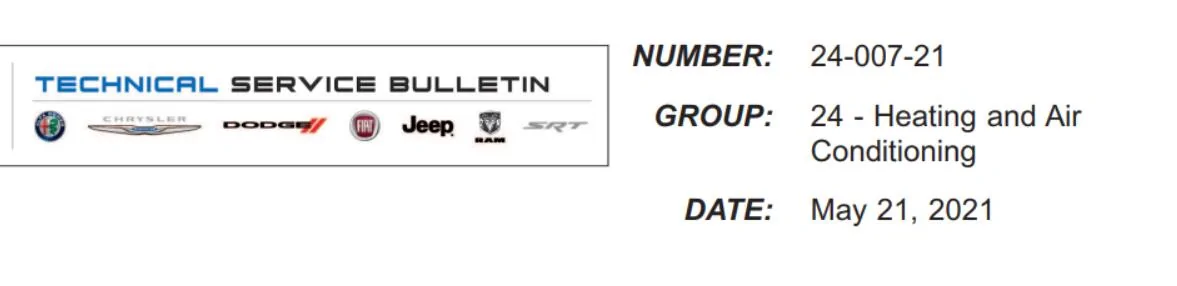

The dealer is totally lost if they thought a heater core flush would resolve anything other than a plain lack of heat inside due to a plugged or restricted core - which is extremely unlikely in a vehicle only 4-5 years old!
The 2020 and 2021 have a TSB (technical service bulletin) related to similar HVAC issues.
Jeep Gladiator HVAC Issue 1743450925986-ht
Don't let that dealer replace a bunch of parts like that!
Have they checked for any DTCs (codes indicating a problem that won't necessarily trigger the check engine light) ?
There's a whole procedure for them to follow to check operation of these things - a multiple page process. They need to actually follow that and stop throwing things at it to see what works.
