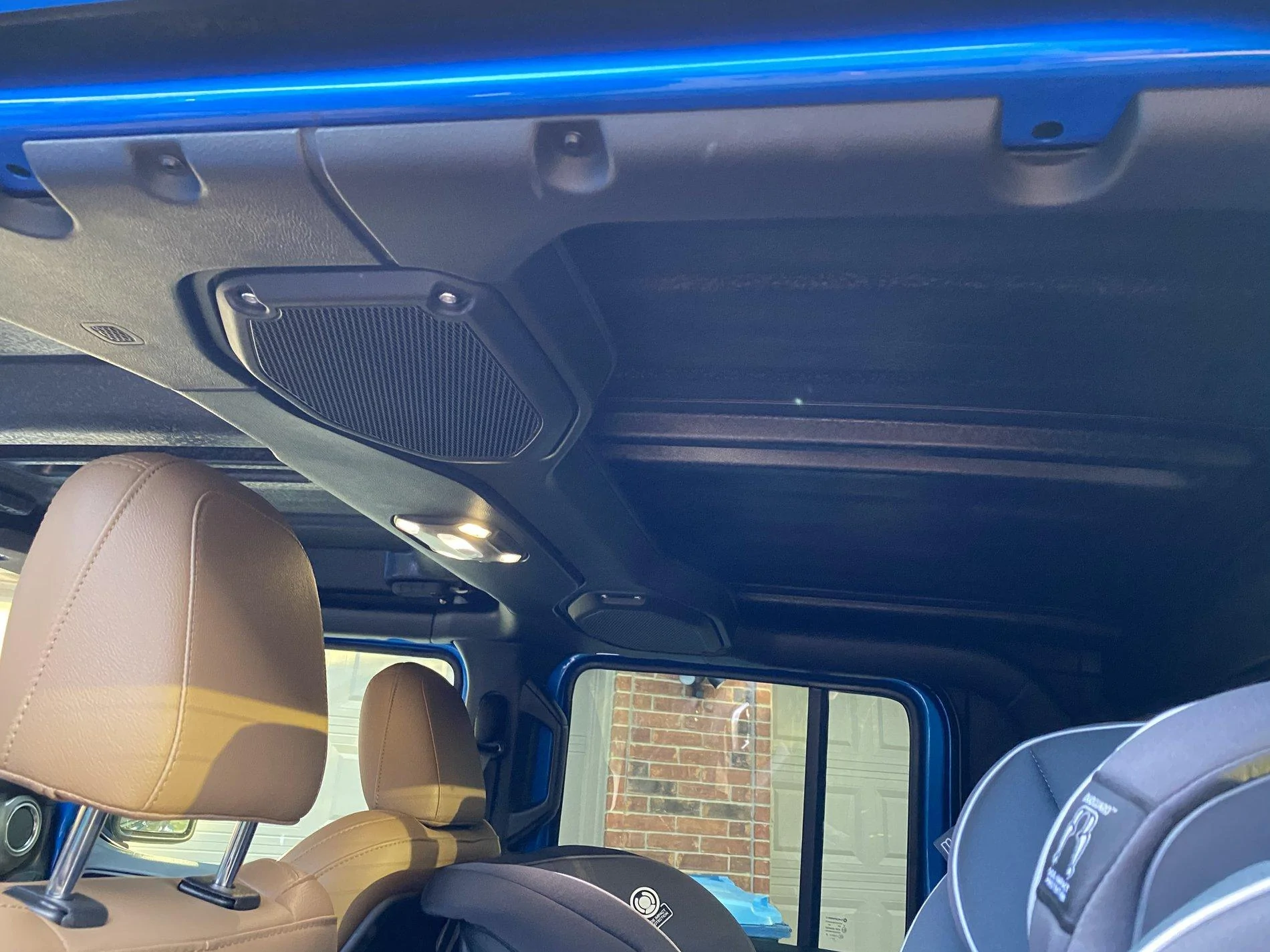

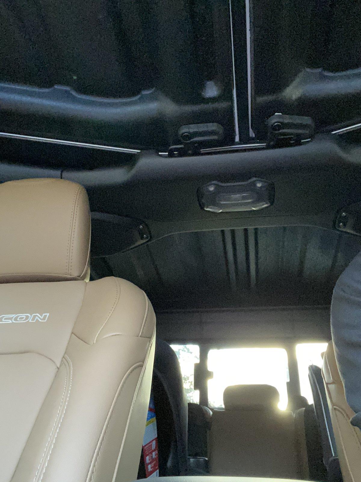

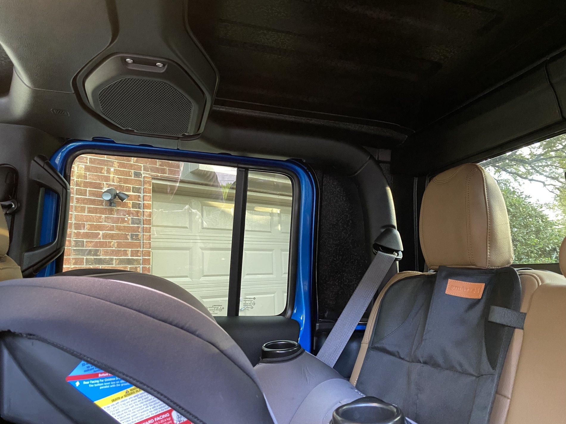

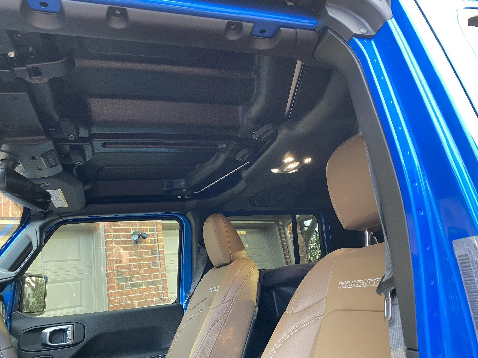

Forgot, the cheapest thing that I have done and but thought made the biggest impact, second to the performance mods (exhaust and CAI) is Plasti-dipping the headliner!!
I can't believe that Jeep charges 2k for color-coded hard-top, then leaves the underside unpainted white for every exterior color.
I went tan seats so that I could minimize the red inside (binary choice and didn't want red dash), but only thing on my jeep that wasn't Hydro Blue or Black was the damn white roof.
Plasti-dipped in an afternoon. Turned out spectacularly for under $20 (dealership was going to have rhino liner guy do it for $500!). All i did was tape it out and take off the hardware (just taped the window-knowing that it would likely peel off anyway, but this thing is BRAND new!).
Had lots of people look at it and say, wow....if you didn't tell me that you DIY'd....i would have just assumed it came factory that way. Really hard to screw up. BIG UPSIDE if you hate staring at the white!

Photos are hard to tell. I think it was cool that with lots of light coats, it even kept the subtle pattern that you see in the original untouched white top

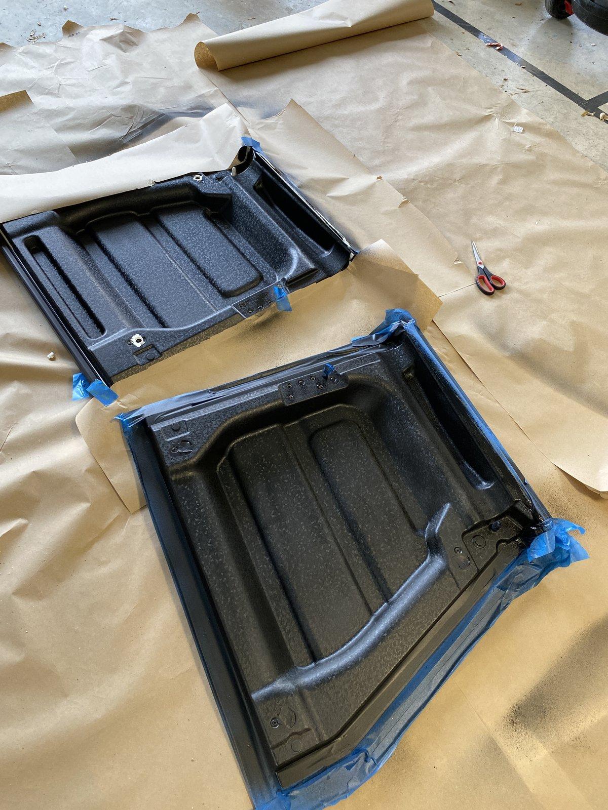

I'd like details on how you accomplished this with top on, or did you remove it?
Now that I've seen it, I'd like to see about changing mine - seeing it on your blue.

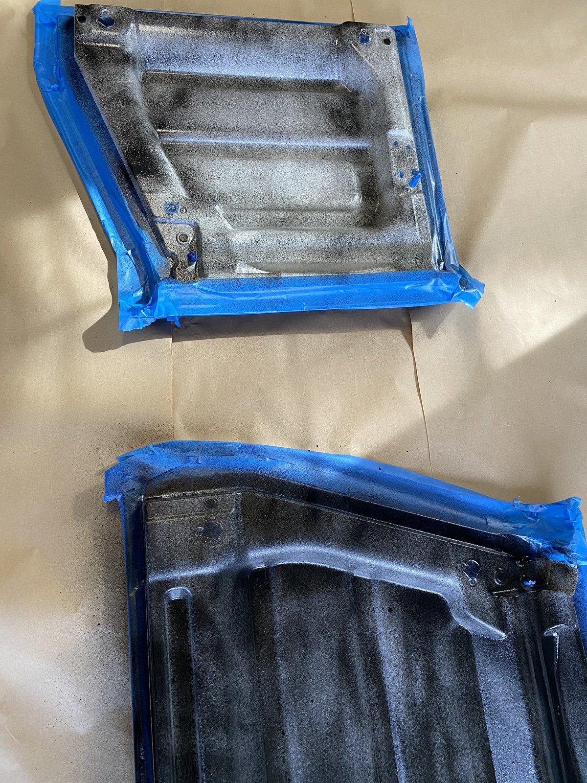

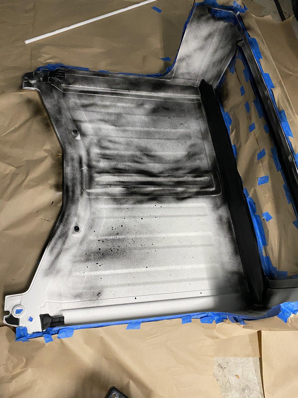

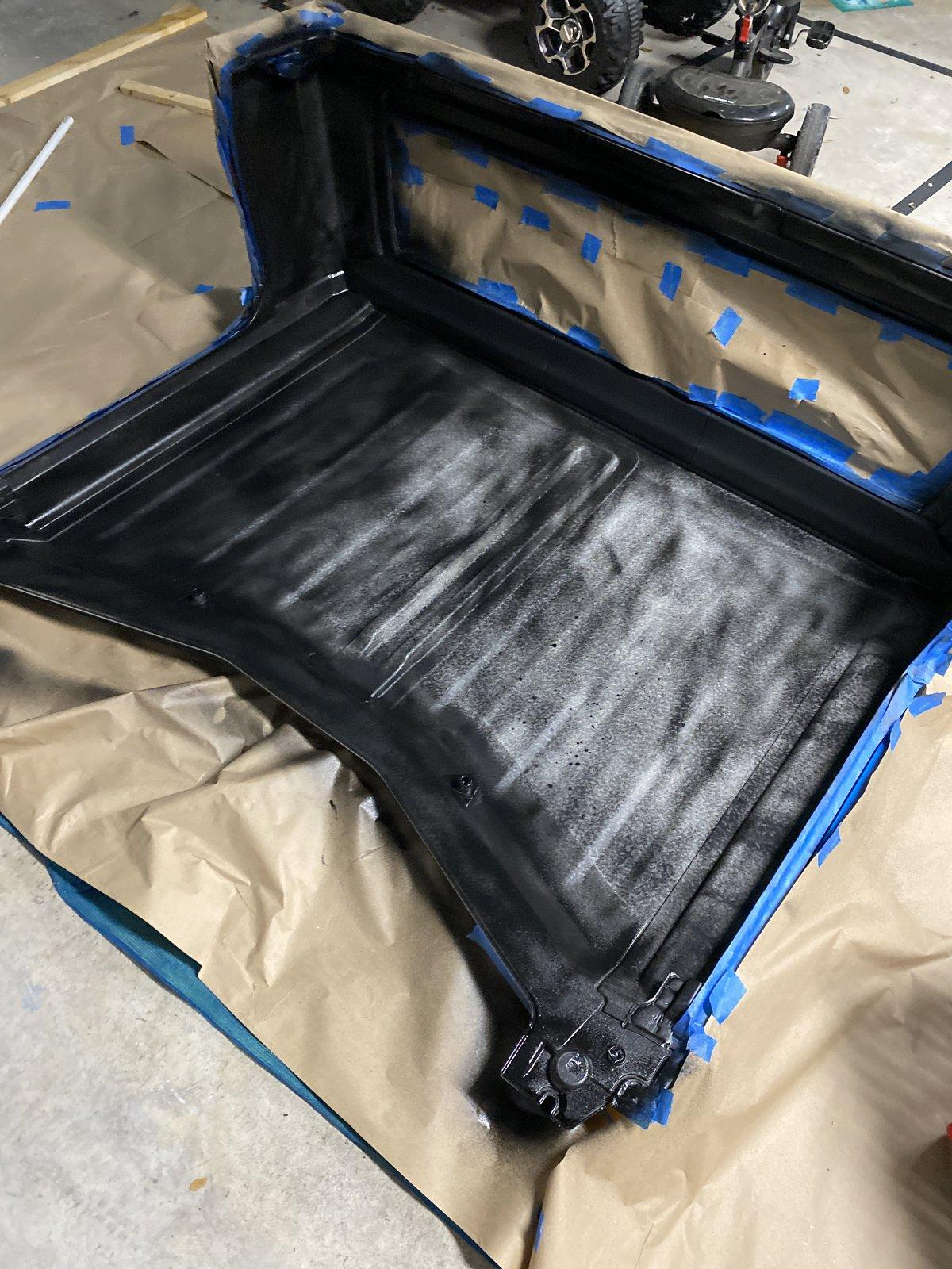

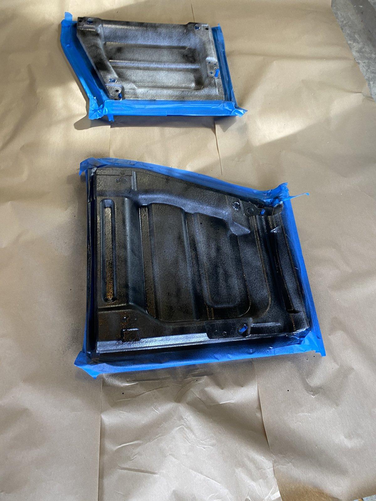

Yes, I took them off and taped them (not sure if necessary). Was easy. I sprayed really light coats, just like spraying emblems or spray painting. It dries quickly. I did it all in an evening and next morning. I think it took about 3-4 total cans.
Hope that this helps!
Yup - sure does! Absolutely. I definitely have to think of this now........ but of course, I have to ask my wife her color preference. She's the reason I have matching blue hard top and fenders LOL.
If it's something I could get and mix up and spray with one of my guns, either the touch up gun or one of the other, I'd consider that as well but then that leads to more stuff to clean...... ok, likely will stick to cans.
Wasn't sure I'd like it until I saw the pics, then I thought, hmmmm, this is worth investigating. She may insist on blue.

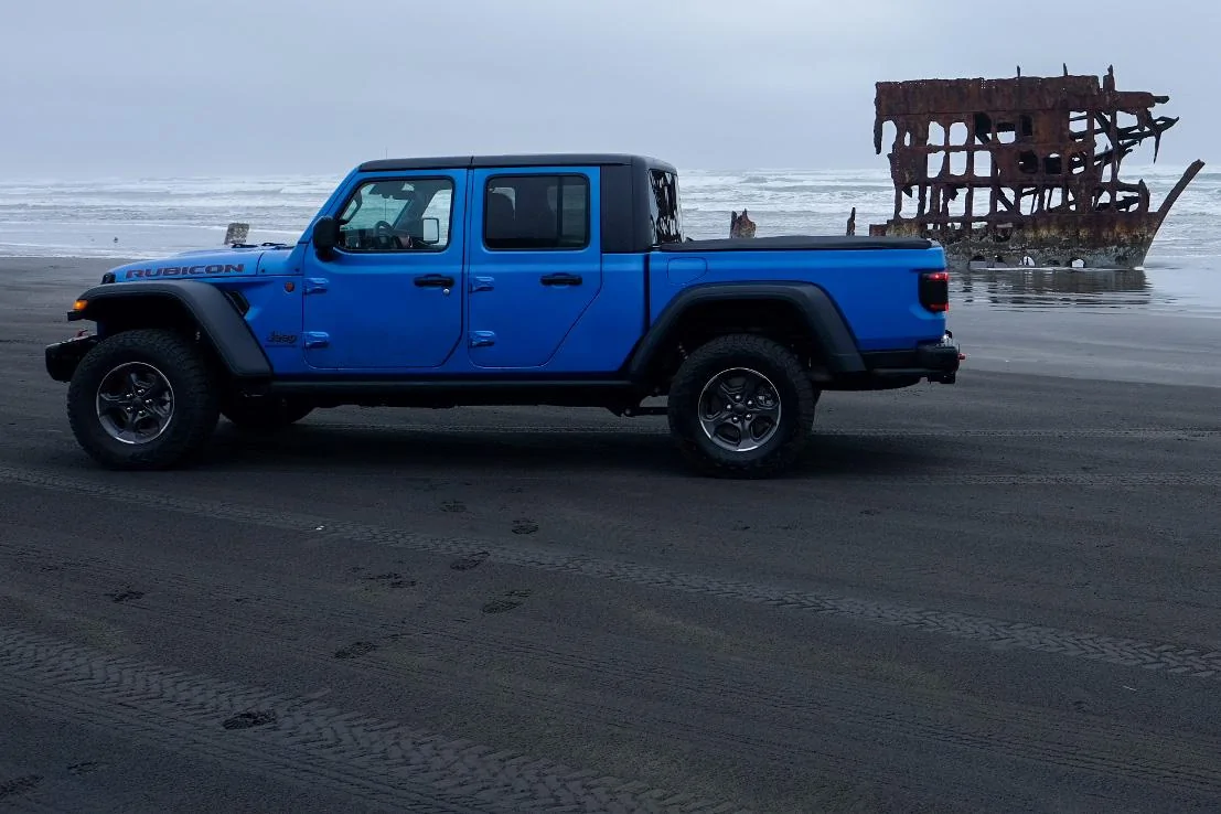

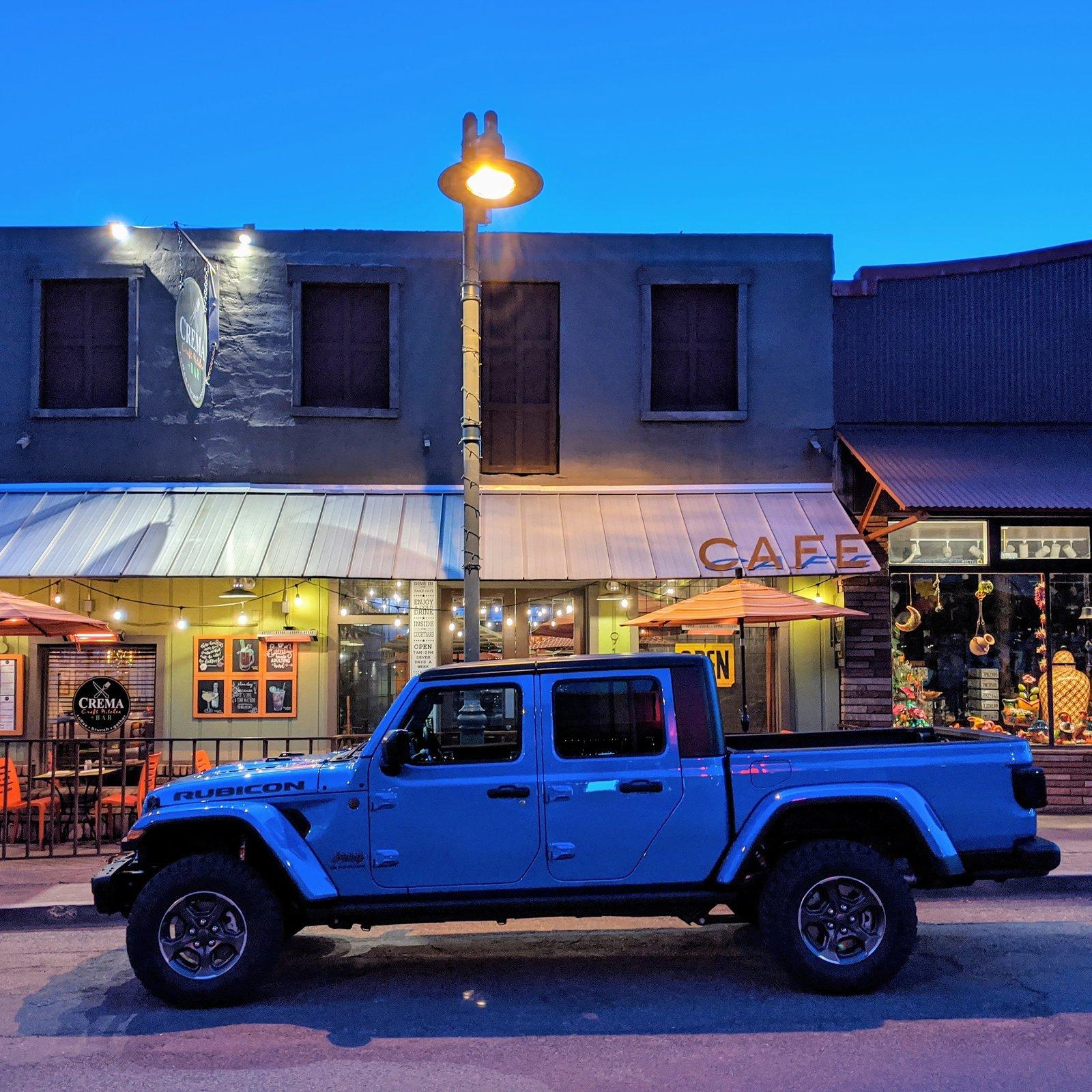

An early morning stop for coffee and sustenance.

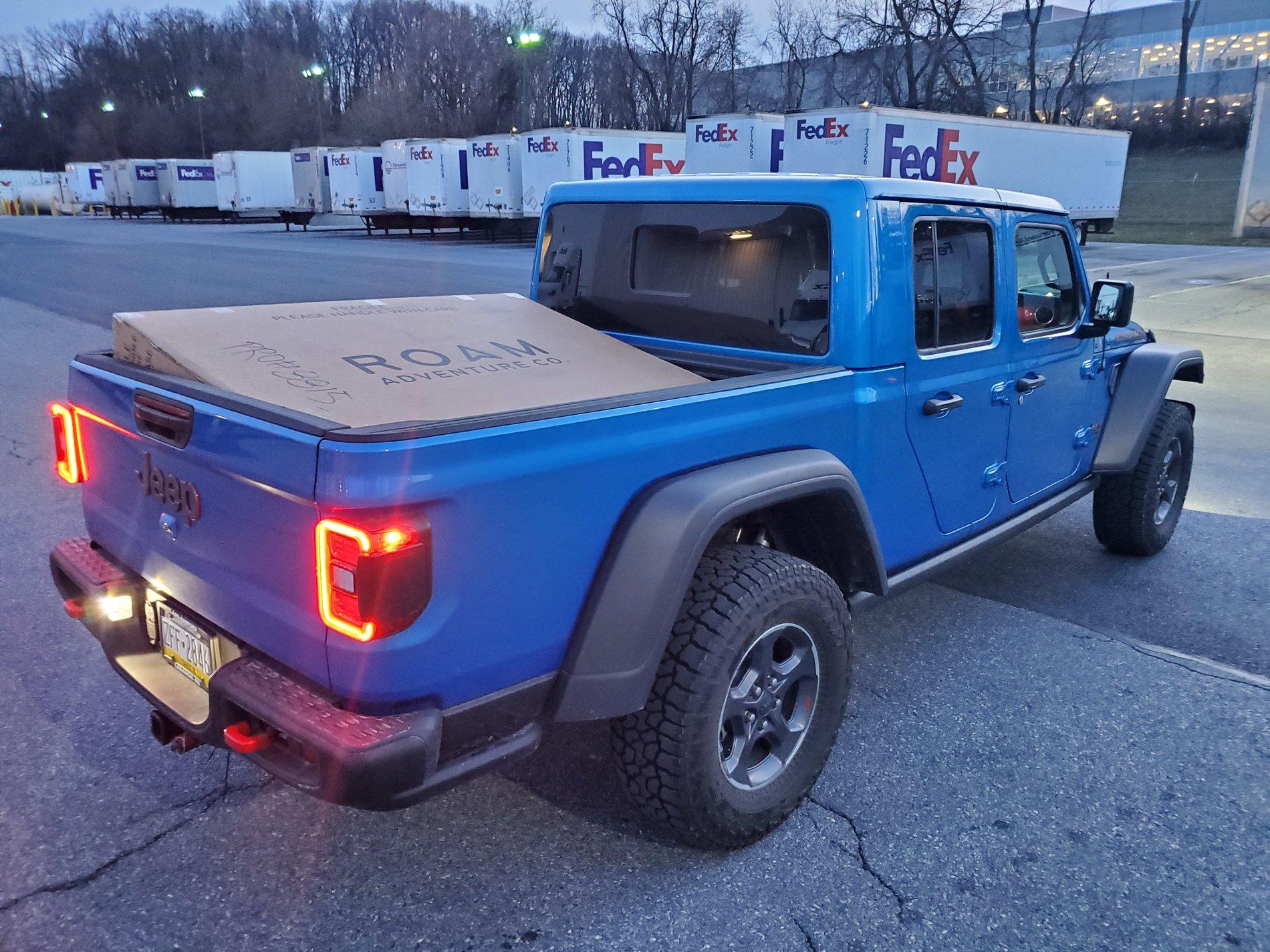

Picked up the tent at FedEx
Jeep Gladiator HYDRO BLUE PEARL Gladiator JT Club 20200203_174121
Now I have to get it installed on the truck.
