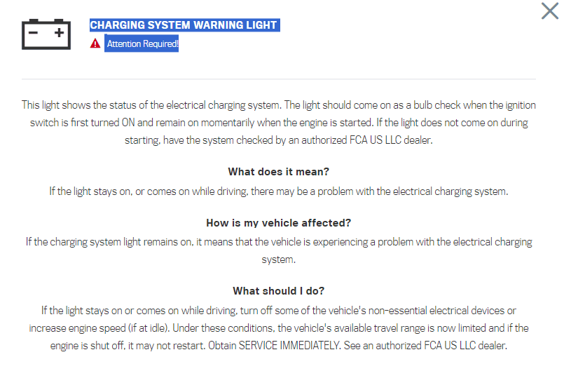

I got this alert this AM and am a tad confused
CyberHero
Nov 9, 2023
29
267
257
To Be Determined
2023 Jeep Gladiator Rubicon
I have never seen that light come on at all and my vehicle has 2k miles on it. Anyone else get this before? It appeared on my monthly Uconnect report. Jeep is driving just fine.

Manual says it only turns on if not charging properly! So does it turn on at all or not? Battery voltage after not starting for 4 days was 14.5

From the looks of it it should hit after I start the vehicle but it was in my garage parked for 4 days and it wasn’t started when it supposedly hit
The 14.5v displayed isn't your battery voltage, that's the charging system voltage. A reading like that indicates your battery needs charged so the smart charging system in your vehicle is doing exactly that. To see your actual battery voltage the engine needs to be stopped, so you should keep your foot off the brake and depress the ignition button twice so that it's in the RUN position.
Most likely the warning is due to nothing more than the battery/batteries being low from sitting for a few days, especially if you have a tendency to drive infrequently or for short trips. So long as the battery/charging system warning lamp stays off with the engine running and you're not getting other weak battery associated problems, I'd not worry too much at this point.

Amazing ya I go on 1-5mile spurts here and there and sometimes don’t drive it for a week or 4 days at a time. Just passed 2k miles in 8months. So happy to read this tho thank you
Happy to help. A good rule of thumb to keep your battery health up is to get in at least one drive lasting thirty minutes per week, otherwise you may want to invest in a quality battery maintainer.
With infrequent driving and only 1-5 mile trips here and there, that is your problem. The systems of the truck have a pretty significant drain on the batteries even when off (as compared to trucks in the 90's). But a 5 mile drive will never fully recharge the battery. Short cycling battieries, and not letting them fully recharge is a major killer of them. If you only drive minimally like this, you need a battery tender. But, if this is a consistent use case for you I would be more concerned about shortening the engine life. Short drives like that are terrible on engines and other components.
