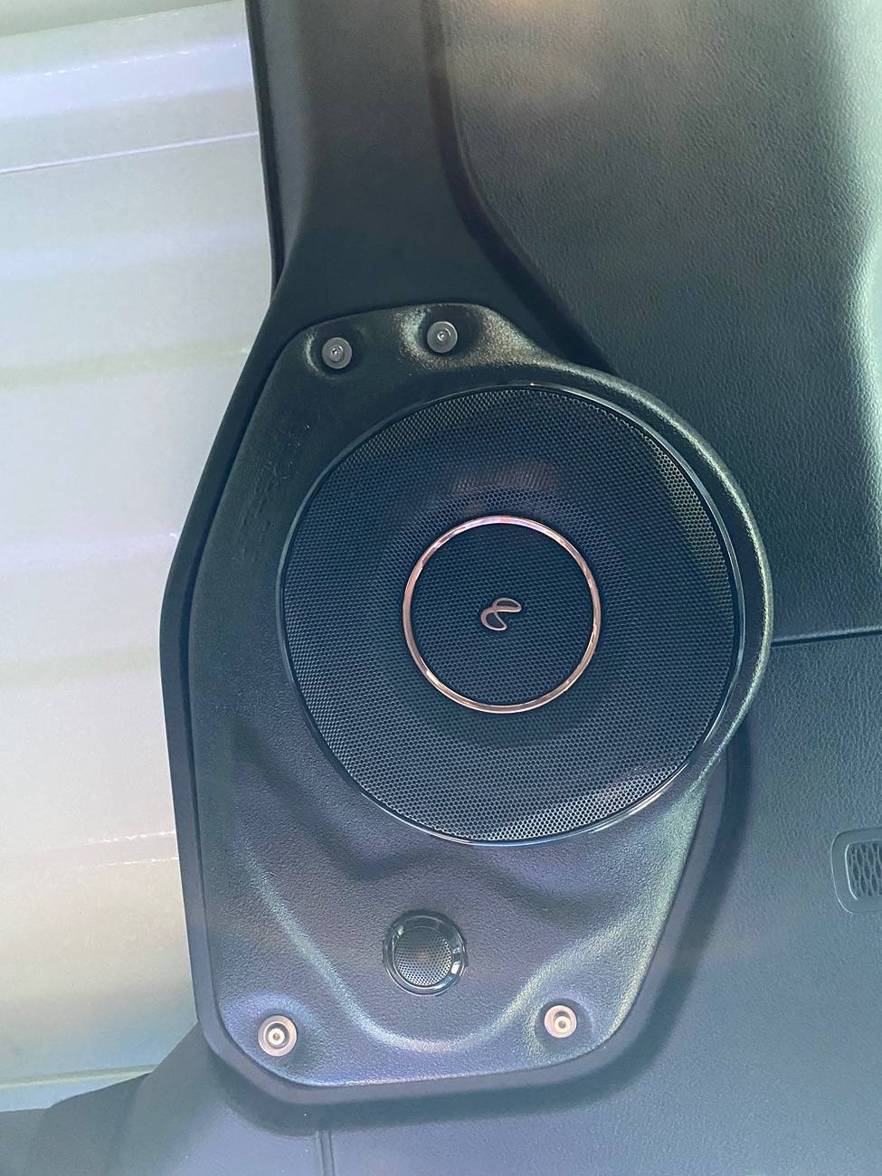

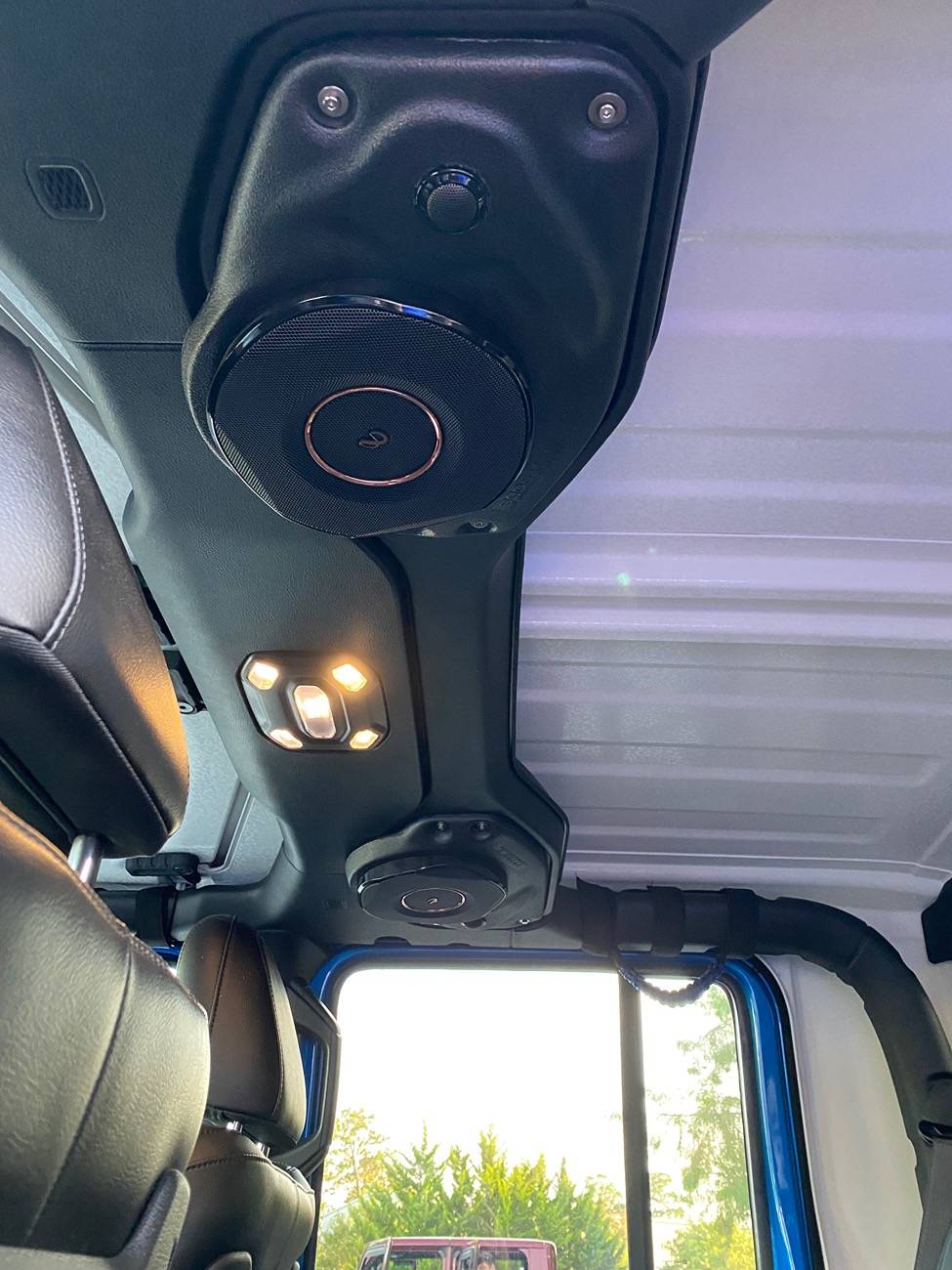

I'm partial to the Infinity Reference series.
These will fit with some work
https://www.crutchfield.com/p_108R607CF/Infinity-Reference-REF607CF.html?tp=106
They're rated at 90w at 3 ohm for the tweeter and woofer. IIRC the Alpine system is 45w at 2 ohm for the tweeter and woofer each. So it *should* be within the factory amp's rating.
You'd cut out the crossover included with them as well since the factory amp already handles that for the soundbar channels.
I do agree though, the old days of adding an amp and 6x9s and calling it a day were much nicer.

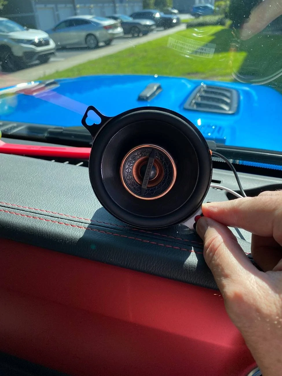

Watch this on a possible location: BTW. I have a Kenwood powered sub mounted on the back panel between the seats. Std Radio and 75w Kenwood Marine Amp under the drivers seat. Sound bar speakers are Kenwood 5" 2 way (cut to fit the OEM opening and 2 way tweeters in the dash top).
