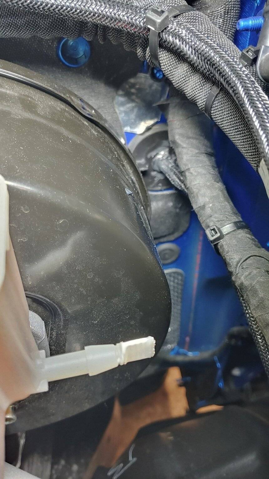

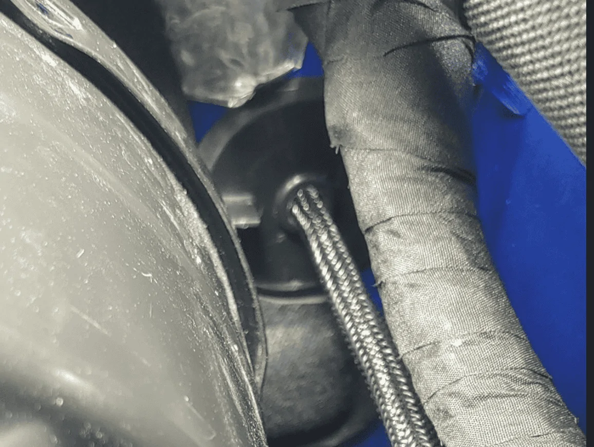

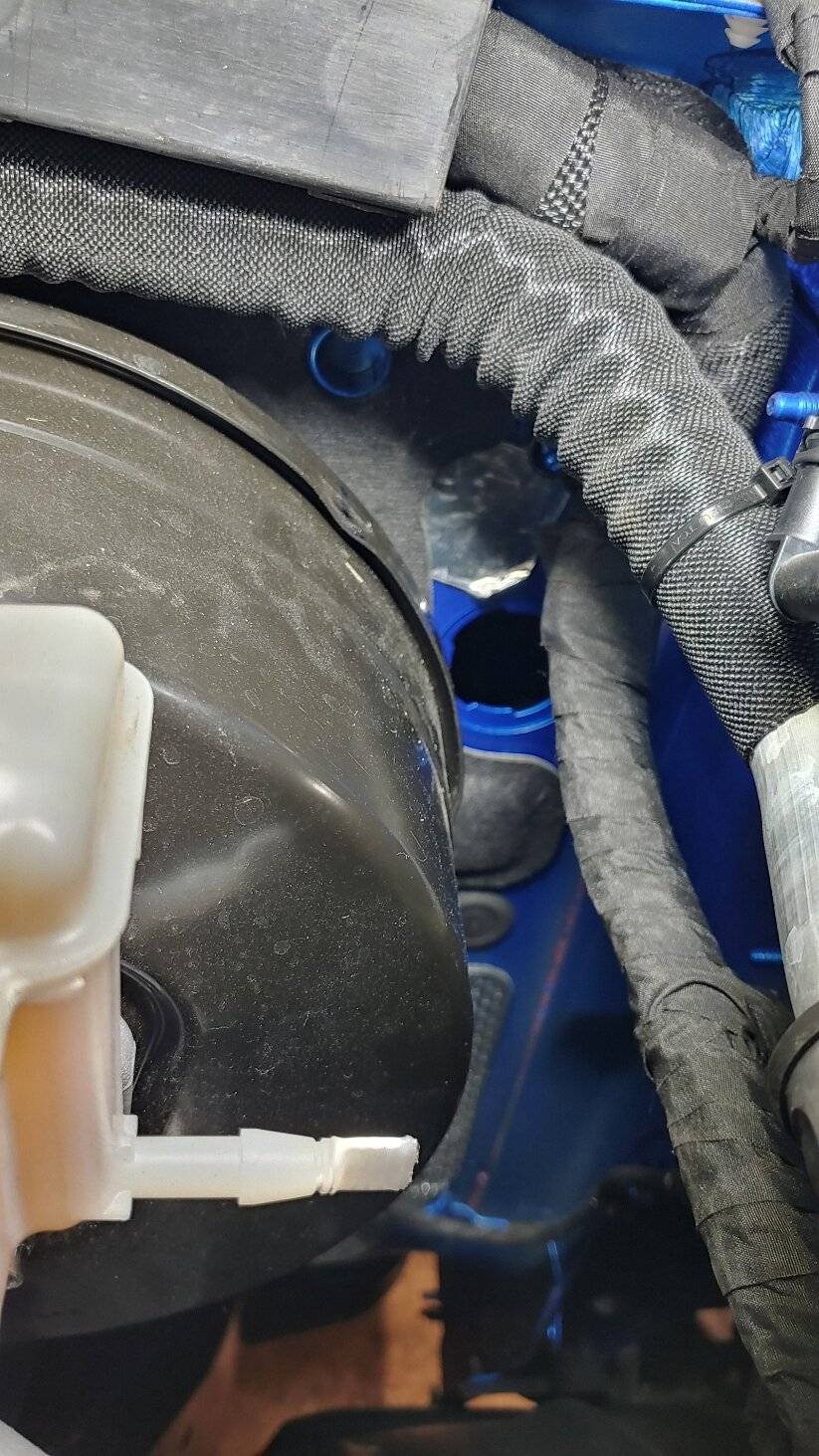

There is a plastic plug in the firewall near the brake pedal. It is the hole that is used by the clutch for those with a manual transmission. If you have an automatic, it should provide ample room to run all the wire you need.
Jeep Gladiator I need another pass through in my firewall 20221007_141436_HDR

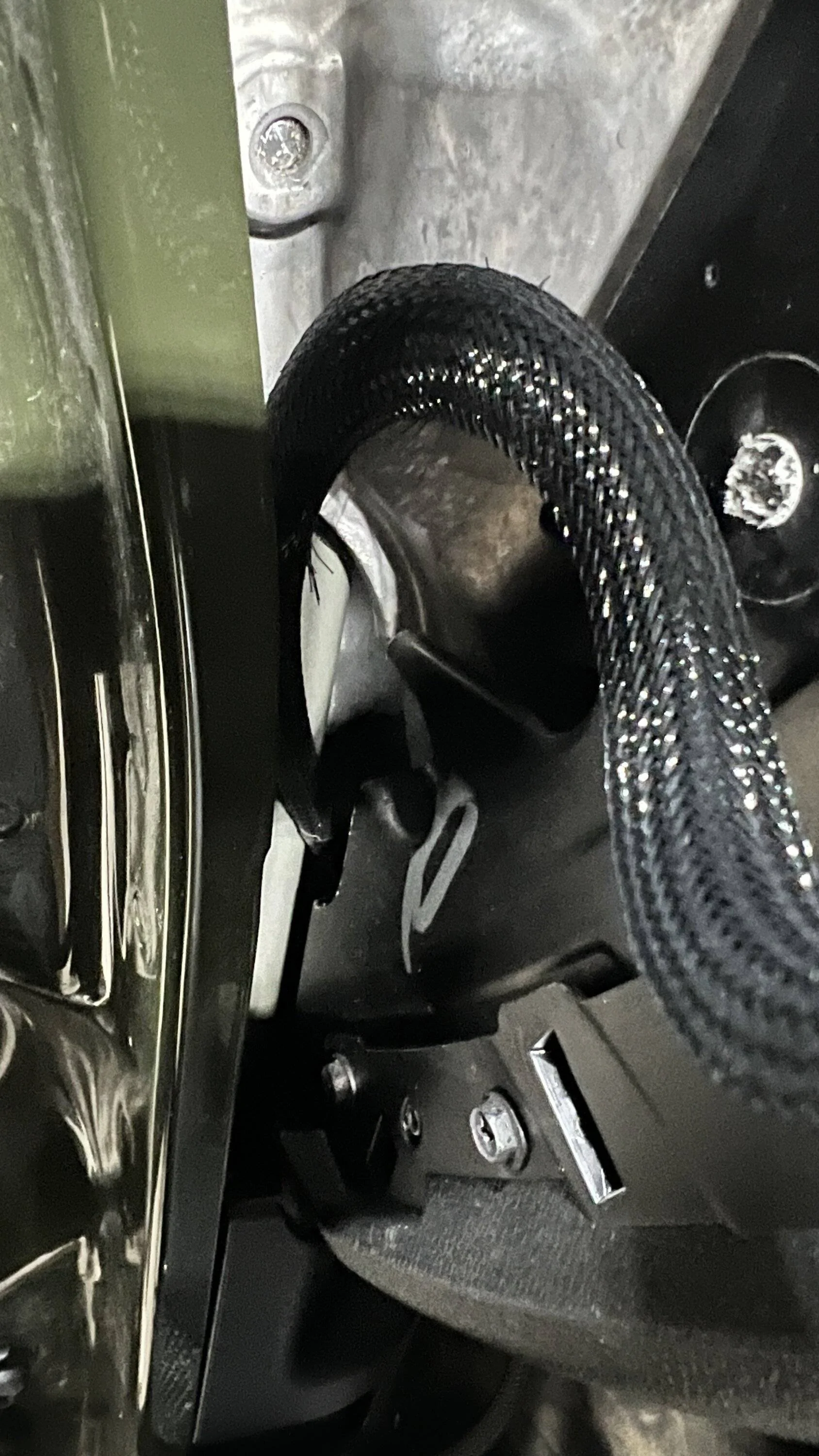

I removed the plastic plug, drilled a hole in the center of it, ran my snow plow control wiring through it and used a rubber grommet in the hole I made in the plastic plug I drilled.
I further sealed with RTV.
Thanks Shadowspapa, I’ve used that one a lot and already have several wires running thru there. I was able to run my Warn solenoid switch wires thru, but there’s no way I ll be able to fit my Midland power wires and antenna cable thru. Others suggested going thru the windshield gap and side cowl . I’m going to look at that today. Thank you for your input.
exactly what I did

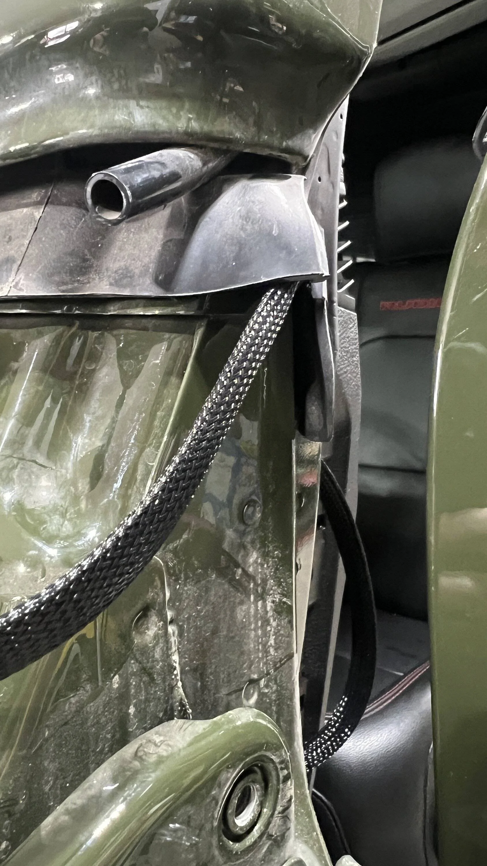

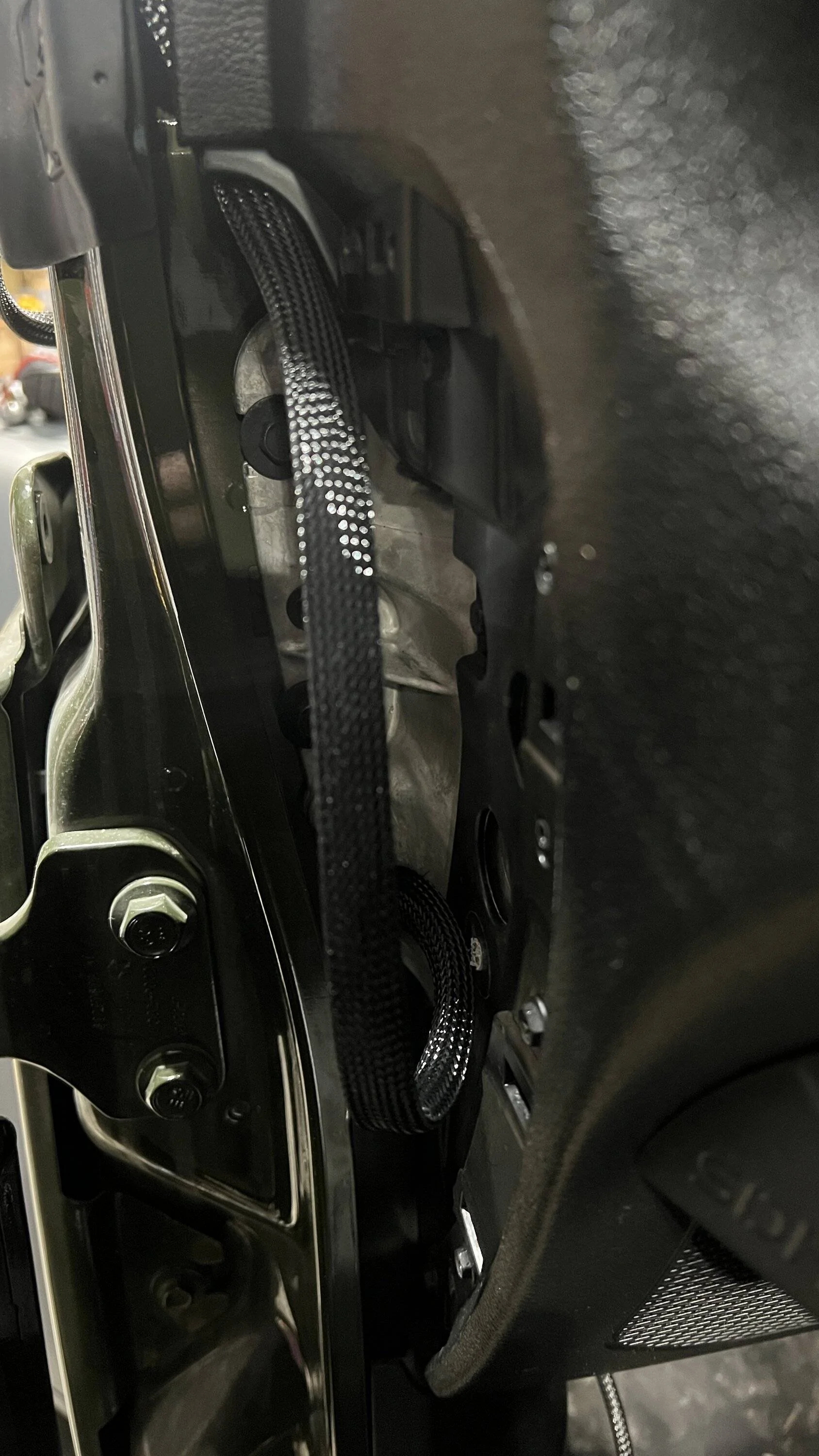

Mark
I went through the cowl/windshield gap for my dashcam power, and the other side for my antenna. gmrs power went through the firewall. The cowl/gap works really well
