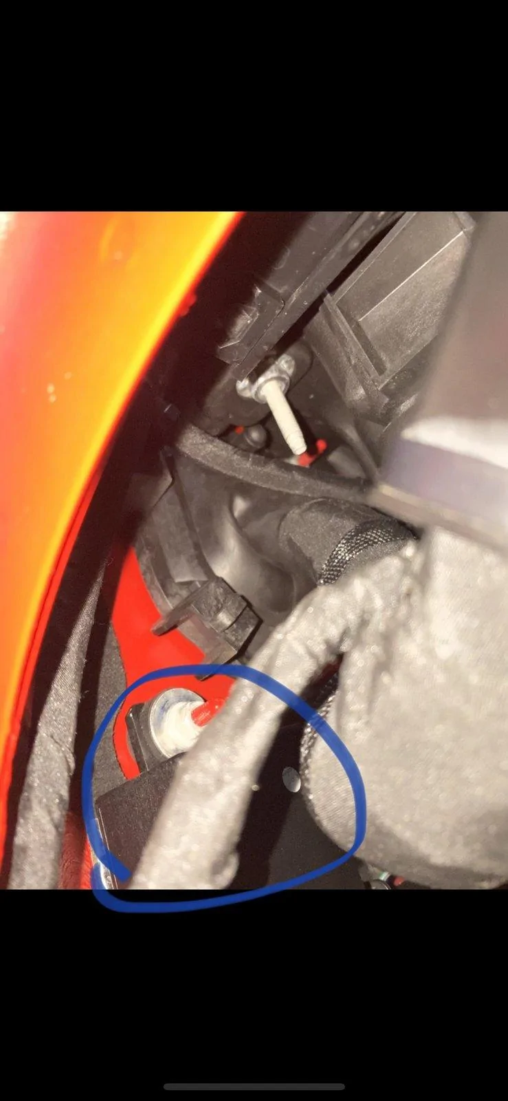

Update: ended up having to make room under the wheel well, took off a black box that is to the passenger side of the grommet (See picture). Once off, made a slit and was able to get the harness through by hand. I damaged my connectors earlier with the hanger method so be careful doing . Now need to find connectors and will post here with an update and model number.

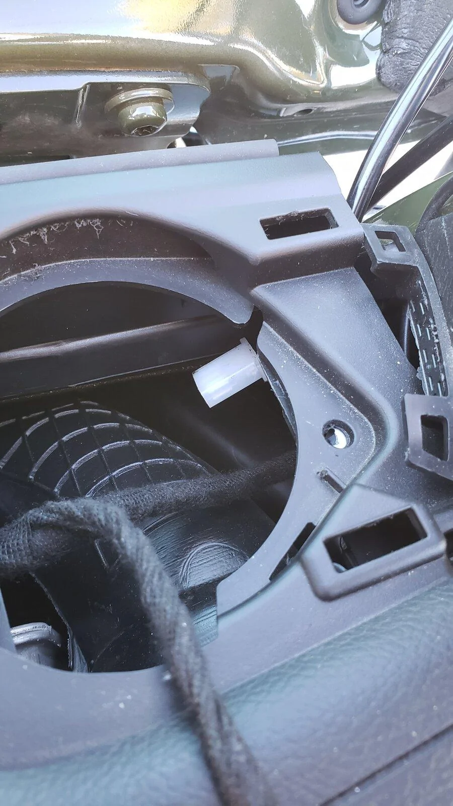

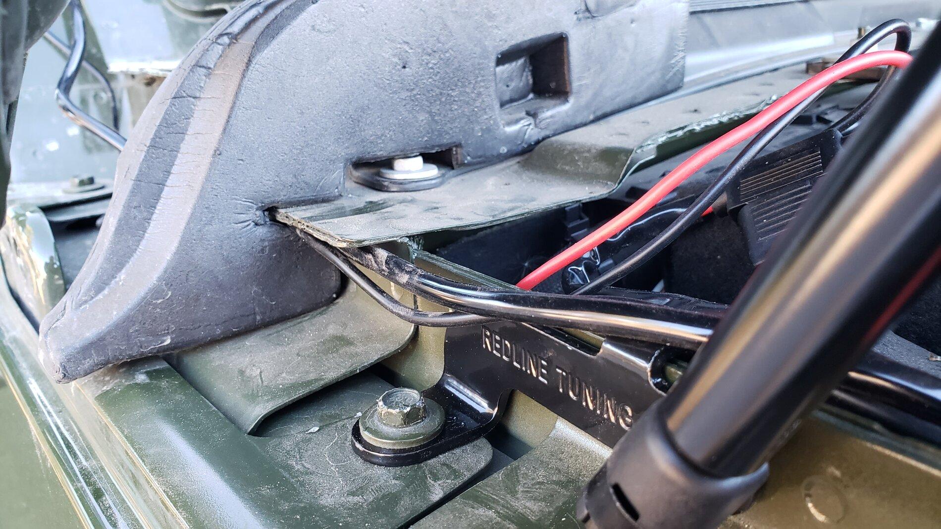

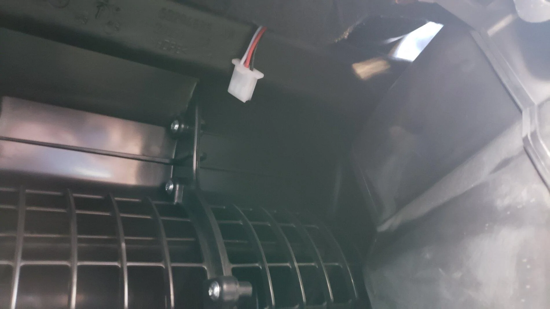

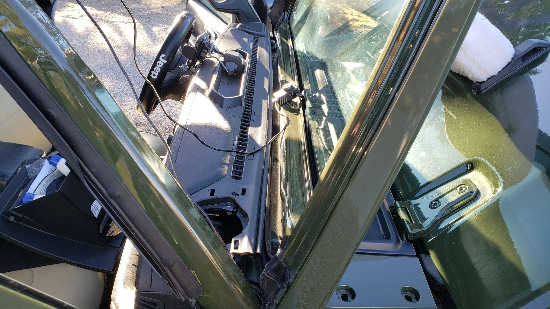

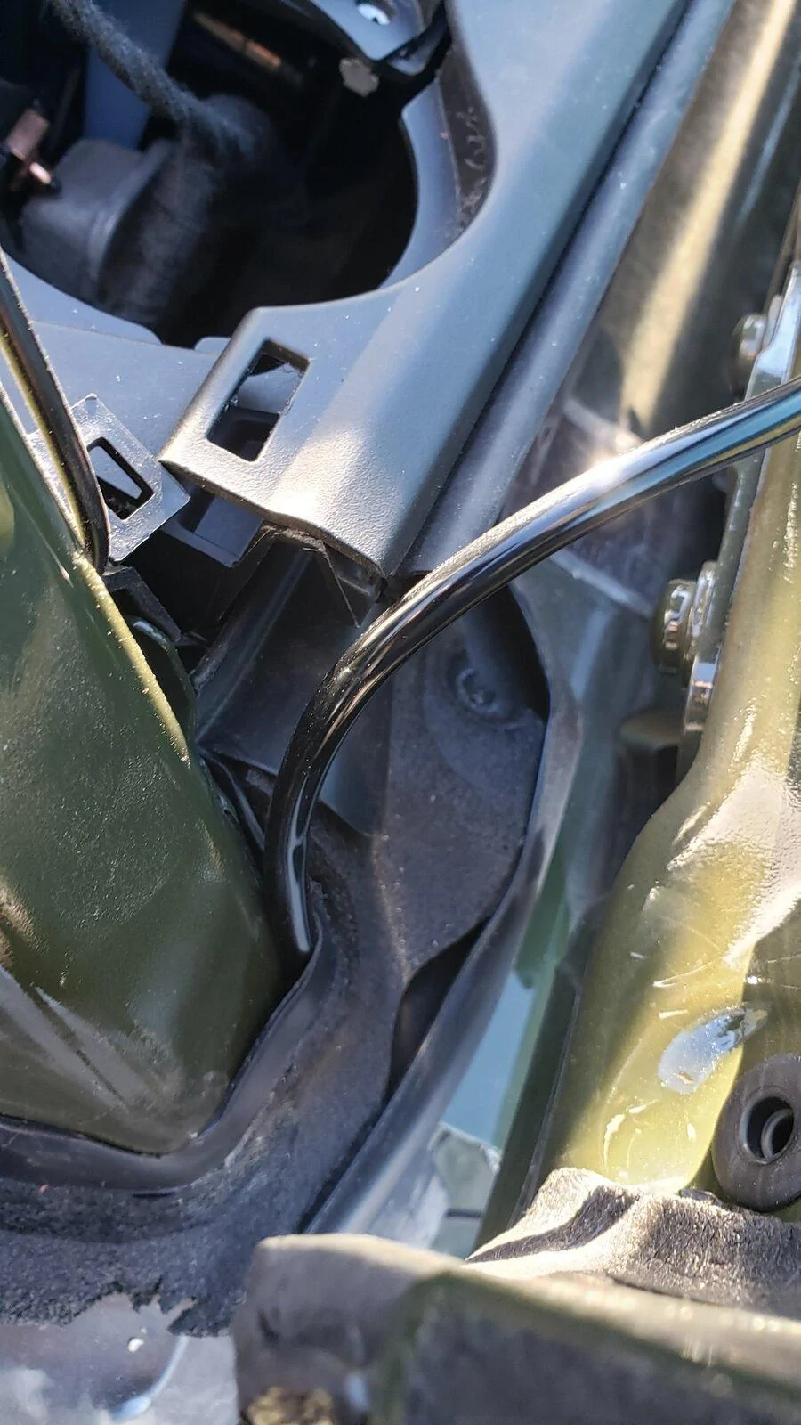

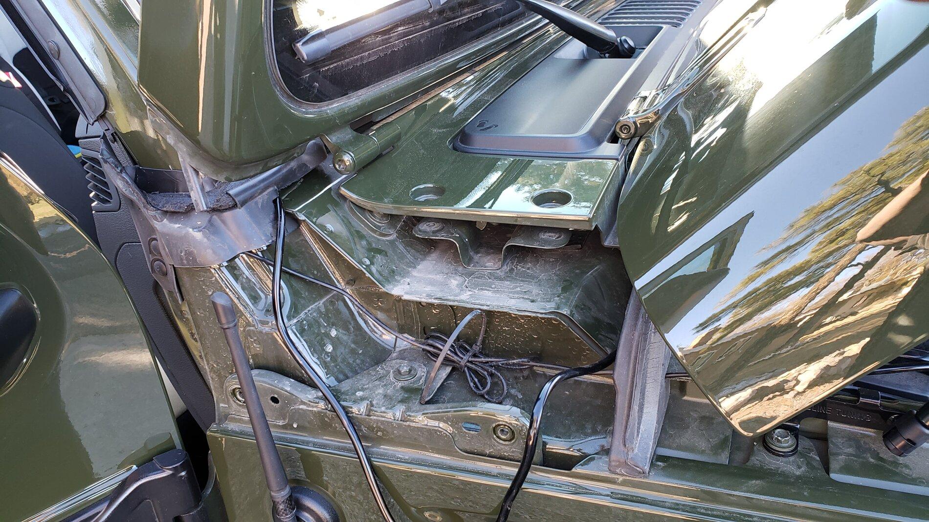

I'll be honest, I like to do things the right way, but when that way is waaaayyy too difficult, I will find another way. I wanted to go through the passenger side fw, but perhaps it is my diesel config that makes that next to impossible.
So, I went a different route:
1) remove little panel between hood and windshield.
2) tilt window forward a little (I just opened the hood and put a pad spacer so I didn't have to remove wipers
3) remove speaker and glove box.
4) route wire under weatherstripping, down past speaker bay and it pops out right above the globe box.
Sooooo much easier. No, not worried about water penetrating. Can easily route many more wires.
