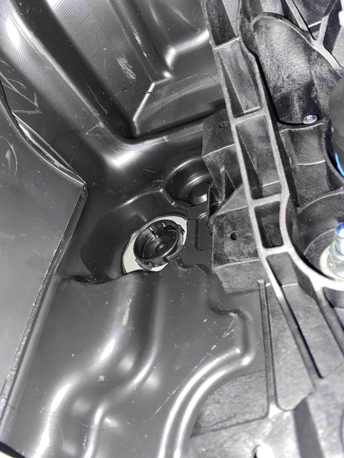

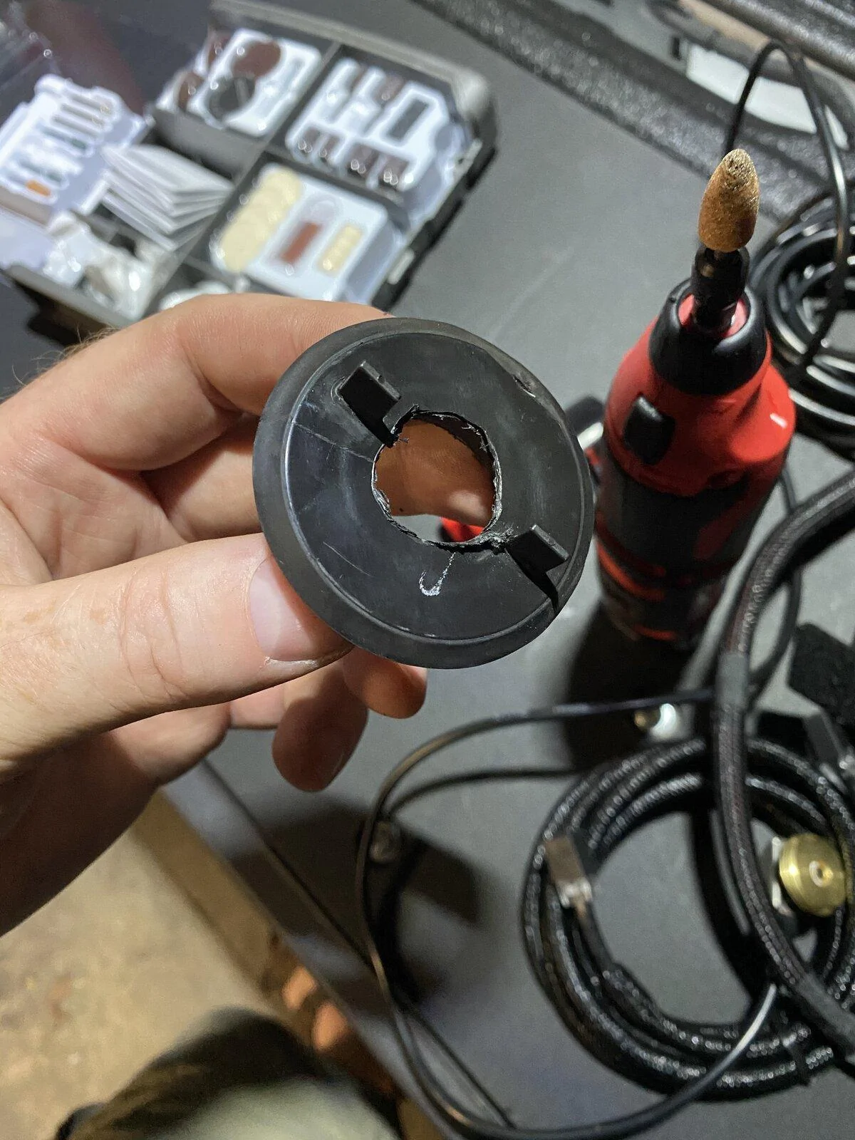

Pic from the inside. It’s the lower left plug. Dremel or drill out for your wire/s then seal around with RTV or like sealant. If you leave to plug out and don’t seal you will get water in the drivers footwell as reported by other JL/JT owners.
also you can pick up spares of this plug online. Here is the part info.
68336758AC​
Dash Panel Plug​
$1.88​
