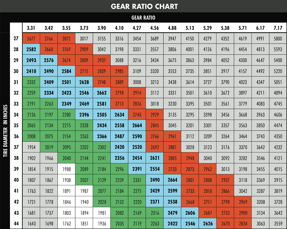

Jeep Gladiator Regearing, where does the power come from? 1699032274510
This chart is from 4wd. It is rpm at 65 mph in a 1:1 gear. What is important is the relationship between gears. Typically, you want a little more mechanical advantage as you move up to bigger tires, lift etc. so you would welcome more rpm..
