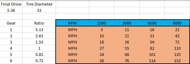

I've gone through the math and it should be ideal for my 75% off pavement (FS and logging roads), 15% in town, 10% highway, and 0% crawling use for the vehicle. I want good torque from 0-50 mph and 3k rpm max at about 75mph in 6th. It only looks like a radical change because these things are geared so wrong from the factory.
You really shouldn't do that. That's WAY too much gear. I don't know why FS roads would require a regear at all. They are not "geared so wrong" from the factory with stock sized tires. I really mean no offence, but you don't seem super experienced here and I suggest you take advice and do some research before making that change.
