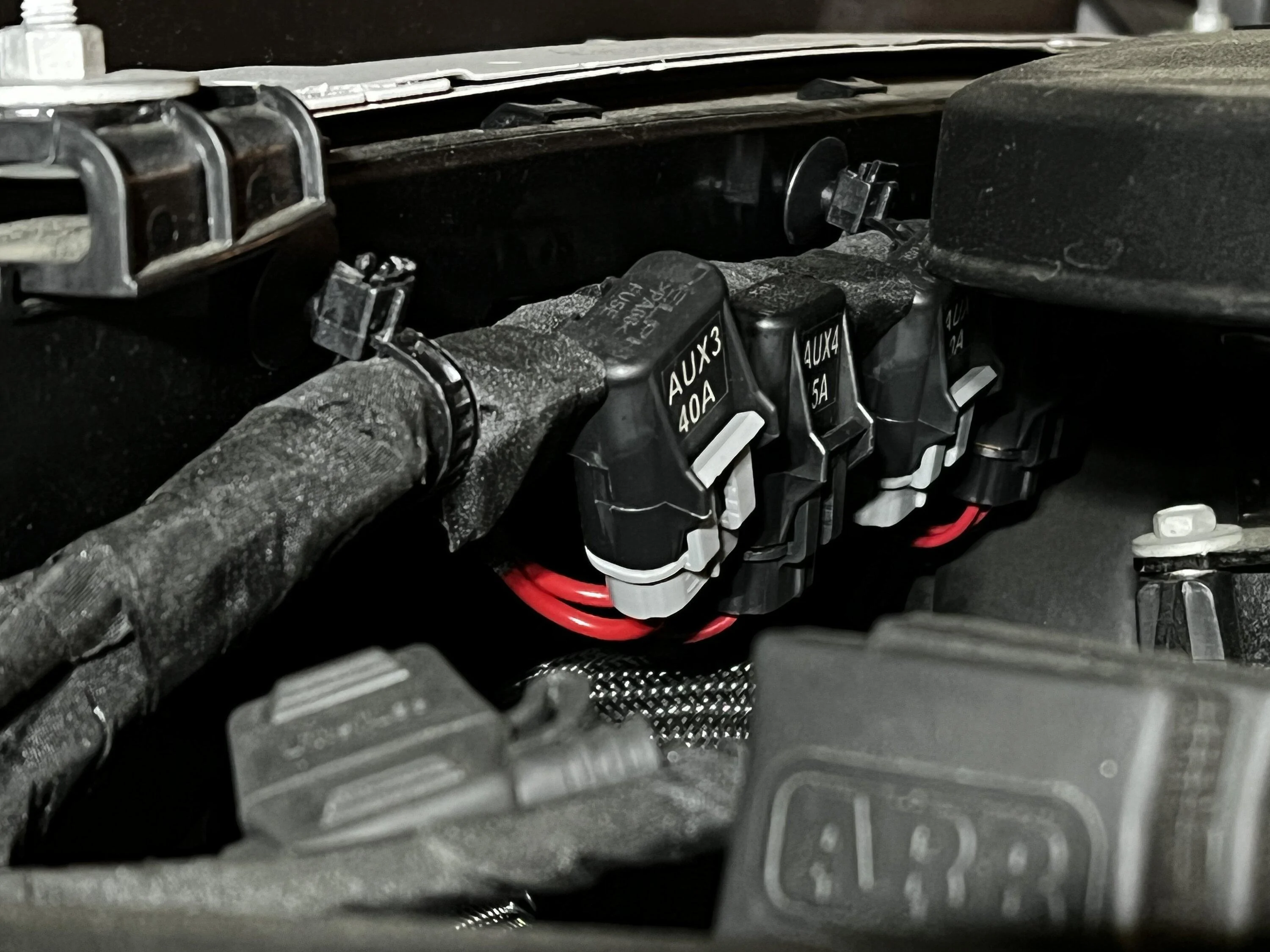

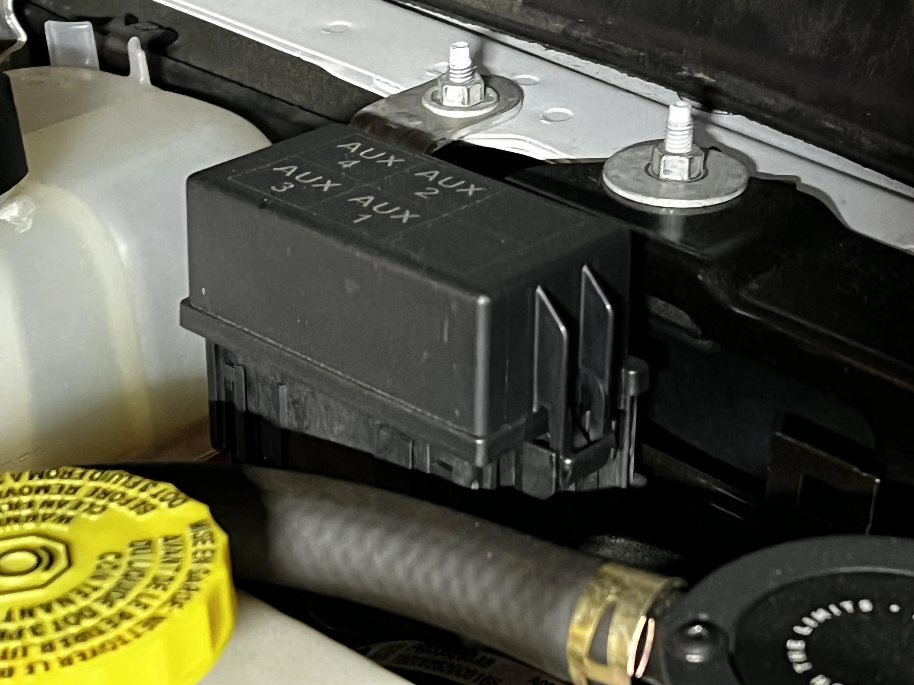

Look under the hood. If you do not have these under your hood then you have to buy the whole kit.
Fuse holders behind the engine cover…

Relay box near the coolant res…
