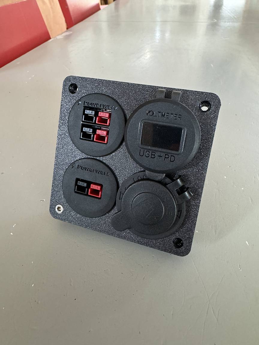

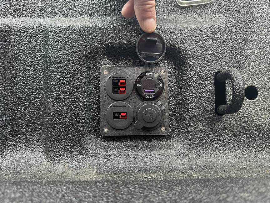

I wrapped up the installation this past weekend... very happy with the results. With this setup I'm able to charge my EcoFlow River 2 Pro at 188 Watts without the need to boost charge voltage.
I wound up using a 120A relay and 6ga wire from the battery to the bed. The wiring is protected by a 60A Midi fuse located next to the main battery. I also added a flyback diode to protect the Aux circuit relay and changed the (40A, F92) Micro2 fuse for Aux switch #2 to a 5A one since this circuit will never see more than 1 amp or so.

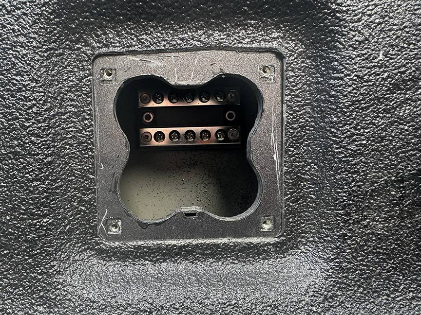

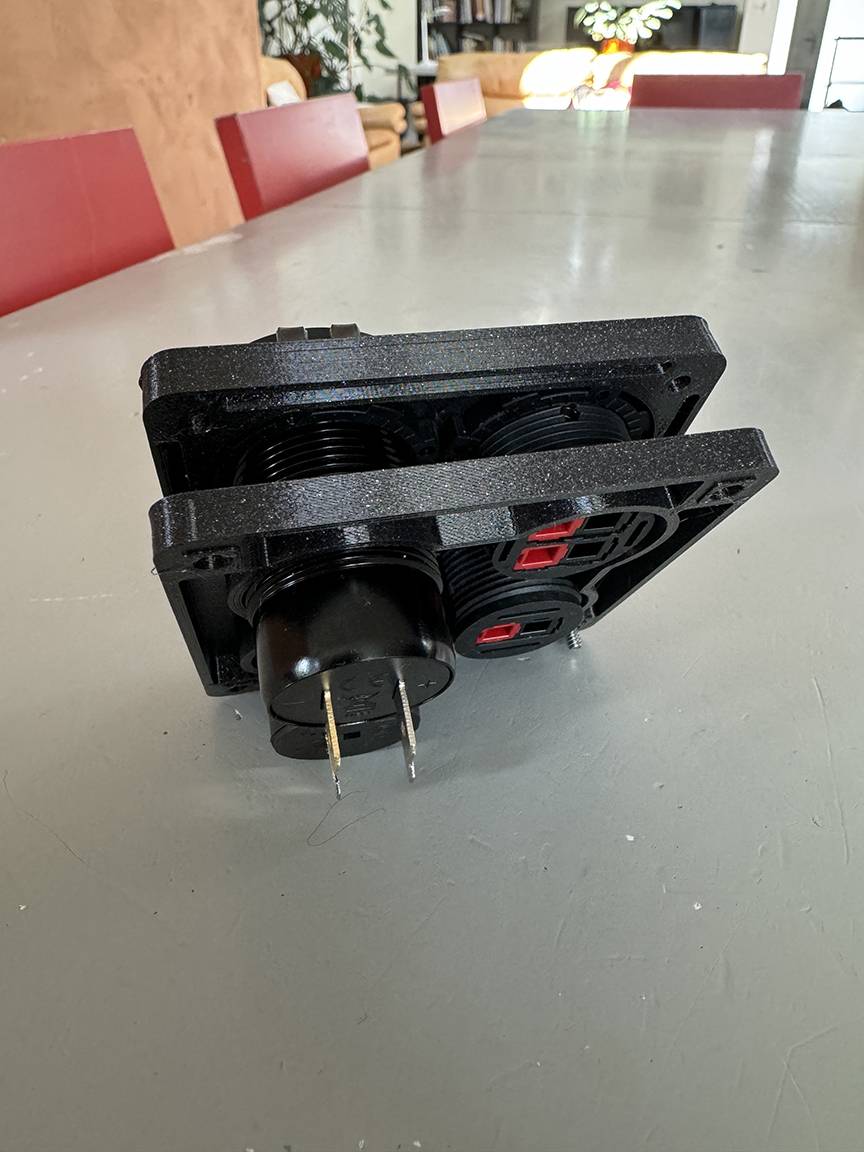

I needed to do a little bit of trimming to fit my connector panel into the opening in the bed, but I was able to use the stock mounting holes in case I ever choose to install the factory 115V inverter outlet or put the blank plate back in.
