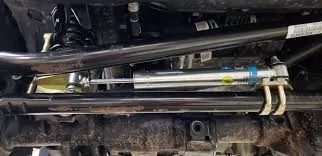

I would suggest that anyone who is willing to spend that kind of money on a stabilizer also buy a relocation kit, and the appropriate model stabilizer to fit the relocation bracket. If not, you are potentially wasting the $350 when it is damaged by a rock. This mounting method should offer more protection:
