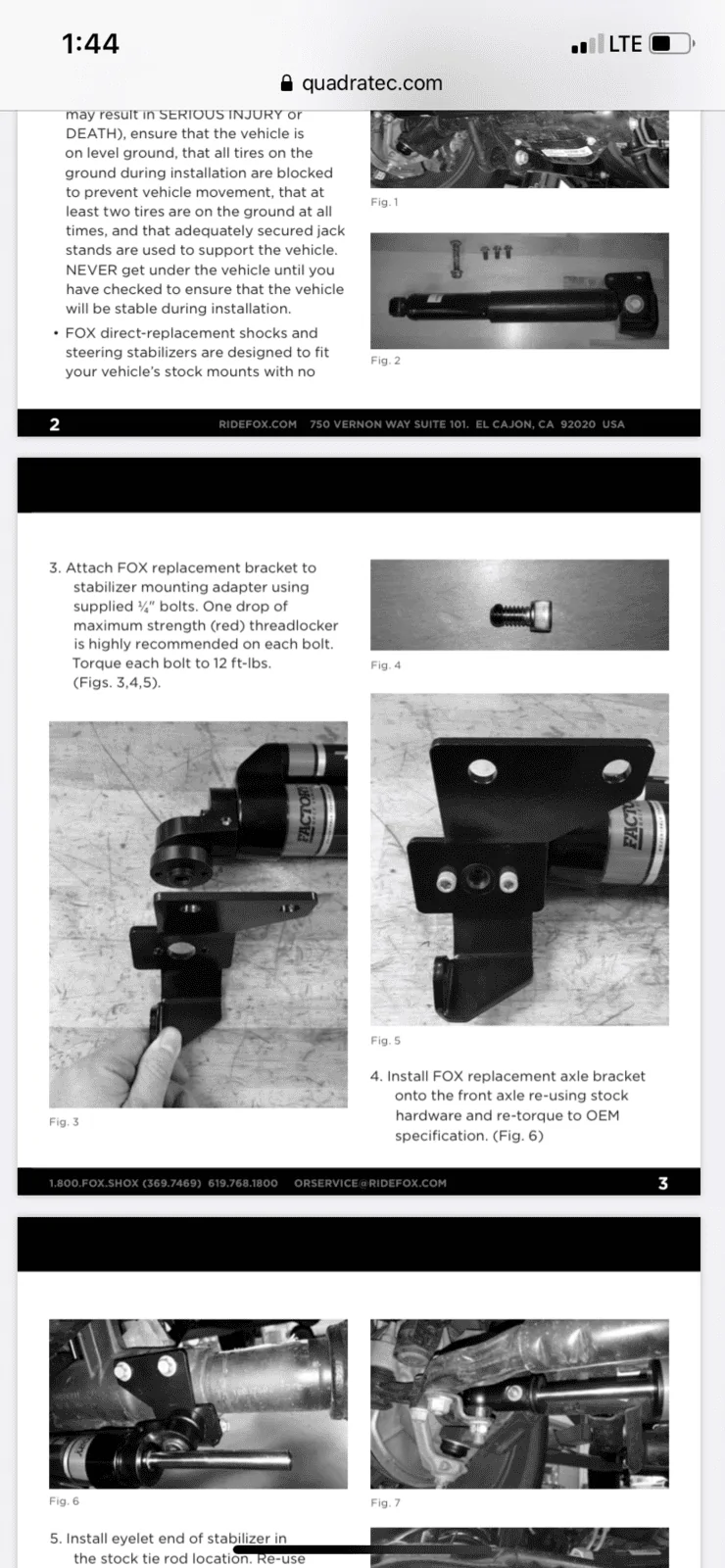

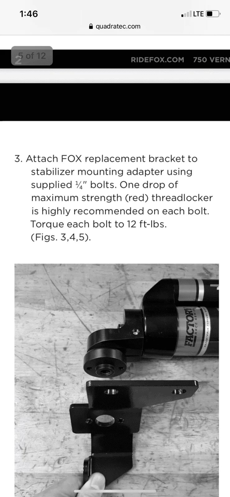

A 1/4” bolt to Torqued to 12 lbs with lock tight holding a stabilizer together which takes the brunt of bumps in the steering going down the road is sketchy to me sorry. Yes that’s my opinion. Quadratec said they initially had issues which is why they added this lock tight verbiage:

1/4” bolt with lock tight holding a stabilizer together which takes the brunt of bumps in the steering going down the road is sketchy to me sorry. Yes that’s my opinion. Quadratec said they initially had issues which is why they added this lock tight verbiage:
The bolts don't hold any pressure, or take any force. If you look at that top picture, you will see that tennon that sticks out from the shock bracket. It goes directly INTO the mounting bracket (and fits REALLY tight by the way), between the 2 small screws. That solid metal tennon is what takes all the force, and not the screws. The screws simply hold the 2 brackets together from top to bottom...That's it. There's no force on them, other than being torqued to spec that's holding holding the brackets tight. Could they have used some larger screws? Sure... I wouldn't complain if they did (overkill means safety to me), but I feel that those are adequate being that they don't take on any force at all, other than holding the 2 brackets together.
