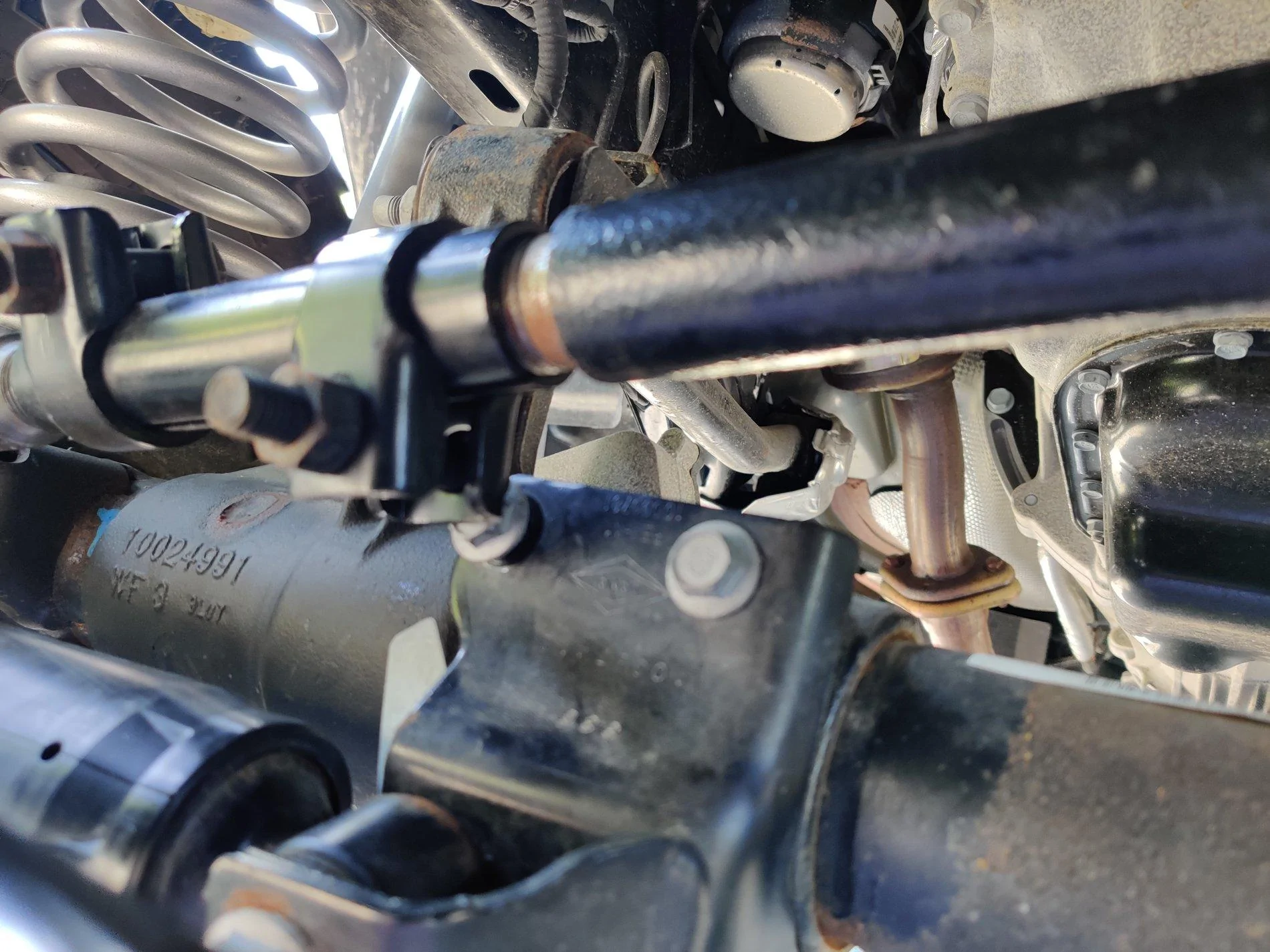

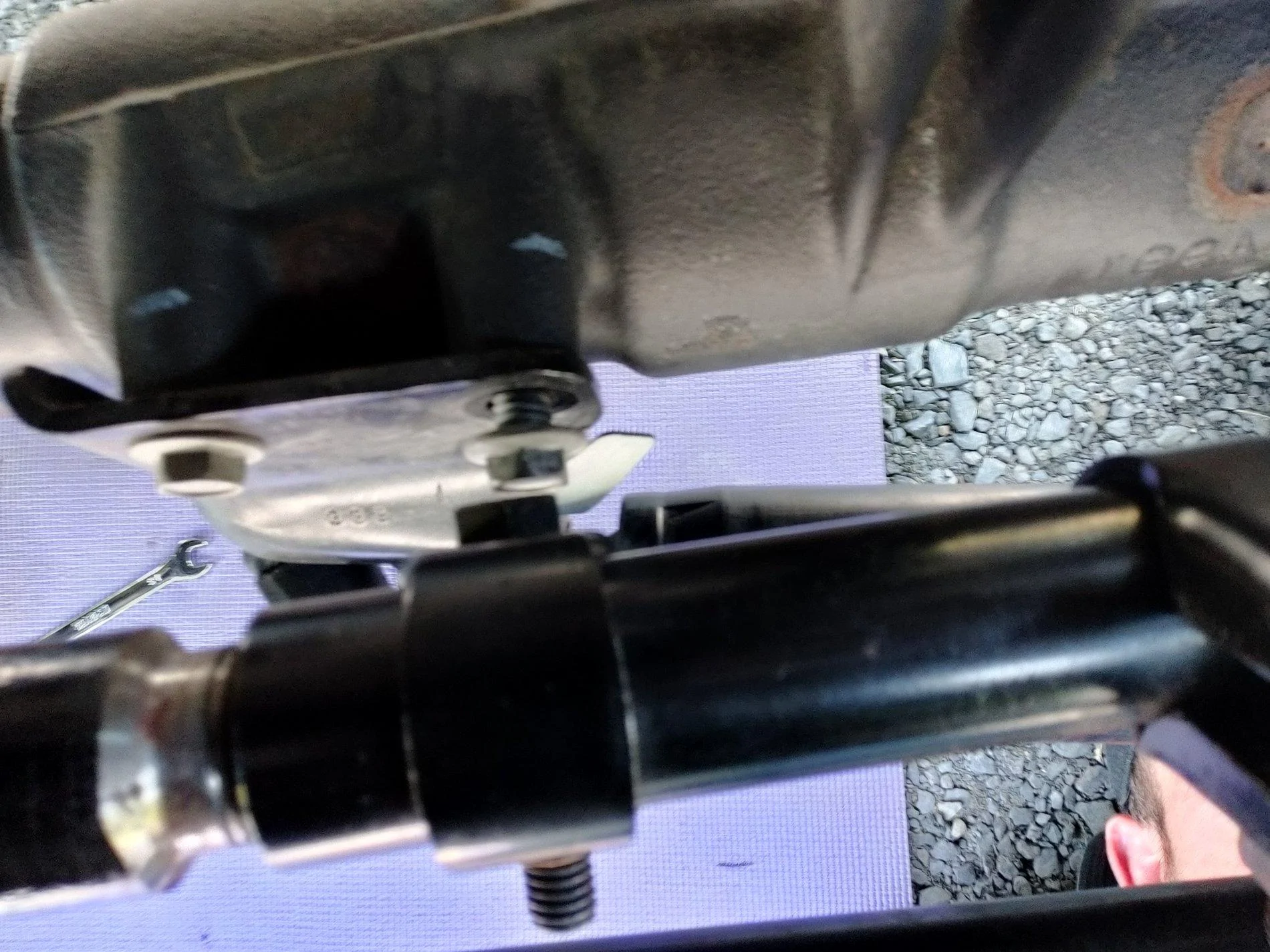

I had the shop put it on with my life kit and now I can't get the bolt off to the stock stabilizer to add my dual stabilizer because it's in the way. Can I play around with this bracket on the track bar to move it a little or just take it back to the shop? I try to do the little things myself and it's always something.
Jeep Gladiator Adjustable track bar in the way of Stabilizer bolts IMG_20200719_141136
Jeep Gladiator Adjustable track bar in the way of Stabilizer bolts IMG_20200719_141116

That is a clamping bracket. You should be fine to loosen it and rotate it for better clearance. Nothing should move on you . Just retorque that bracket to spec from your track bar docs.
Deleted member 30519
Thanks bro
Do you think I can do this and the stabilizer without jacking it. Nothing but steep gravel driveway here.

Yes. This should be done on the ground anyway. Just be prepared to roll around on the ground. :like:
I got the RC stabilizer on and it feels great. I had it on my JL for about a year and a half so I diddnt wanna let it go to waste. Next step is an alignment and I'll be all set for a while. Thanks for the help guys.
I think it was the shops fault because when I look at all the pictures online the brackets on the RC track bar are in opposite direction from where they put it.
