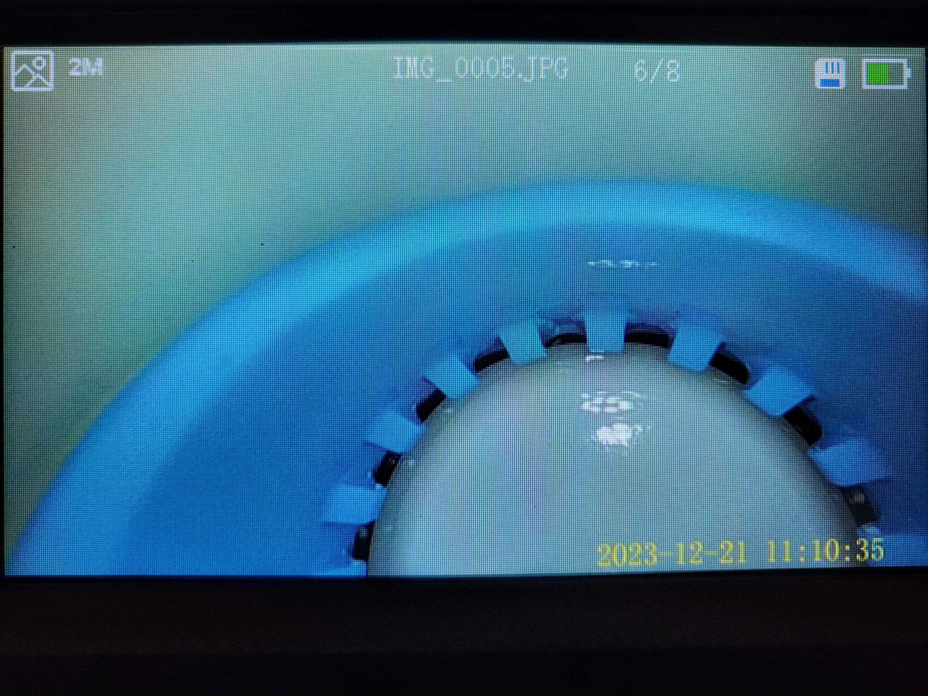

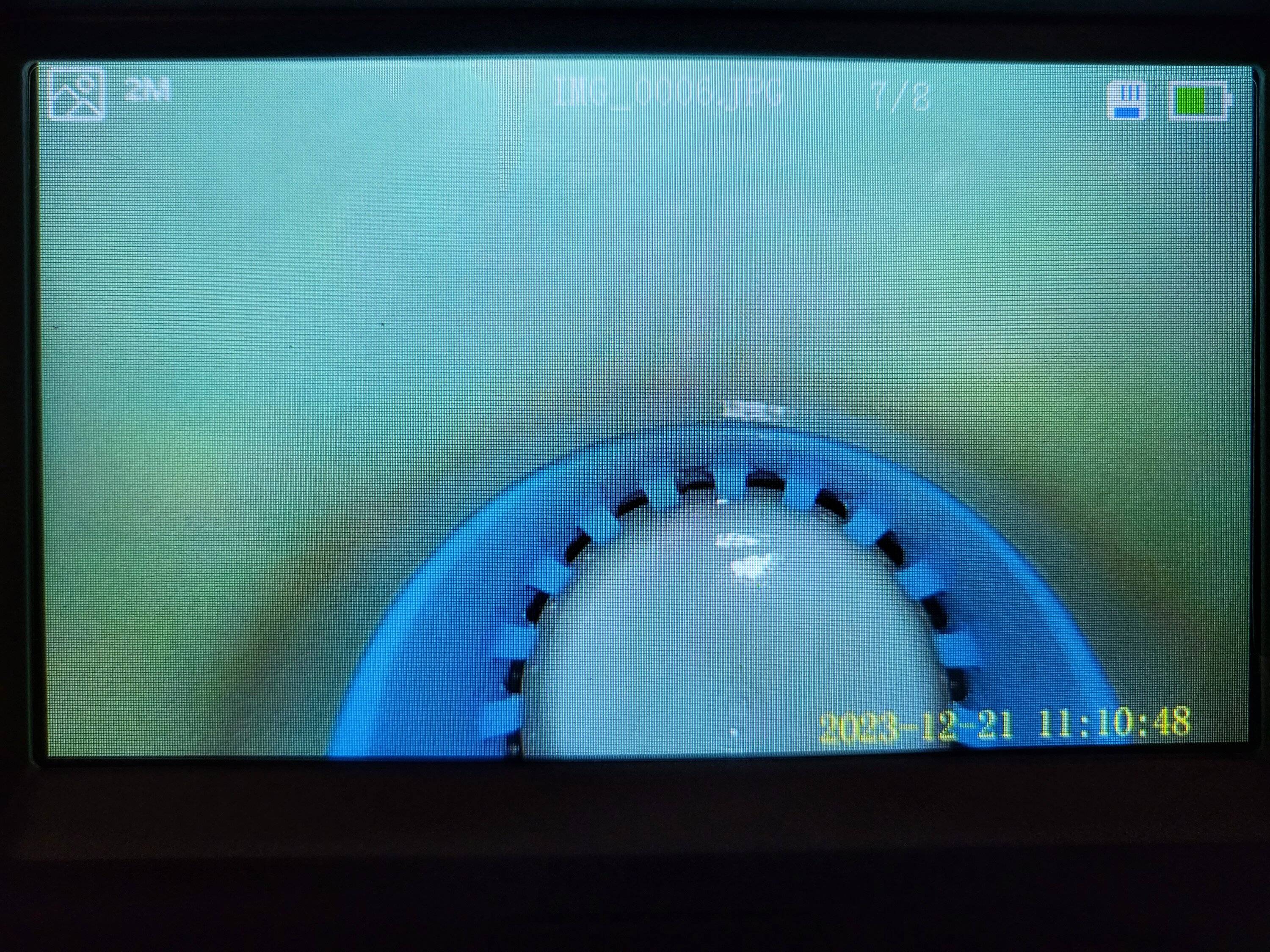

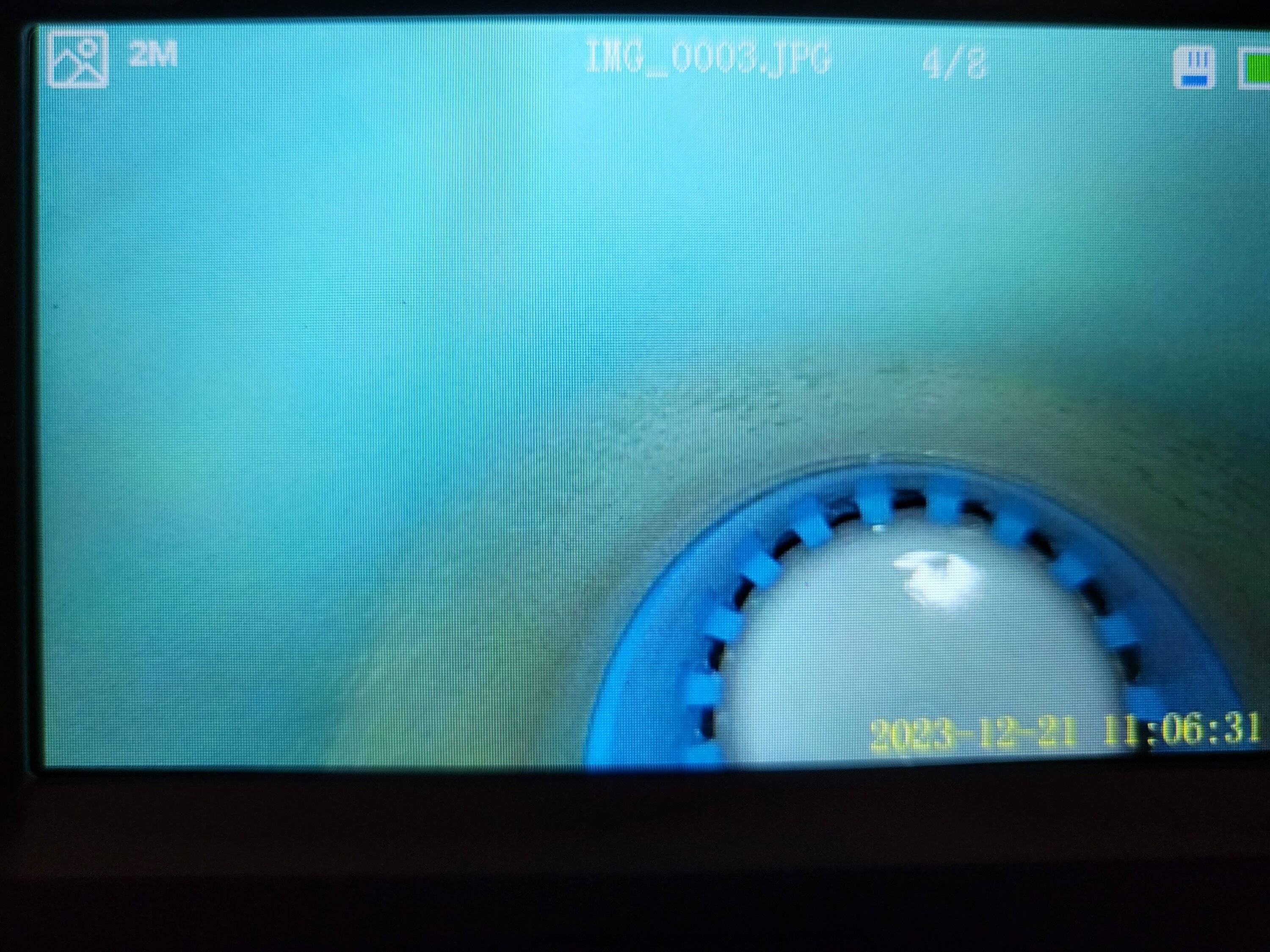

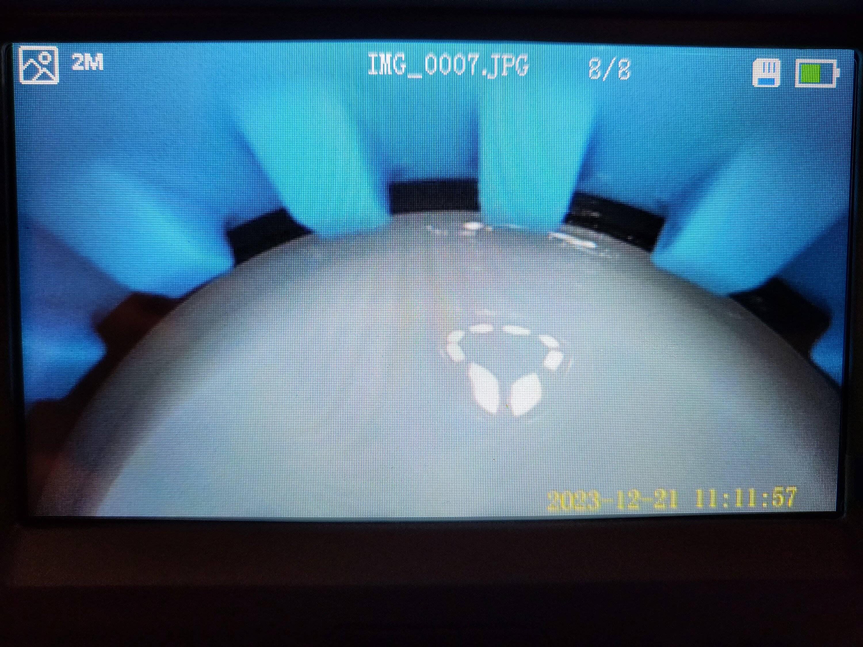

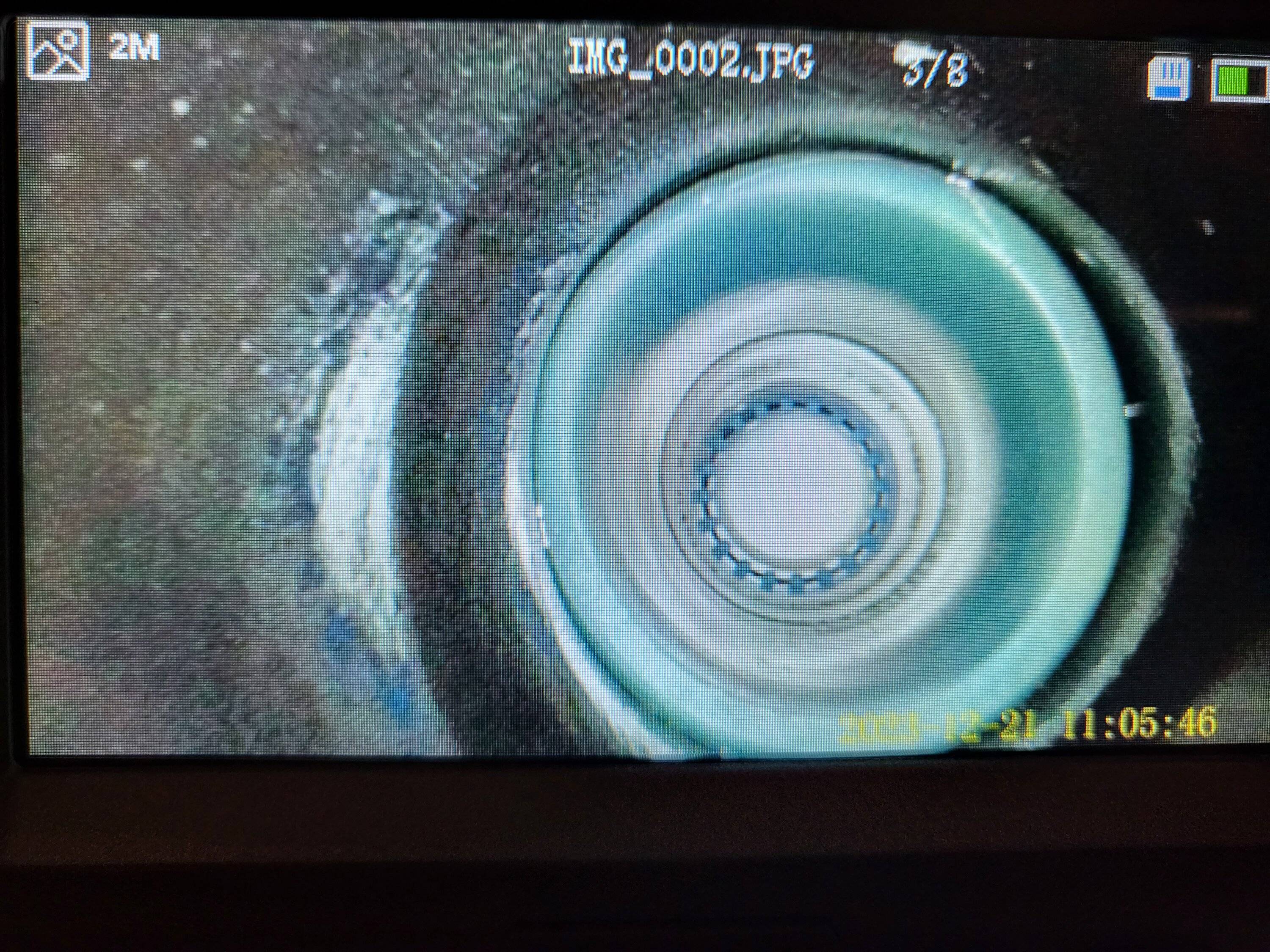

A few weeks ago I installed a full belly skid system from Next Venture Motorsports. Ever since, I am having a very difficult time getting the gas tank all the way to full, meaning it will fill up and click off and I can virtually dribble 3 more gallons. I can eventually get it full but it takes a while. I've never had a gas burping issue but I know others have. So I bought a bore scope to make sure I didn't kink the fill tube during installation. These pictures are interesting to see what is down in the fill tube at the gas tank. I'm assuming this is a valve connected to a float in the tank that seals up the fill hole at the tank inlet but still allows gas to slowly seep in through the fingers allowing a slow controlled top off. There is an o-ring around the white plunger and under the blue fingers. Nothing kinked on my fill tube so next I'll check to make sure the tank is level. Just really wanted to share the pics. Sorry for the pixelation but I just took pics of the bore scope monitor.
