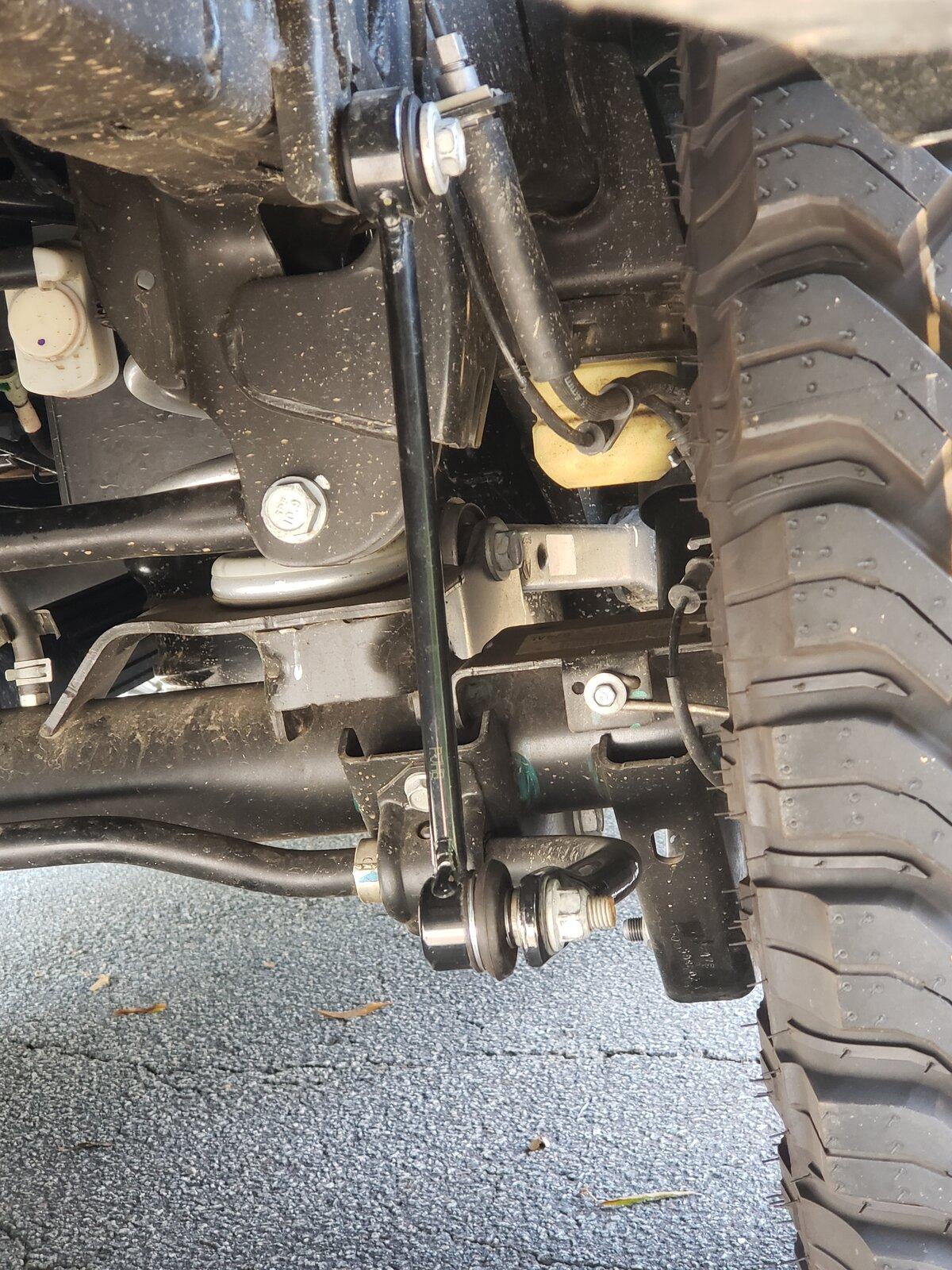

How do you tighten the bottom bolt on the rear sway bar disconnect? After about a week into my coil swap, it's been popping like crazy. I torqued the top bolt to spec. I've tried to tighten it and loosen it, but no luck.

No dumb questions, there is a female hex at the end of the bolt facing the tire, so hex key and wrench, if you ever need to to release again for another spring or spacer the top bolt is much easier as it has a captive nut

You are the man, I did not see that. Worked like a charm.
