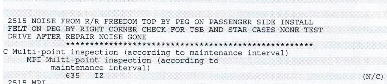

Here's my update from the dealer. it was from the rear of the passengers side freedom top.

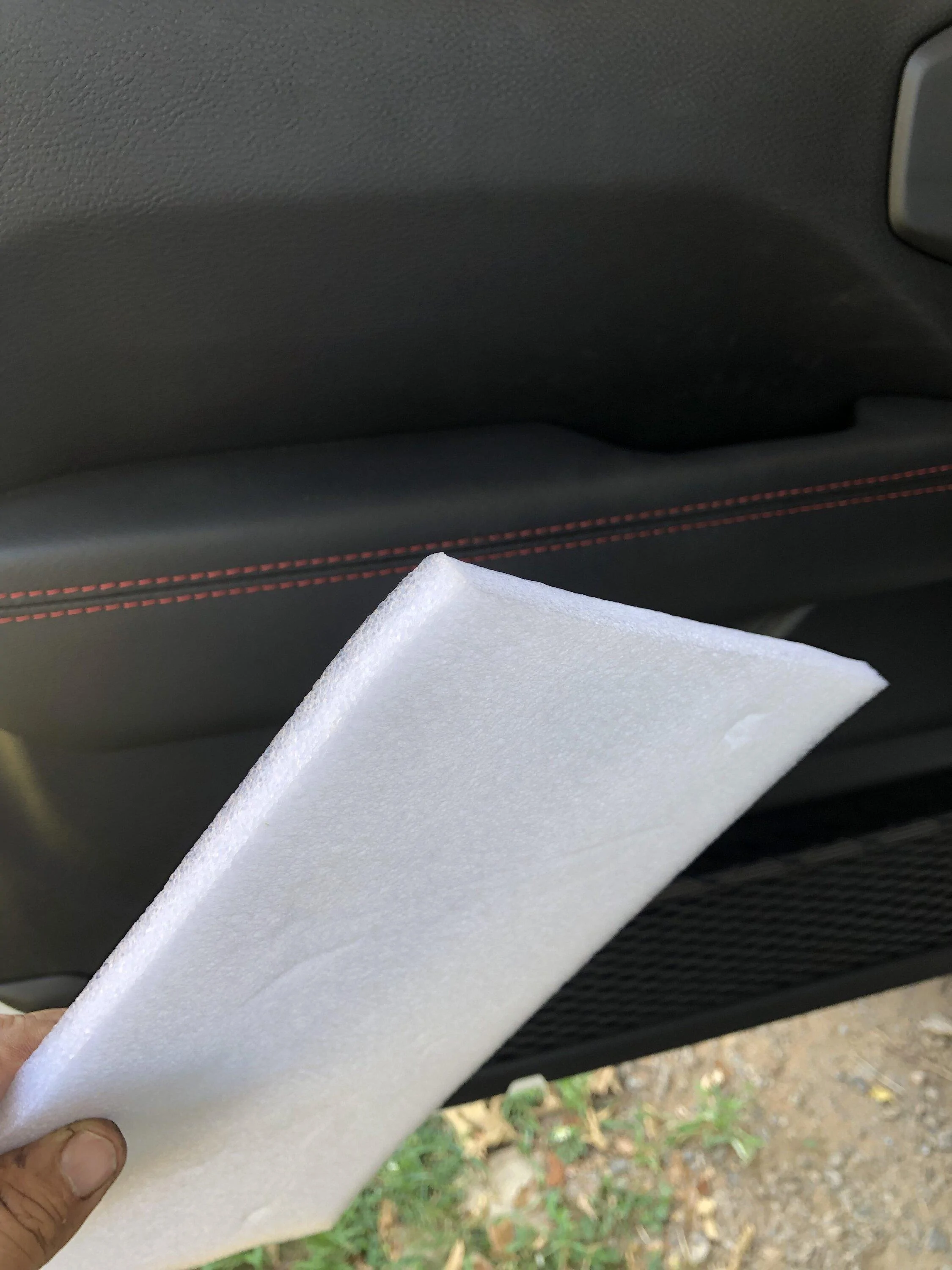

I’m gonna try a piece of foam behind mine. Will report back with results

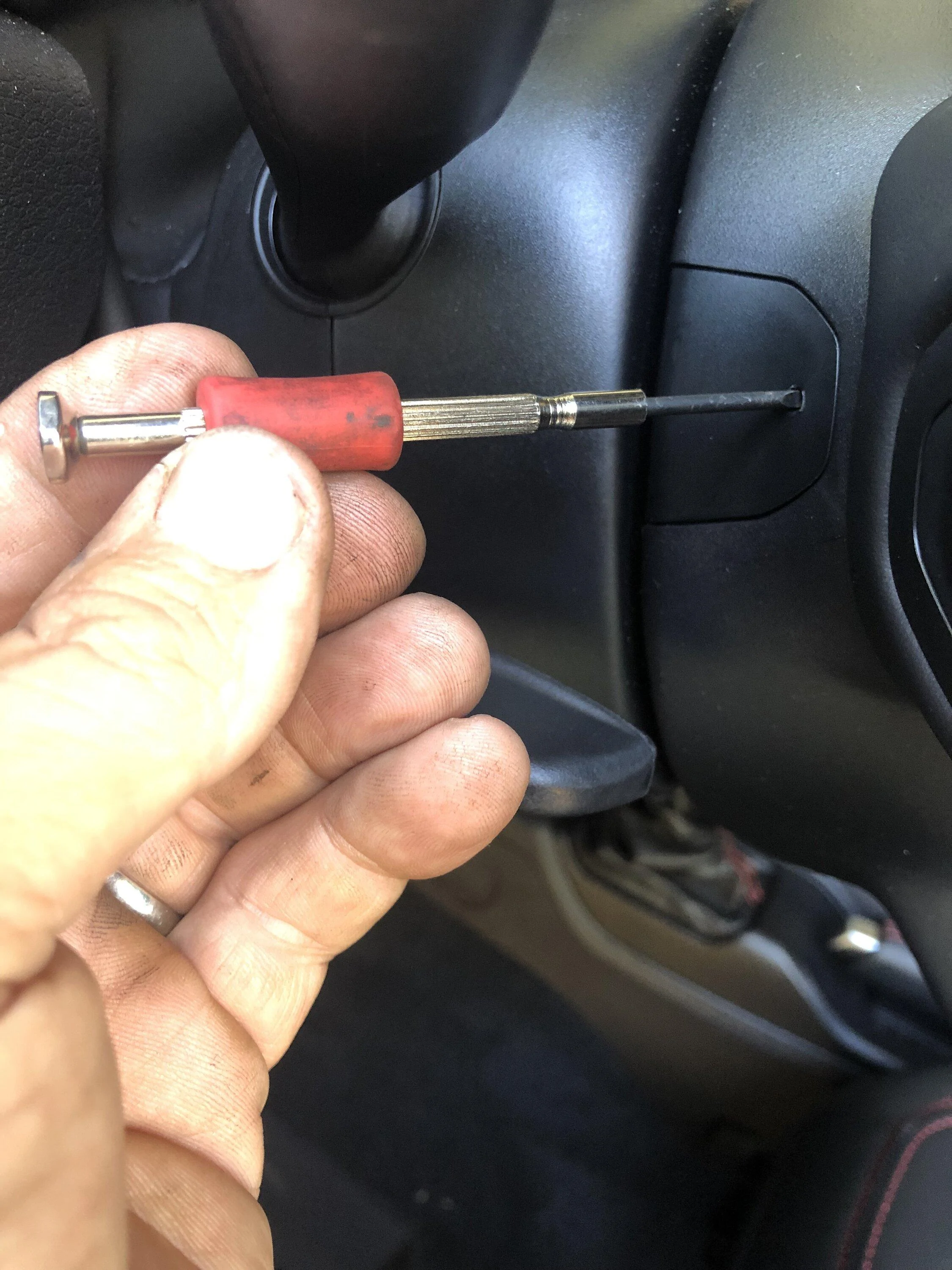

I got mine figured out. First, remove the two snap covers with small screw driver by popping them out

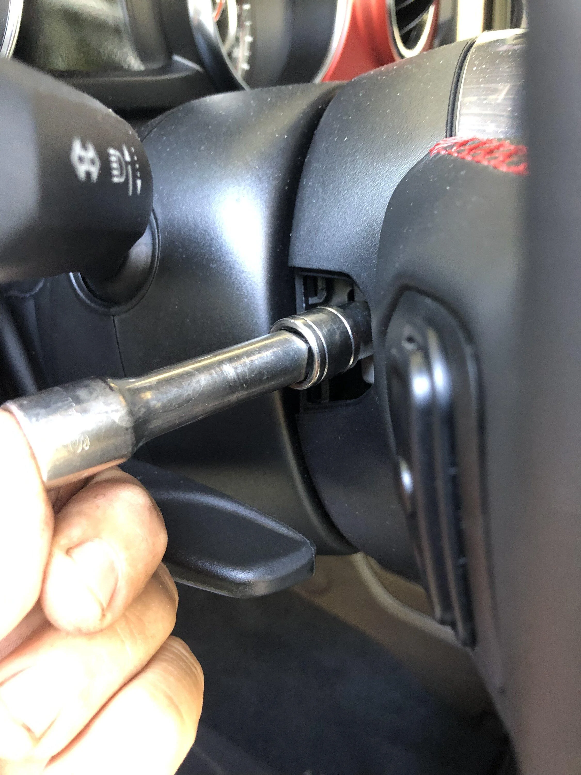

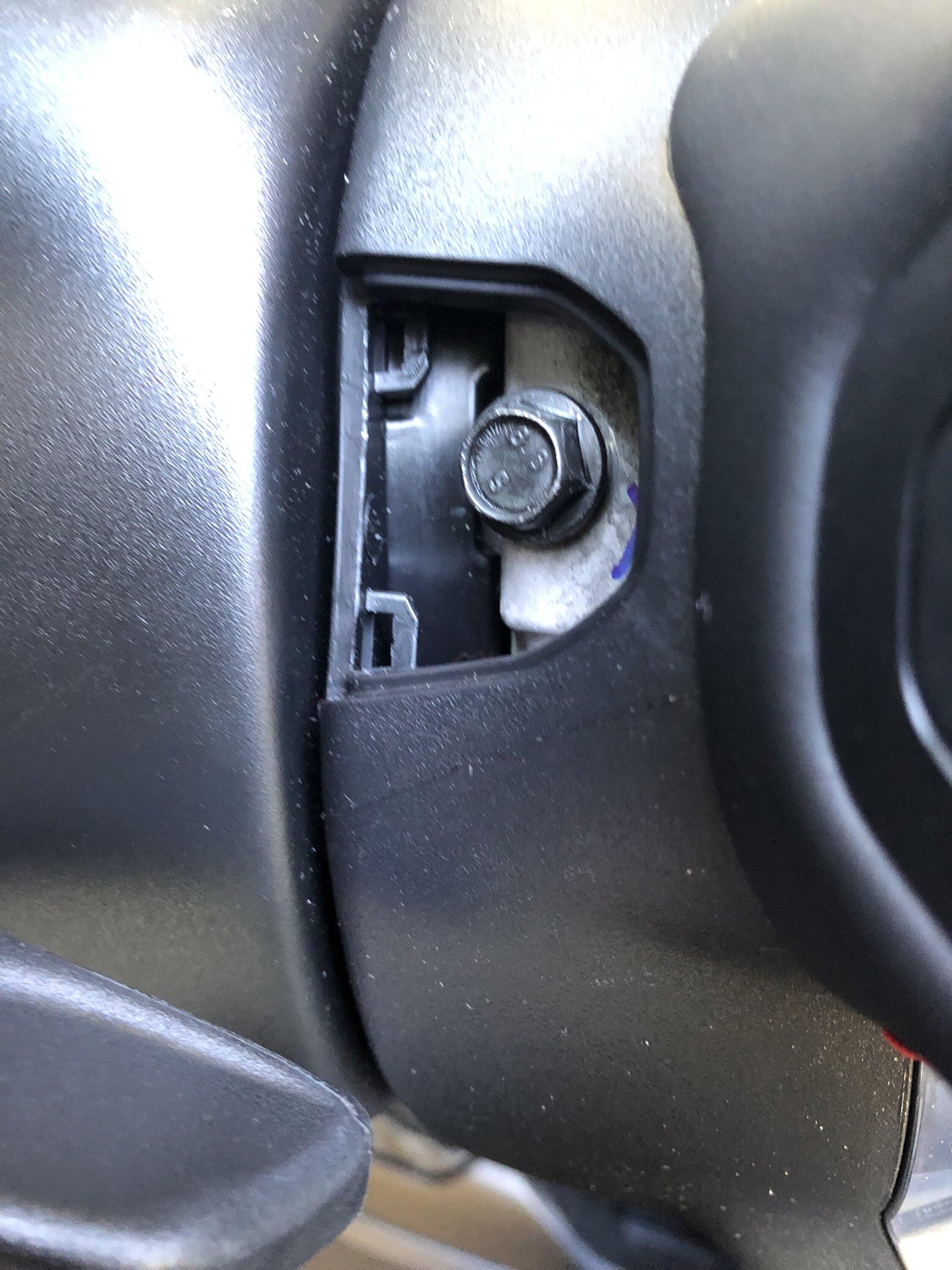

Next, pull the two 10 mm bolts on each side of wheel

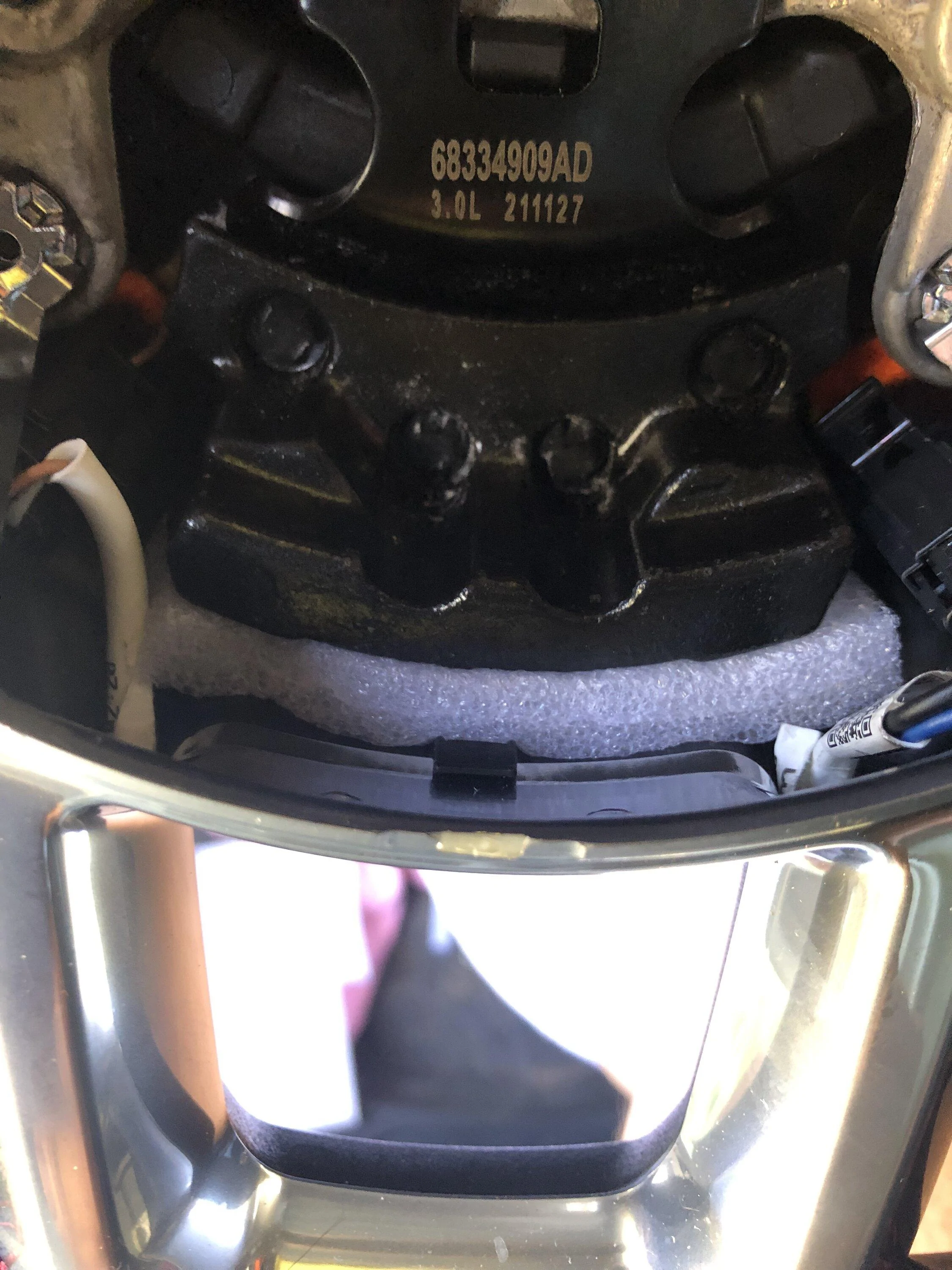

it still made rattle with air bag/horn out of wheel. It was this black piece at bottom of air bag cavity

As you can see at very bottom I shimed it with a piece of shipping foam I had laying around.
