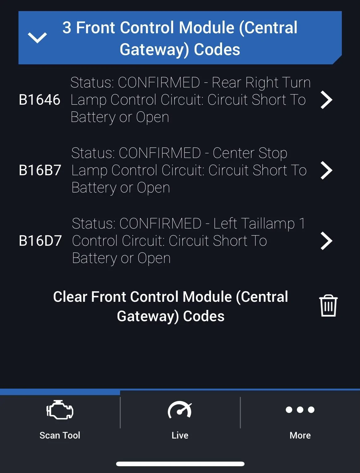

I’m getting an intermittent right rear taillight out message. Each time, all lights appear to work. Then I was told all my right rear lights were out, but I wasn’t getting the message. Got the following codes in the picture. Cleared them, but they came back on the next start.
I bought the truck used and it had a flat tow package on it. I removed it, but left the diodes in place on both rear taillight harnesses.
Thanks for any inputs!

The diodes would be a great place to start looking. Depending on how they spliced into the rear harness, I would inspectfor corrosion or a severed wire.

Thanks! I checked the connections at the diode. Cleaned the contacts. Still happening. Next step is taking out the diodes, I guess
