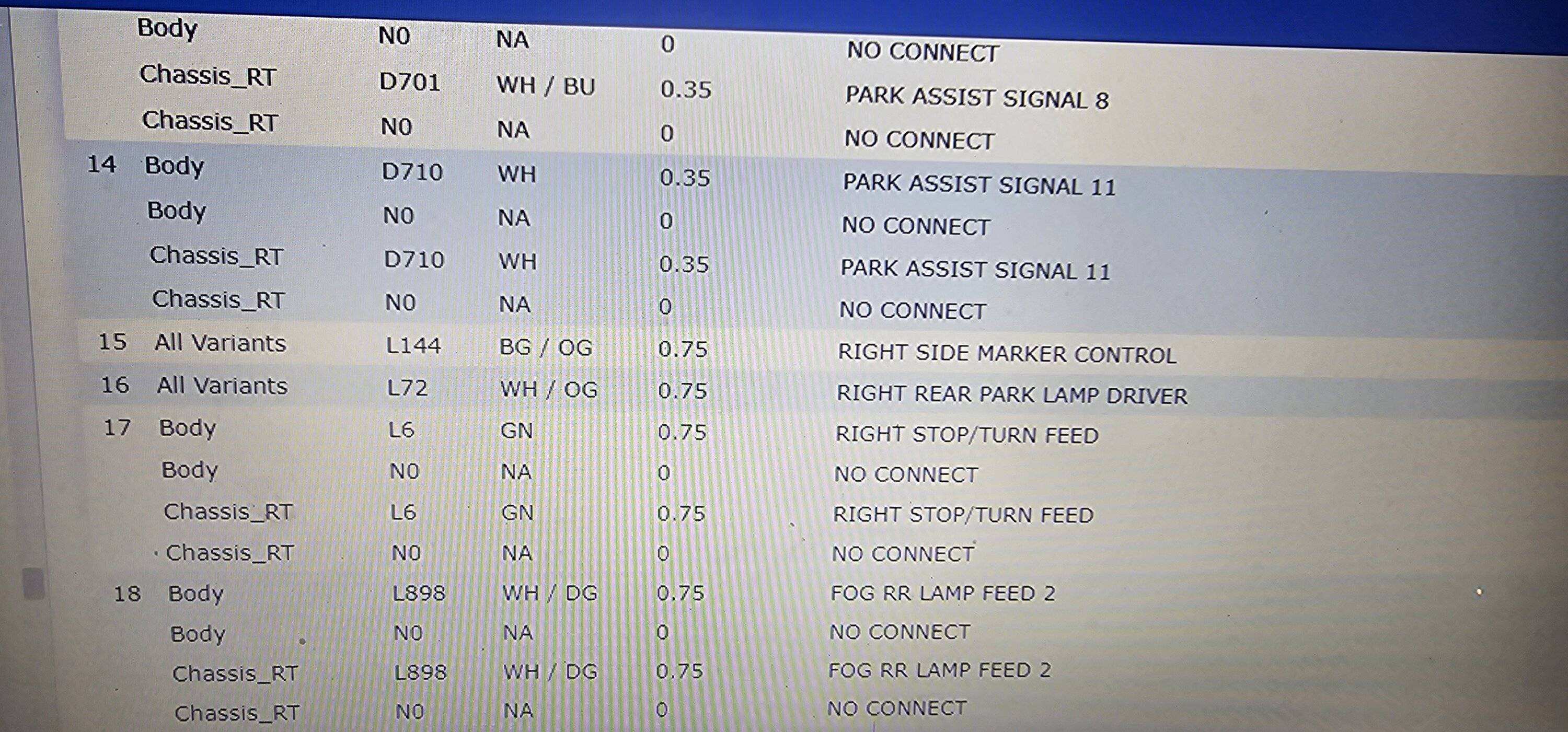

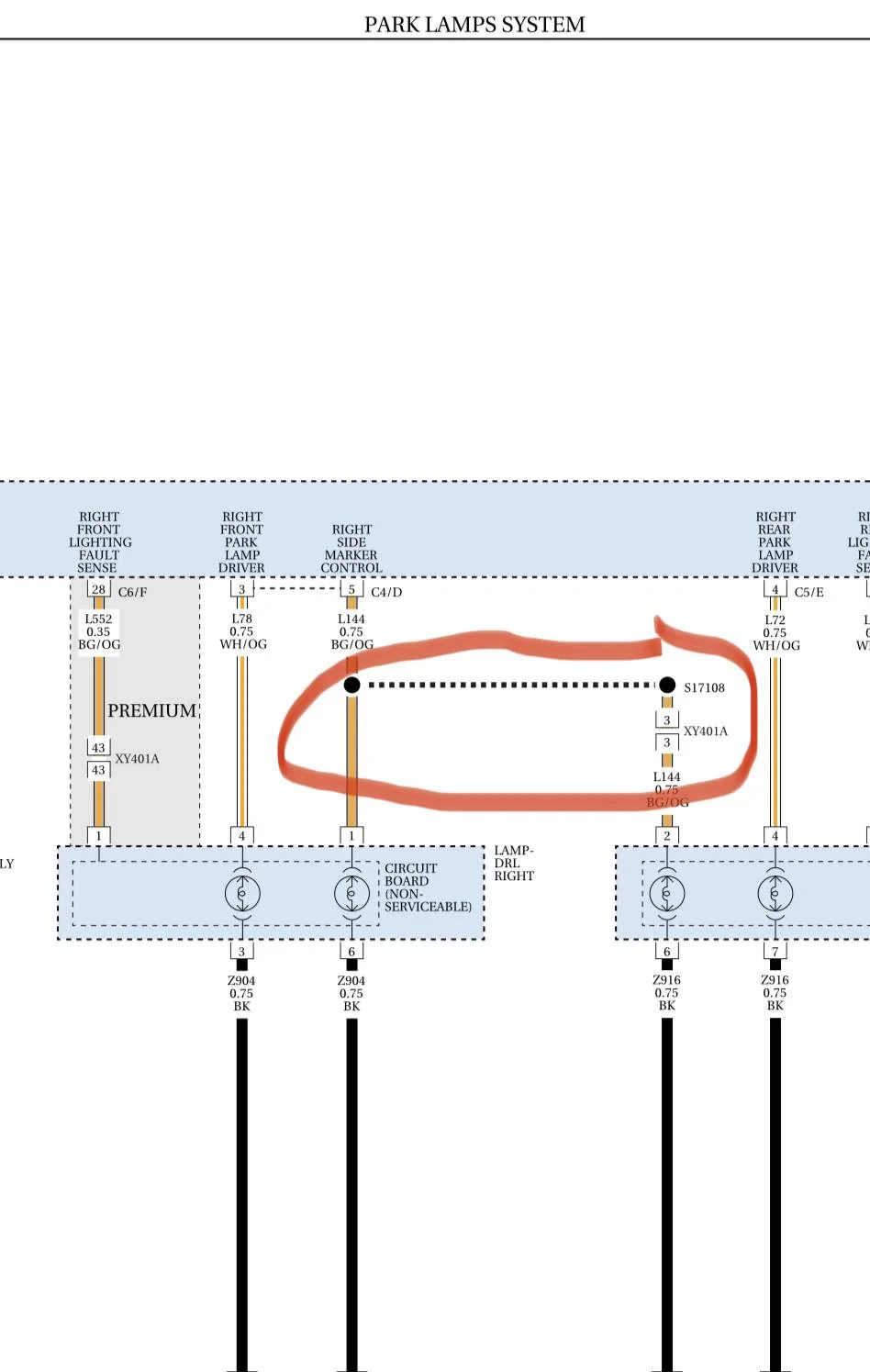

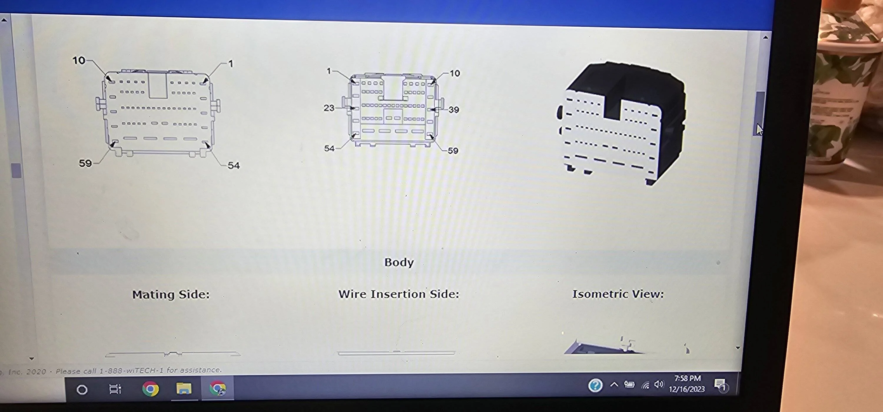

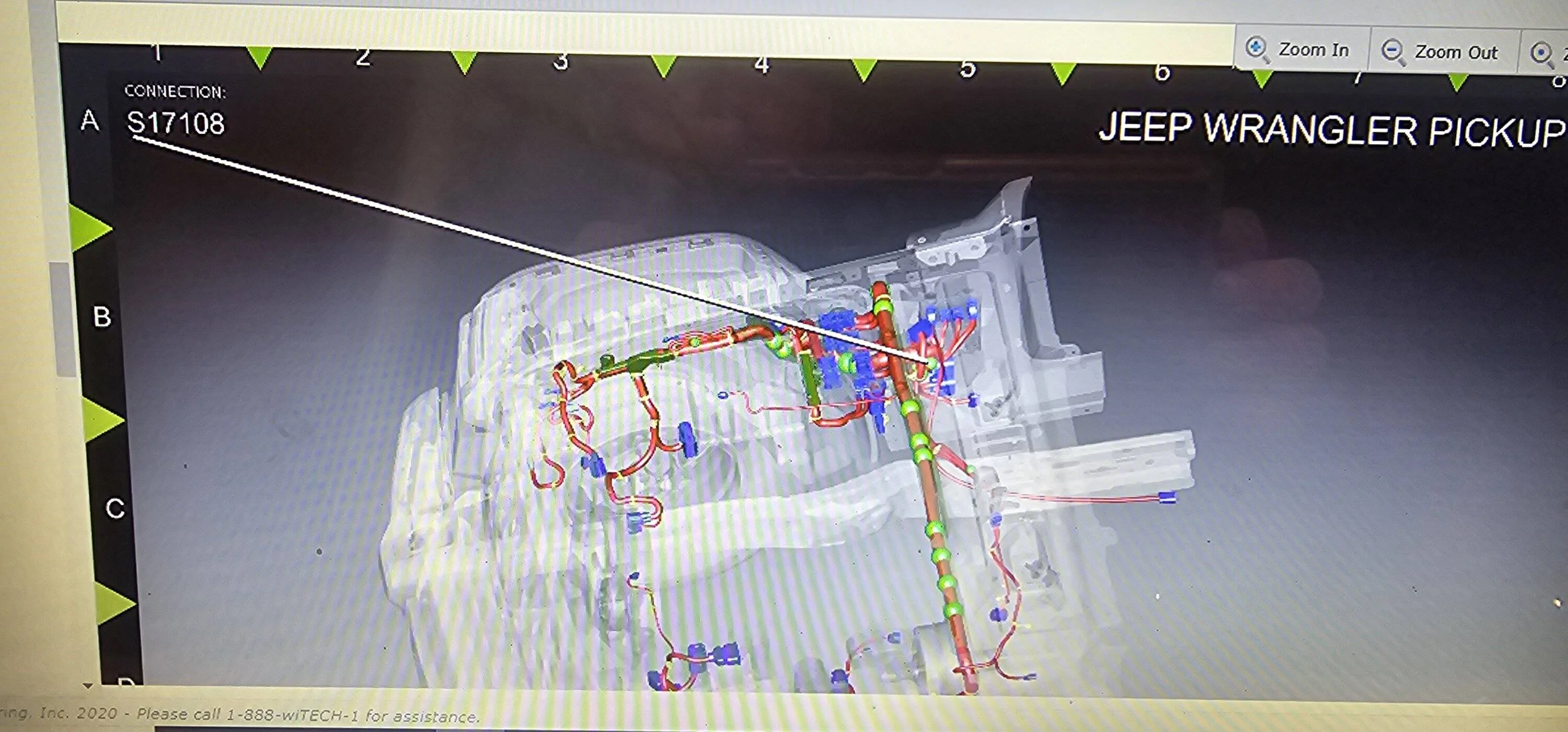

Do you have these on a file you can share - or know where to find them? Because I’ve searched a bunch and all that pops up is the JL ones - not the JT ones you seem to have access to.

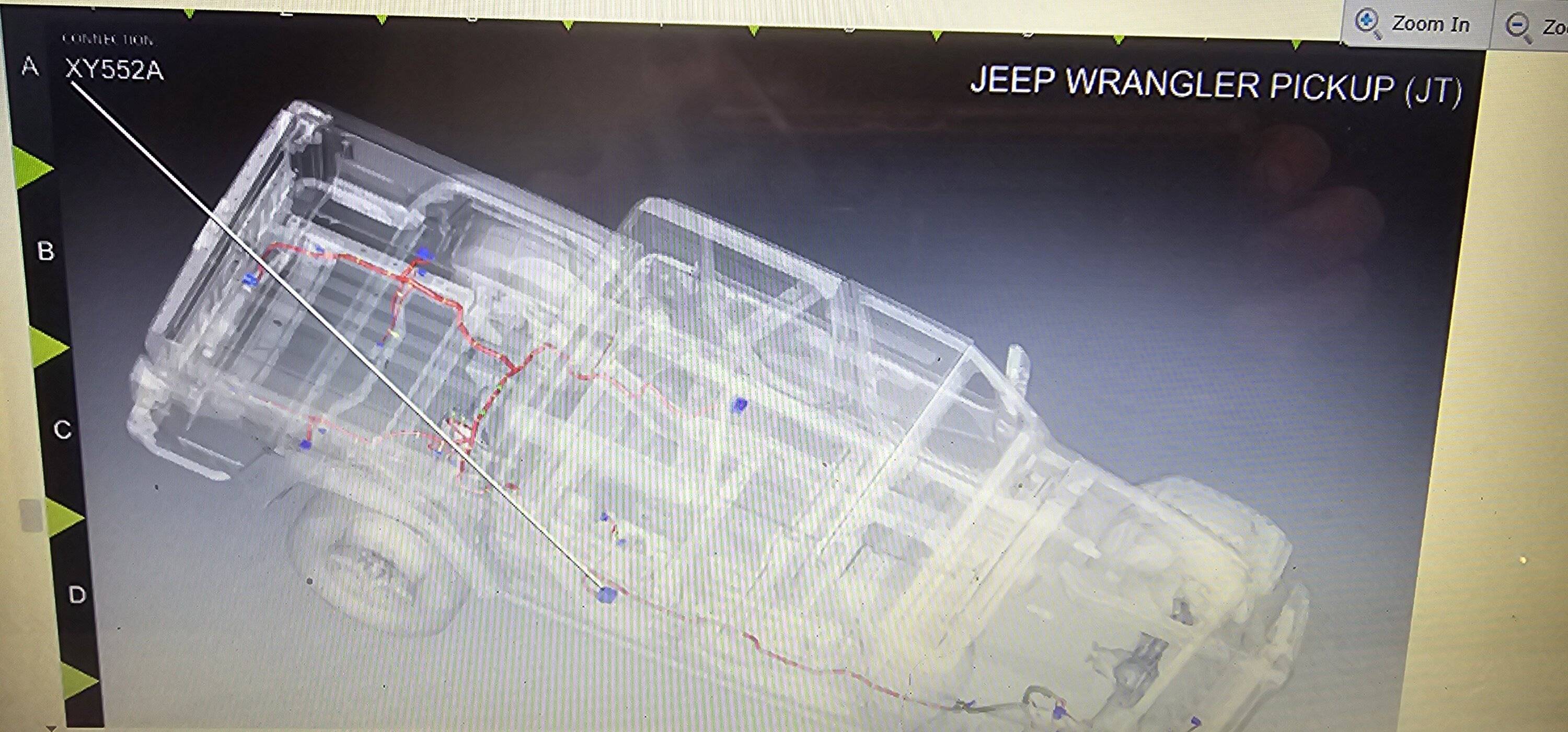

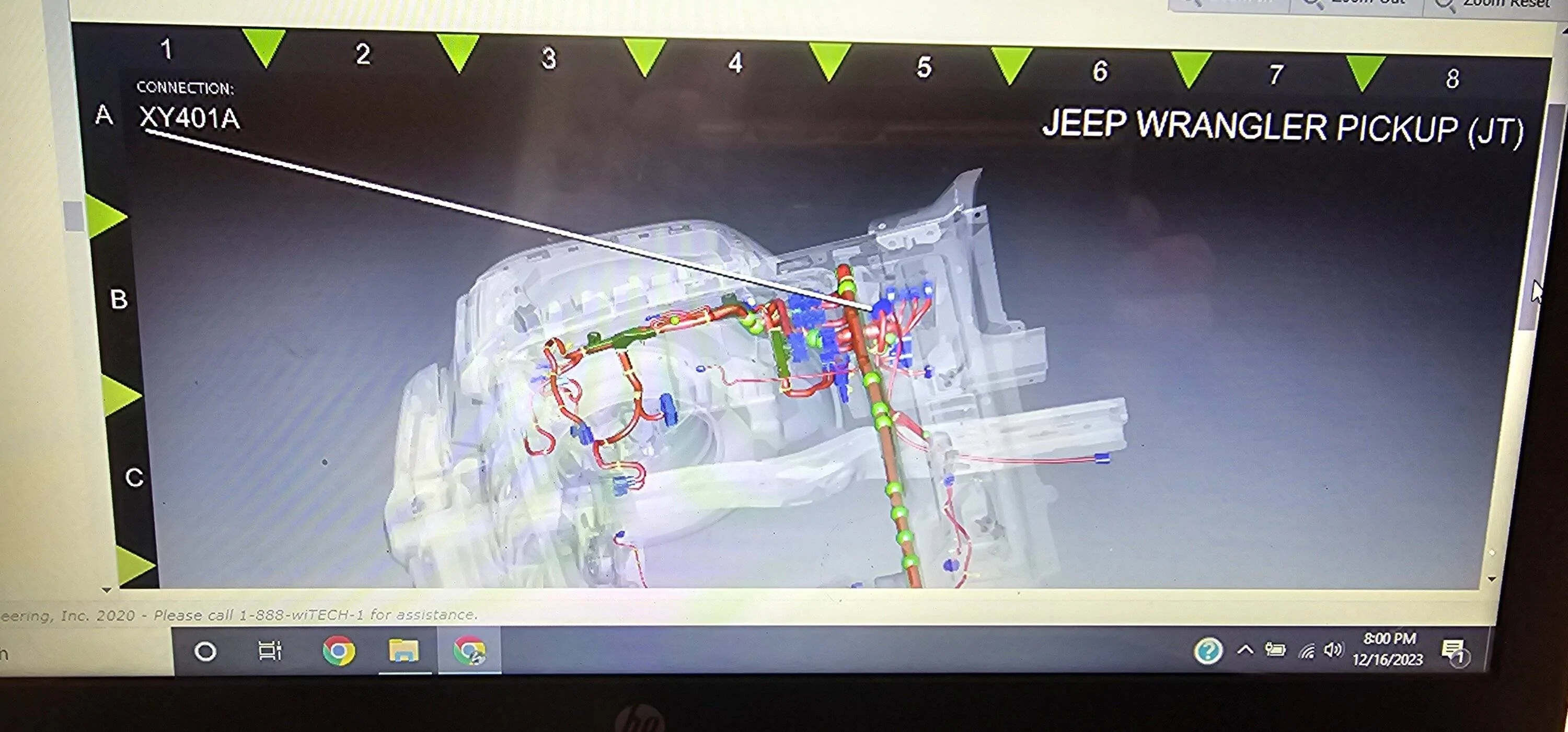

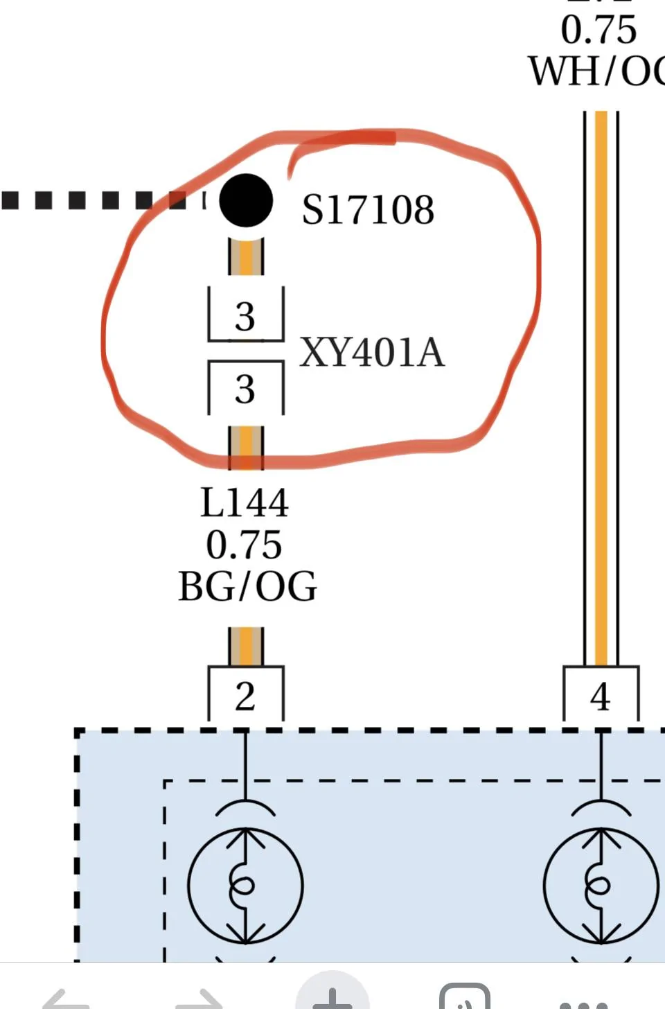

They are all for theJT. It is encrypted and I can't share. The best I can do is send a picture of the screen. I have sent the info on the related connectors . We have bad storms now and last night but I think the pictures went through.
The replies were helpful yes, and can understand you might not be able to directly share them - but still want those files - where did you get them?
