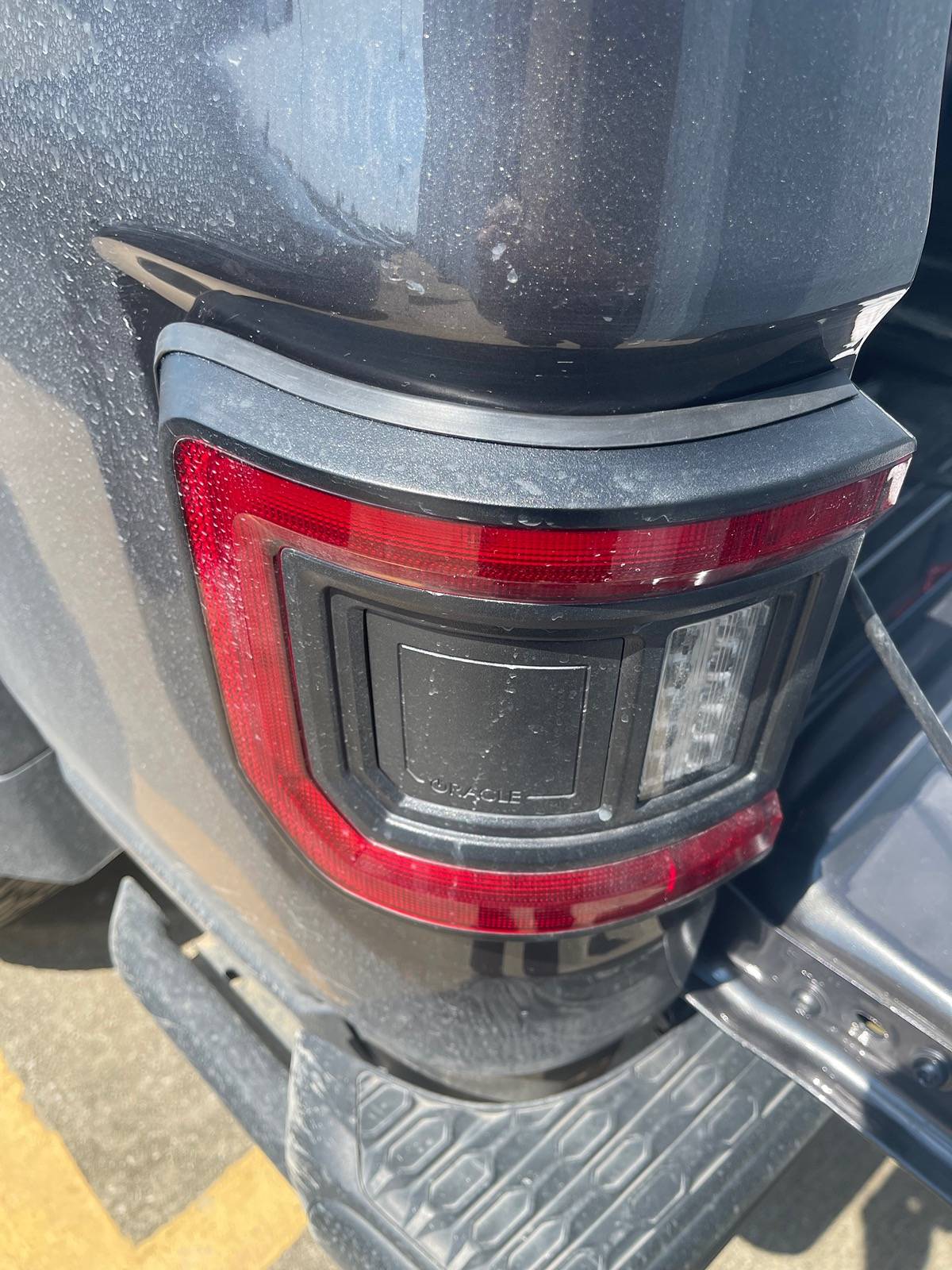

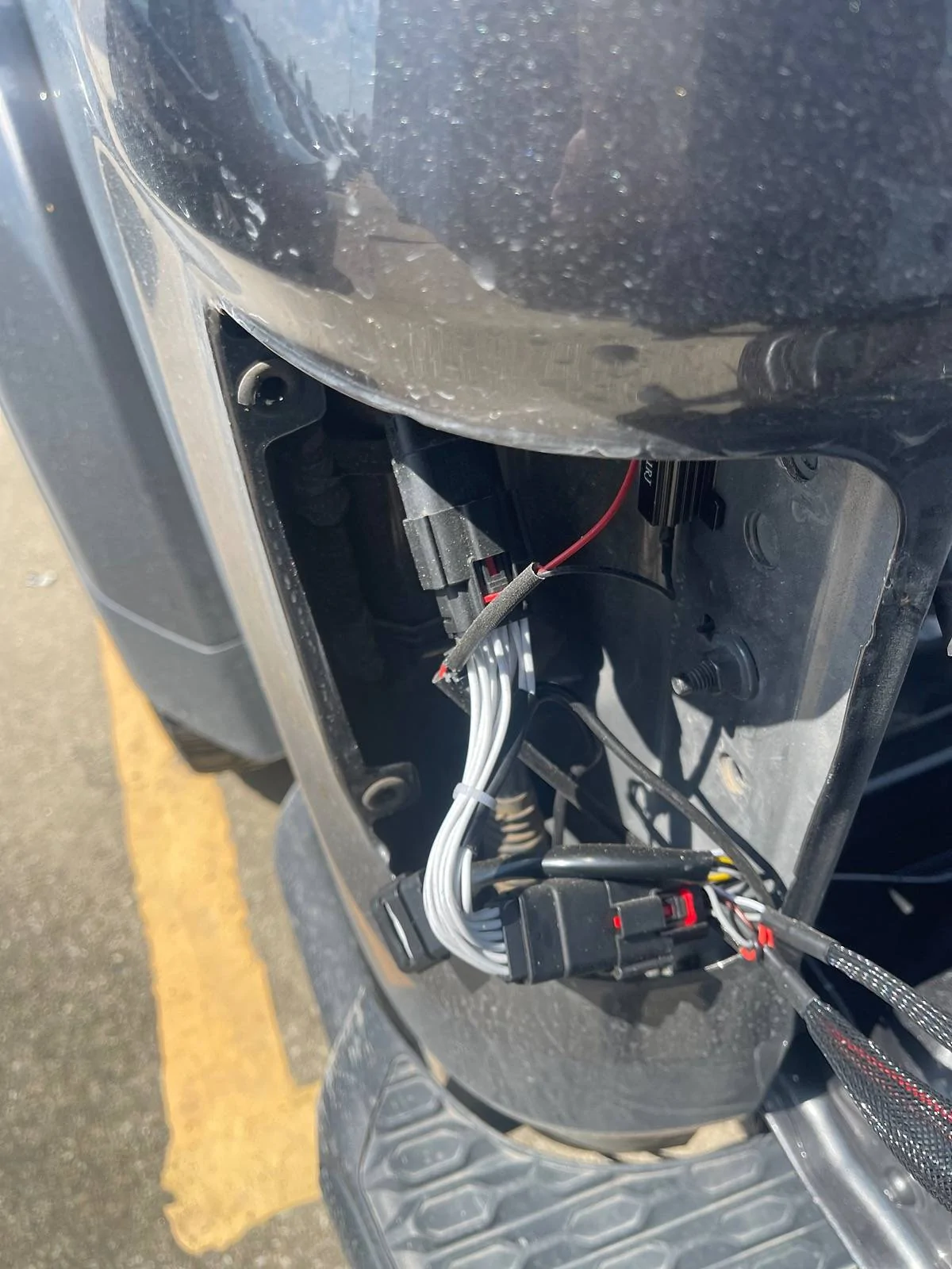

I never had any issues, I put a seal around the outside of the lights. Also used dielectric grease. You can find the seal on Amazon

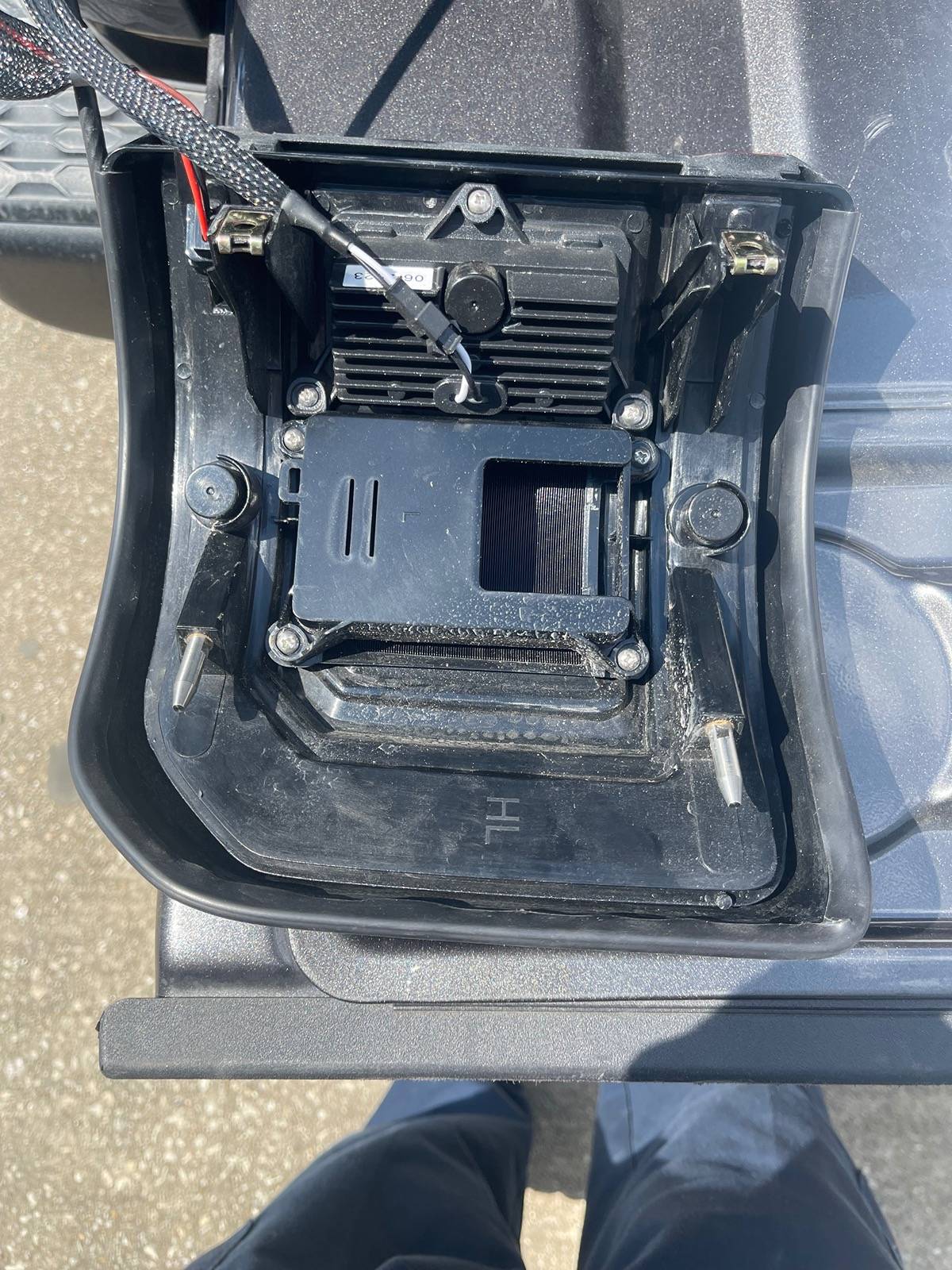

see all that water stain on the back of the light, that's the water from the wheel getting to the back of the light from the holes on that tail light cubby the light mounts too.
once you take the light out you can see huge holes in the back of the jeeps panels, when it rains the water kicks up from the tire getting to the back of the light, I tried dielectric grease and rubber seals like you have and it didn't work until I plugged the holes with 4 inch flex seal tape
just trying to help I have a bunch of replacements over 2 years

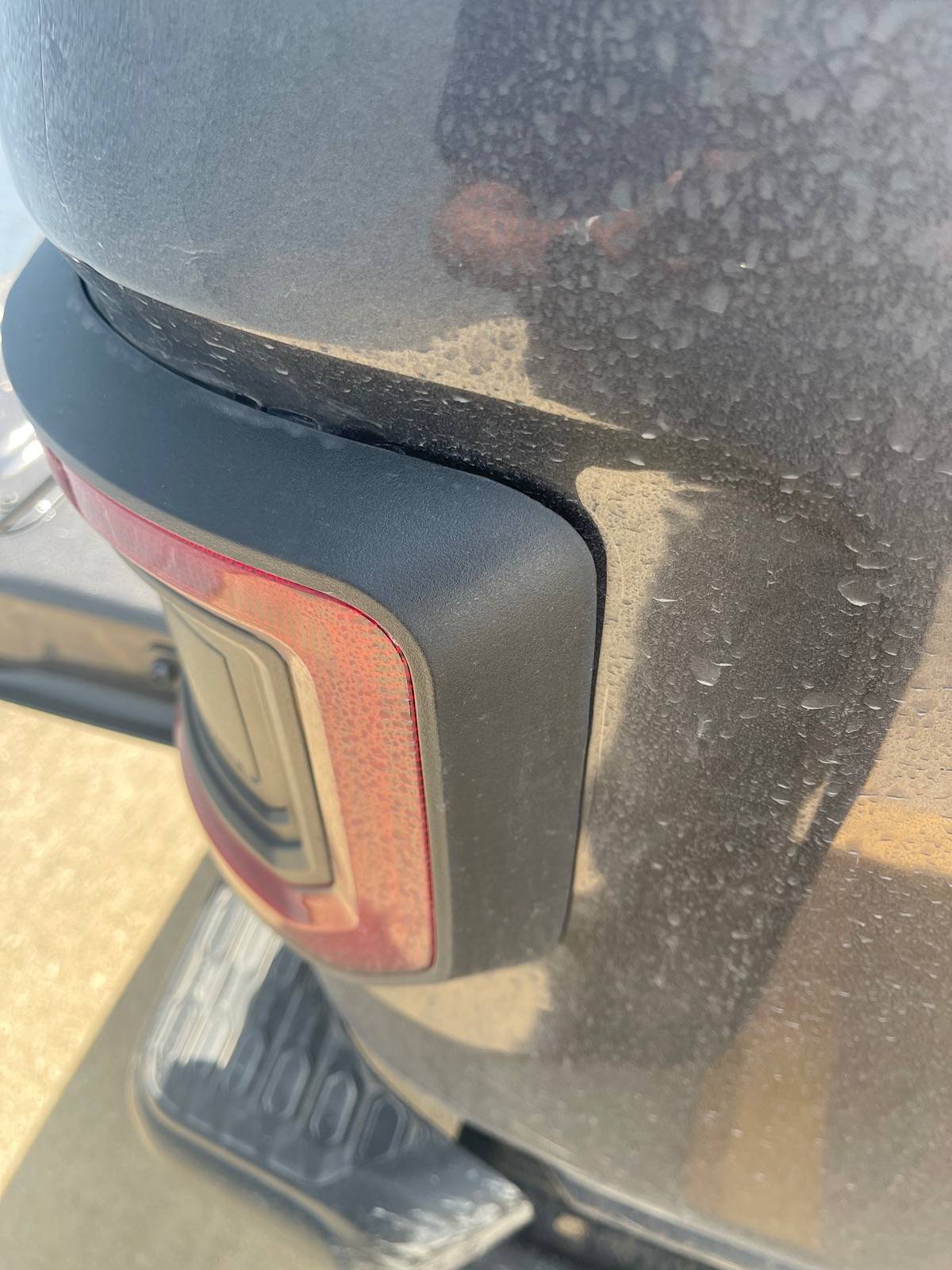

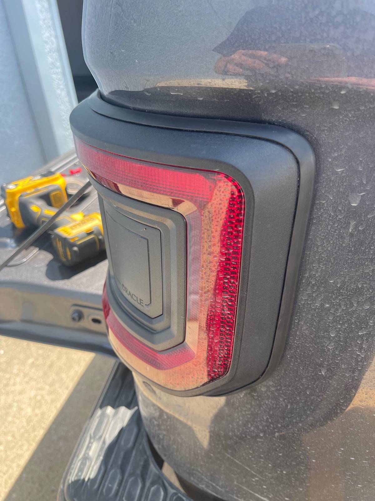

Hello, yes these resistors are now included with the lights.
When it comes to gaps, generally the tail light can be loosened, held where there are no gaps, then re-tightened. This process will eliminate most visible gaps.
