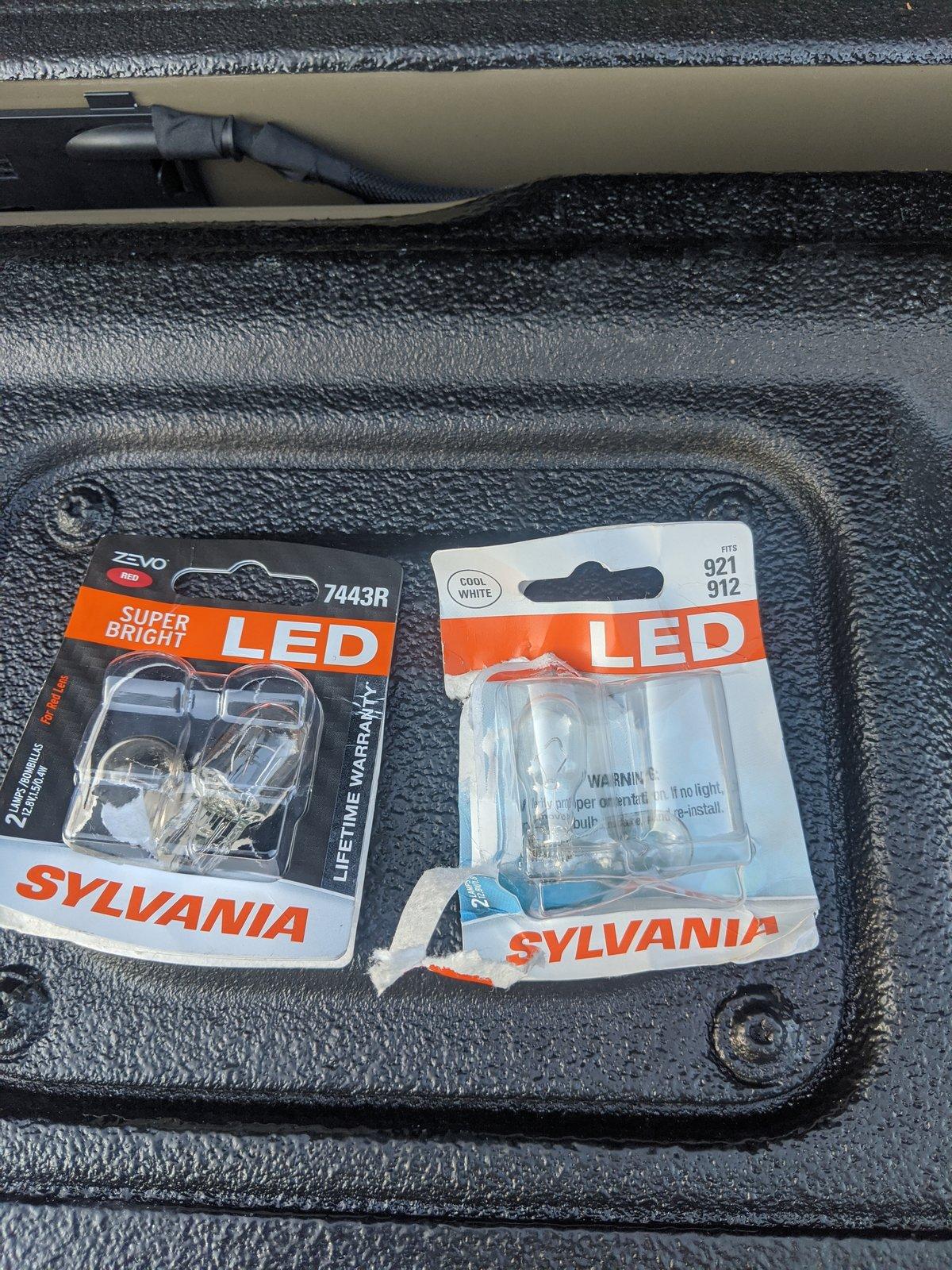

What's the bulb type for the rear taillights. I bought 3157R led bulbs but they don't fit. I think it might be 7443R or something else?

These are the ones you need for reference. 7443R for brake/turn signal and 921 for reverse lights
Jeep Gladiator Rear taillight bulb type IMG_20200829_185340

Just FYSA, it is NOT 3157 as the parts stores say it is.
