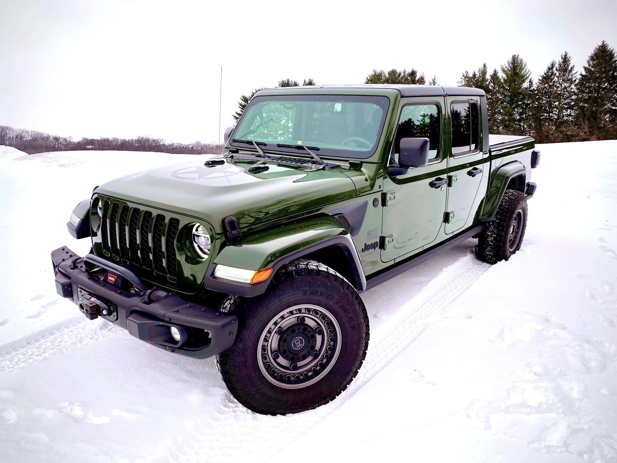

I'm three months and 4000 miles into owning my second Jeep Gladiator after having had the first one bought back from FCA as a lemon. Admittedly I'm super sensitive to any little noise or oddity that my truck makes and the Jeep warning chimes still give me a tad of anxiety every time they make noise. Recently while driving I noticed a slight rubbing noise or feeling that I'd equate to driving over a rumble strip, or a tire tread rubbing against something. This is occurring on flat dry pavement while traveling straight and level usually at highway speeds. This noise or feeling only lasts a tenth of a second or less, and I can't put any pattern to it, or even tell if it's actually coming from my truck or if it's 100% me being paranoid.
The only modifications I've done are swapping out wheels and tires, and having a reputable 4x4 shop install 1.5 front level kit. Upon inspection I can see no evidence of the tire rubbing against anything, there's no oil leaks present, and nothing appears to be hotter than expected for normal driving.
Any thoughts? Am I losing it, or are these possible symptoms that I have something starting?
