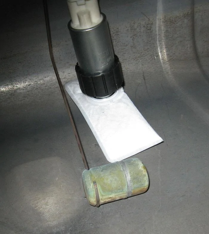

here's the gas tank inside view of my SX4 - 40 years old, some of that time it sat for weeks or longer, and I run 10%.
your rebuttal and break down of that article was an excellent read and incredibly interesting facts. I felt that article was very one sided and used pseudo-science to lend itself favor. Kudos my fellow gladiator owner!
