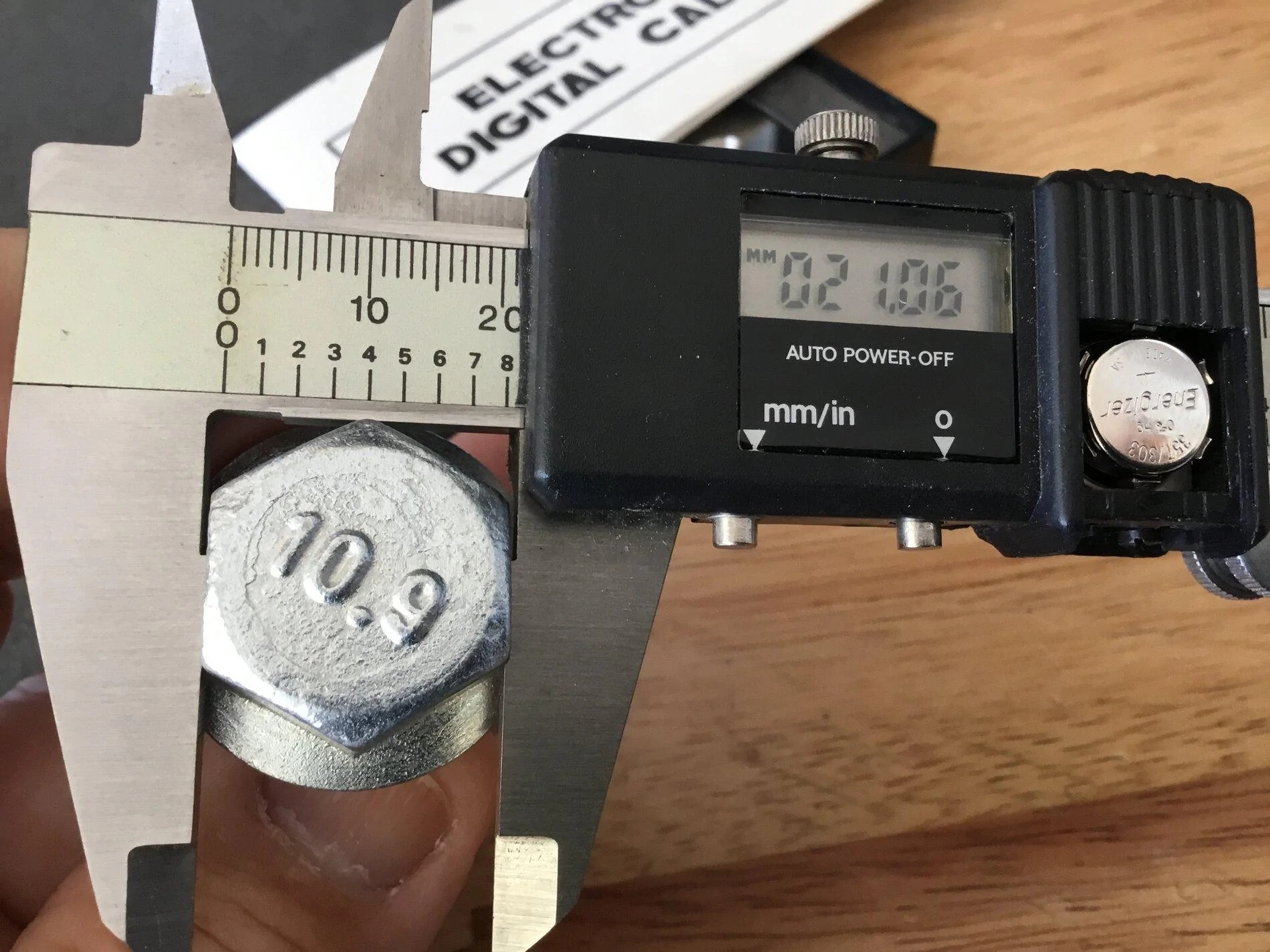

As this was in all likelihood a metric bolt, and you would now know the correct size - maybe if you haven't, post that up so in case someone wants to put a spare in the console.....
Mxxxxx class 10.9 (even though everyone mentions grade 8, metric are hardened and marked with a class)

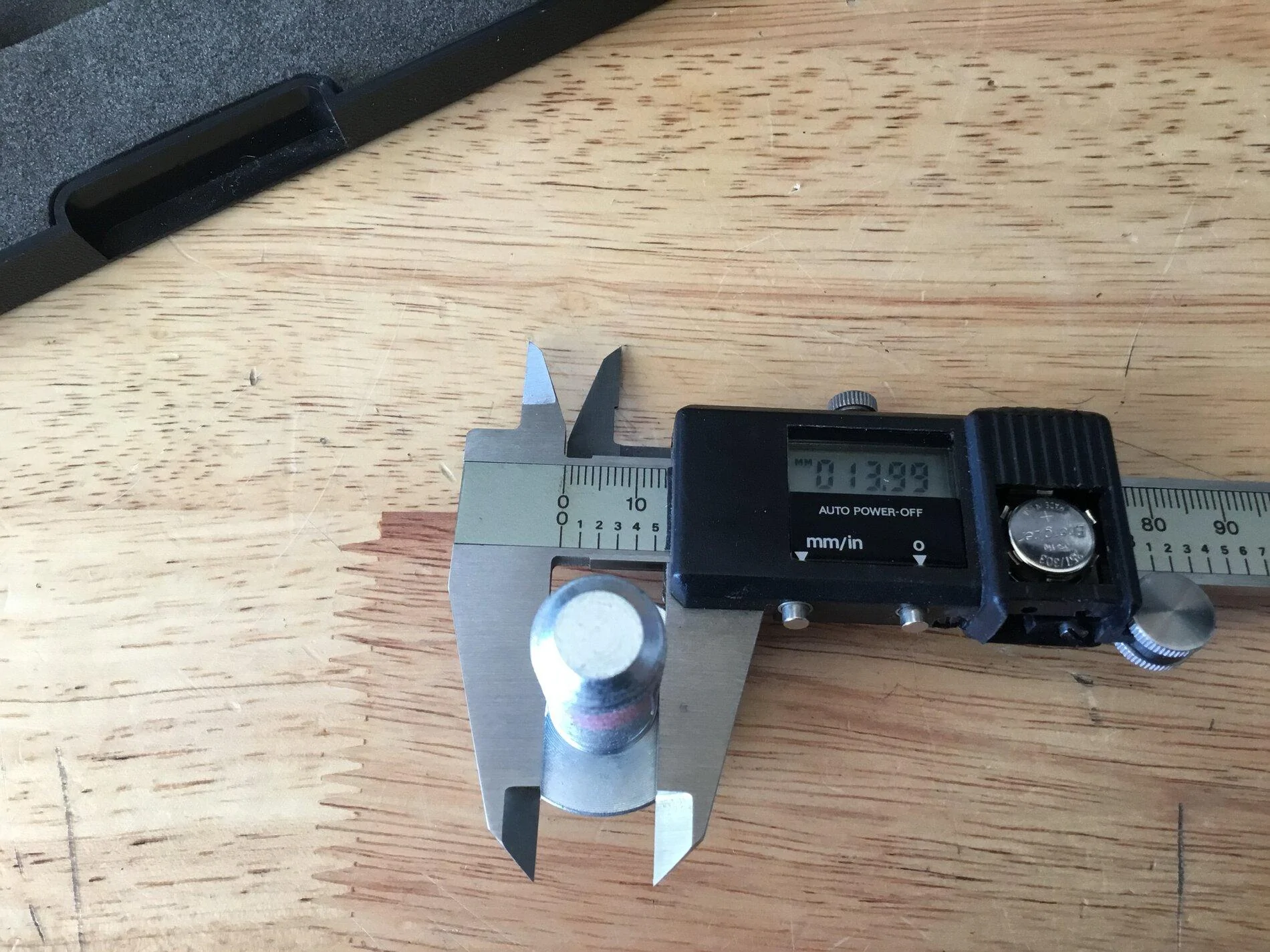

Just going off memory, I’ll have to double check but it’s an M14 1.50 pitch fine thread. 23mm or 21mm head. Half inch diameter and 1 - 3/8” long?

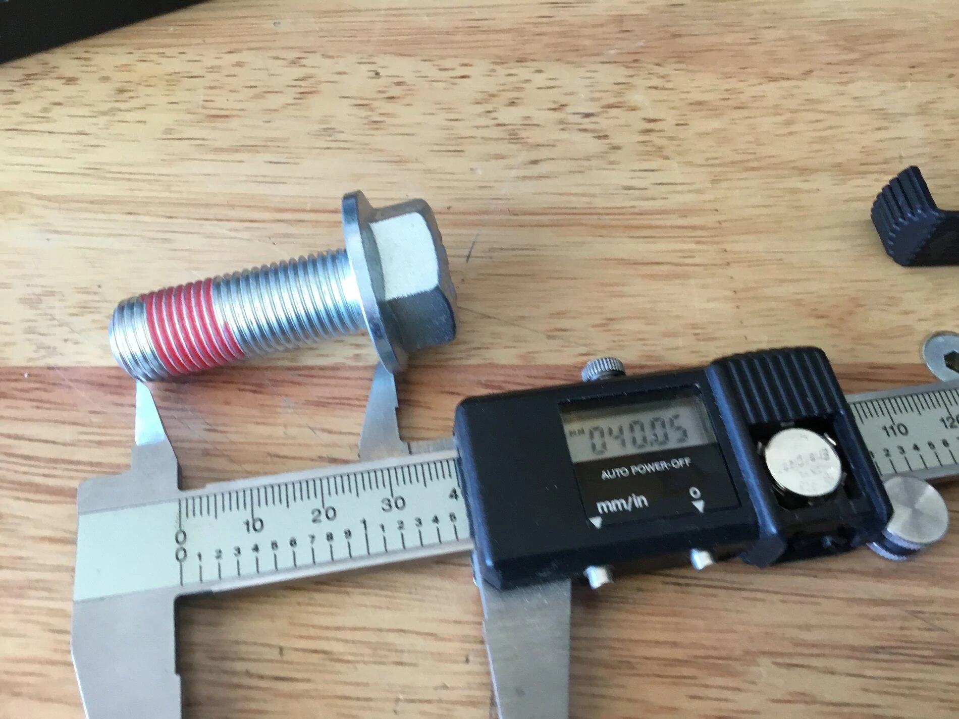

Just going off memory, I’ll have to double check but it’s an M14 1.50 pitch fine thread. 23mm head. Half inch diameter and 1 - 3/8” long.
JK uses the same bolt apparently.
For the on-lookers ->
M14 is 14 mm diameter.
1.5 is 1.5 mm between the peak of one thread to the peak of the next - the thread pitch.
SAE is measured in threads per inch, metric is peak to peak or valley to valley in mm.
Sounds like it's 35mm long so it would be M14 1.5 x 35mm

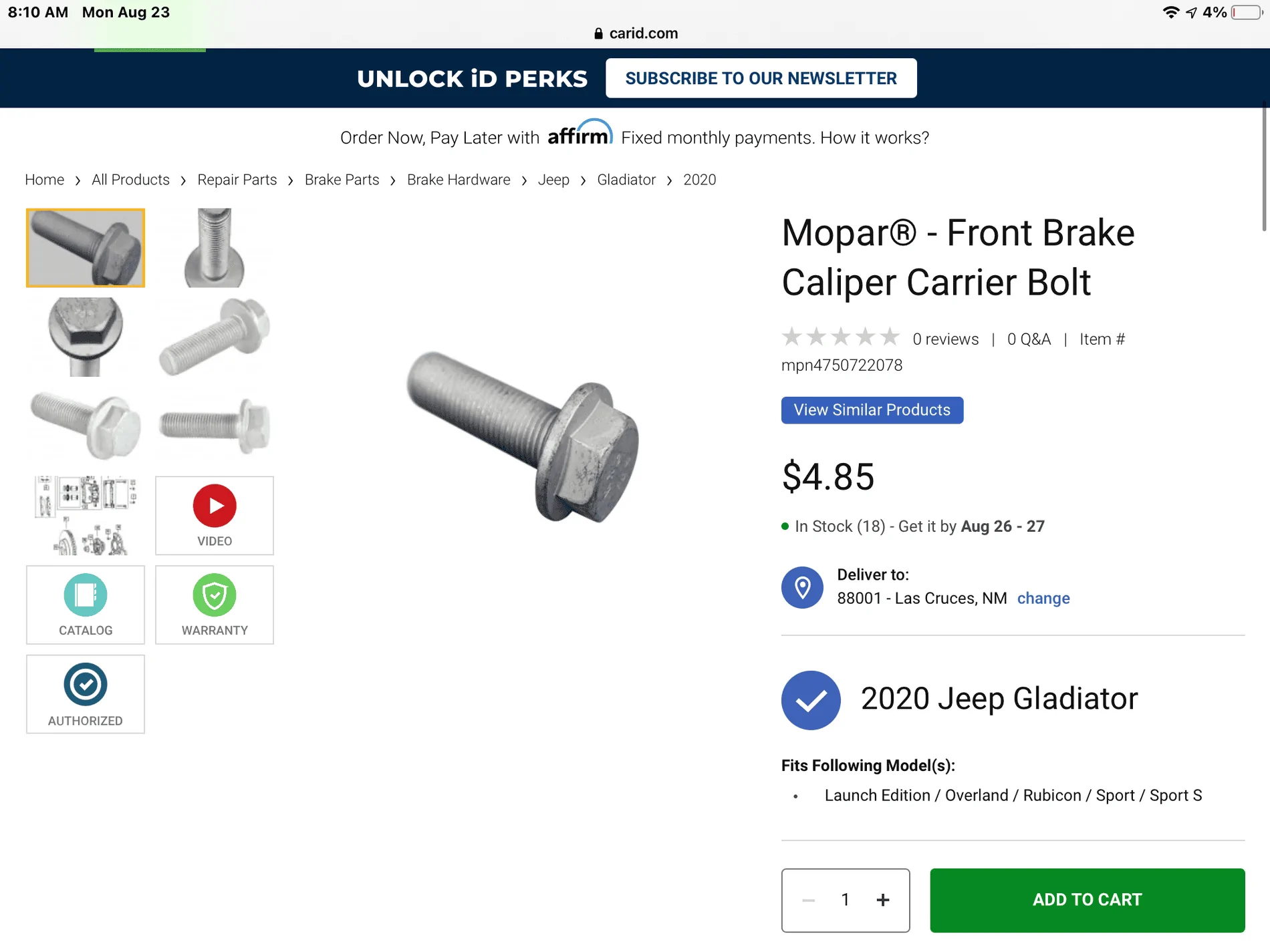

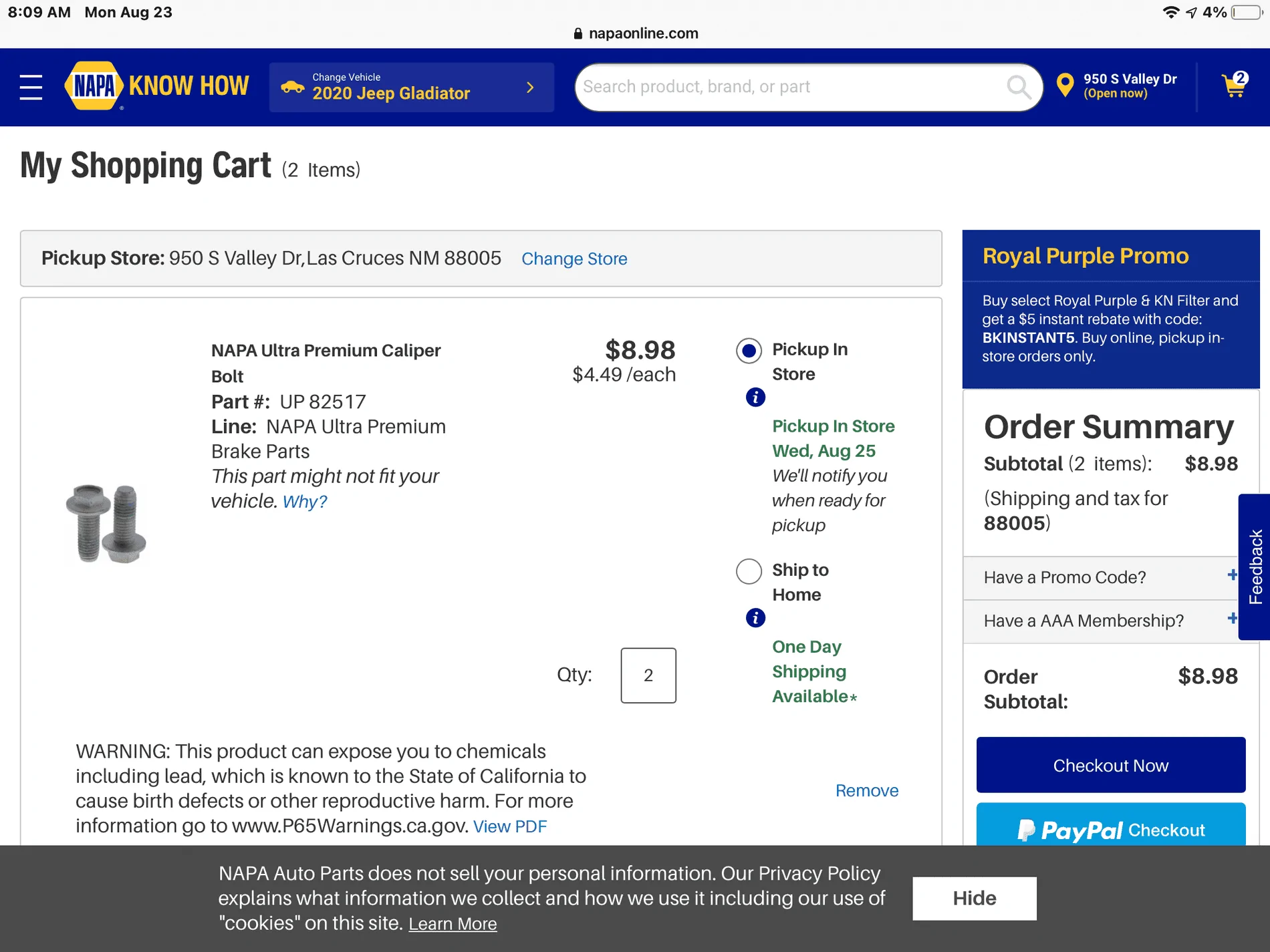

Just found this one. It says it fits JL and JT. Which makes even more sense to me actually.
It’s really frustrating because they don’t list dimensions. The only place that gave me anything with dimensions on it was a guy at Oreilly Auto Parts. He printed it out for me. I don’t know what I did with it, that’s why I’m going on memory but if I find it I’ll post it.
https://www.quadratec.com/p/mopar/front-caliper-knuckle-bolt-jeep-jl-jt-06104258AA
Thanks!
Ordered 2 to stick in the SHTF bag.
$20 of insurance to avoid a really long walk!

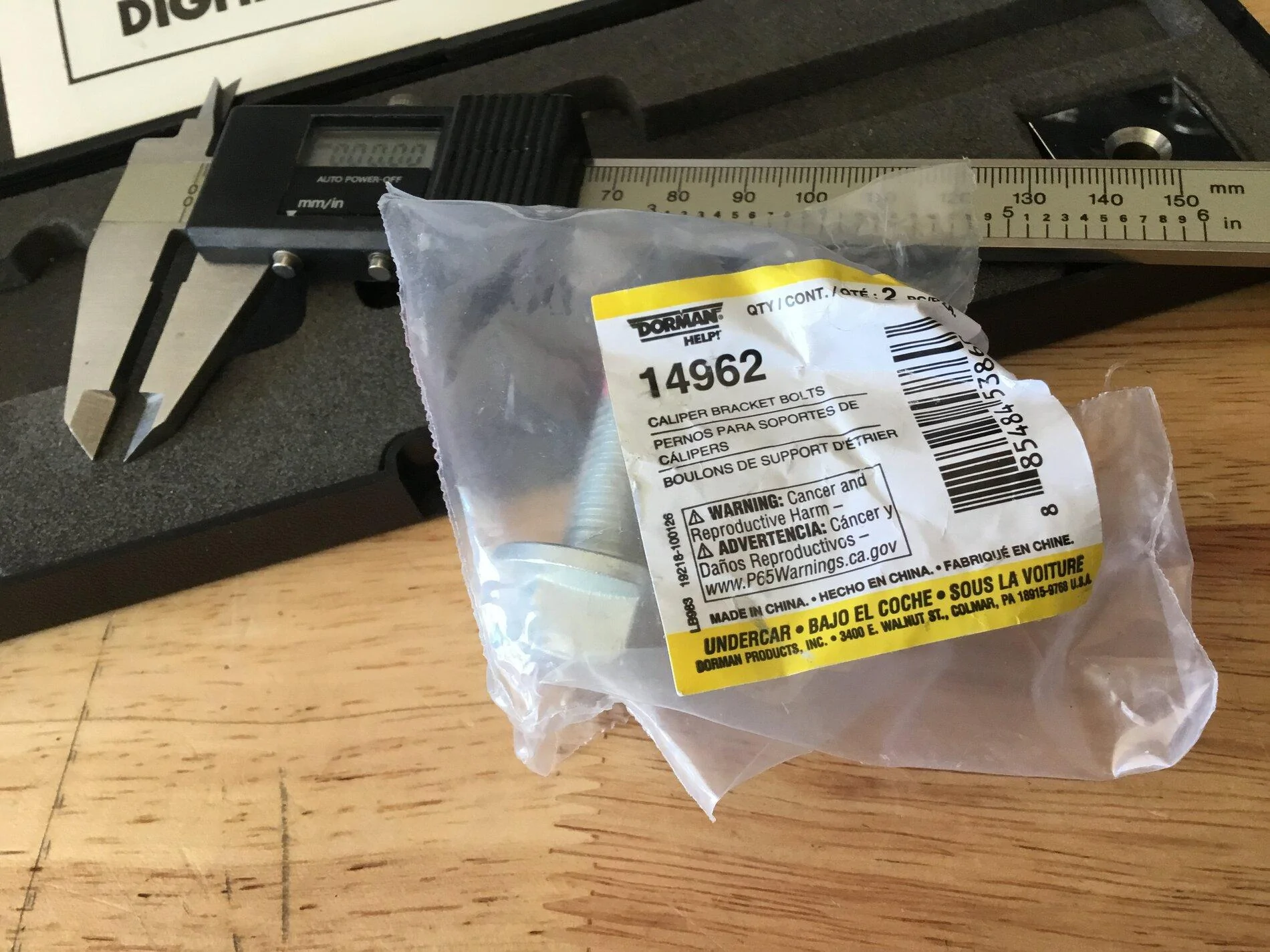

Found it:
Thanks!
A little while ago I found a thread where a guy used a piece of whittled down wood to just get himself out of some rough stuff and back to civilization. I’ll admit the thought crossed my mind too but there wasn’t any wood available Where I was at.

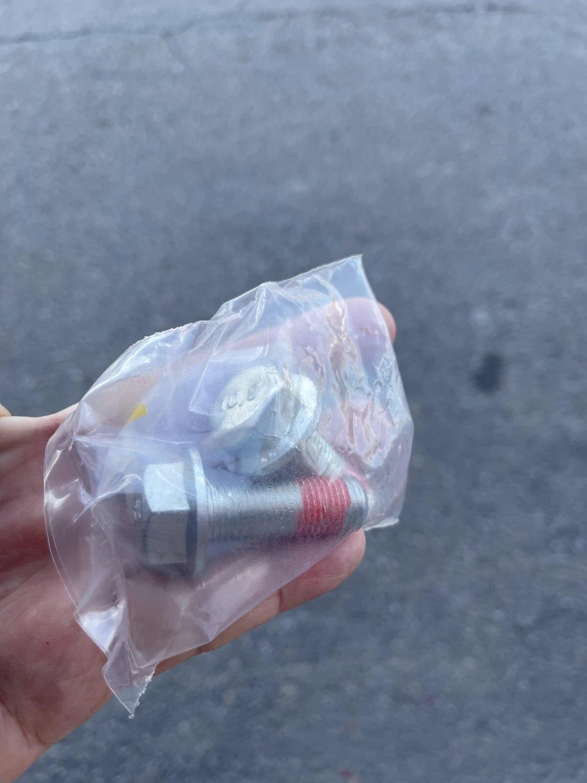

Couldn’t find the print out so I went direct:
