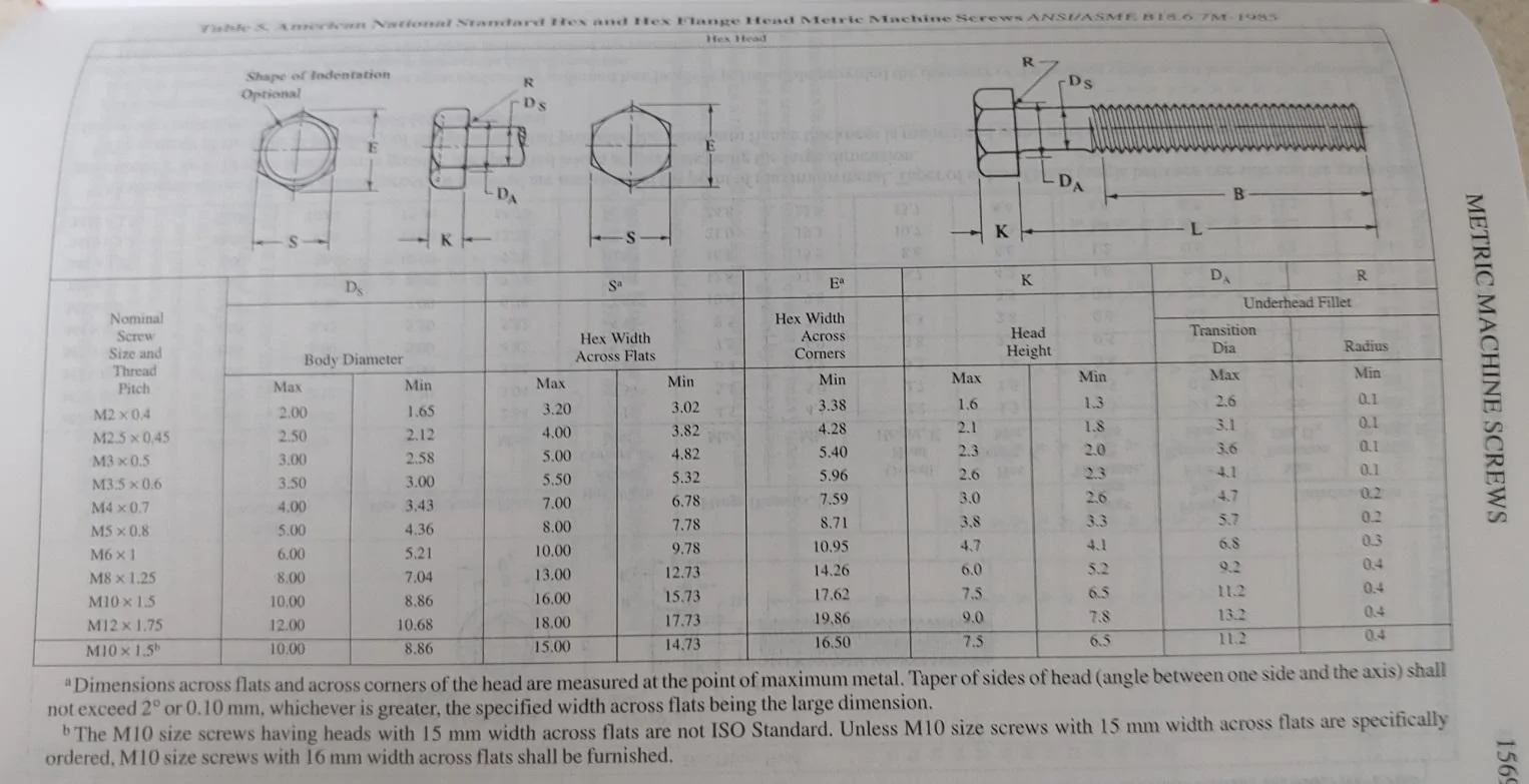

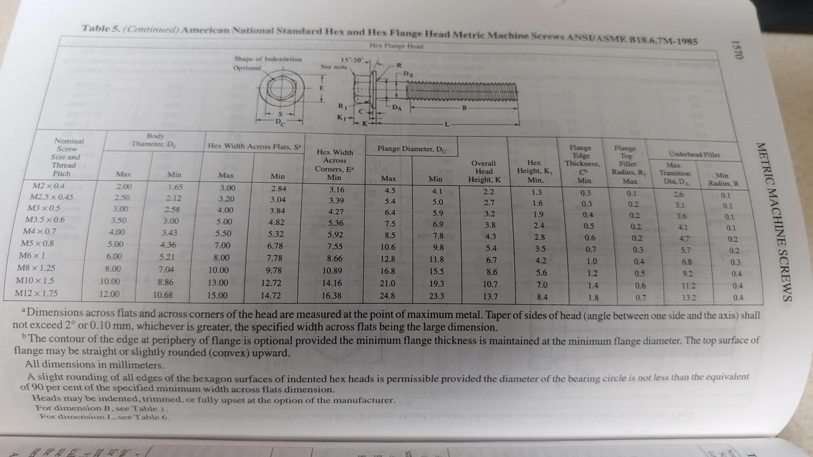

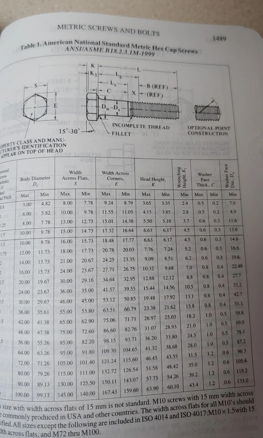

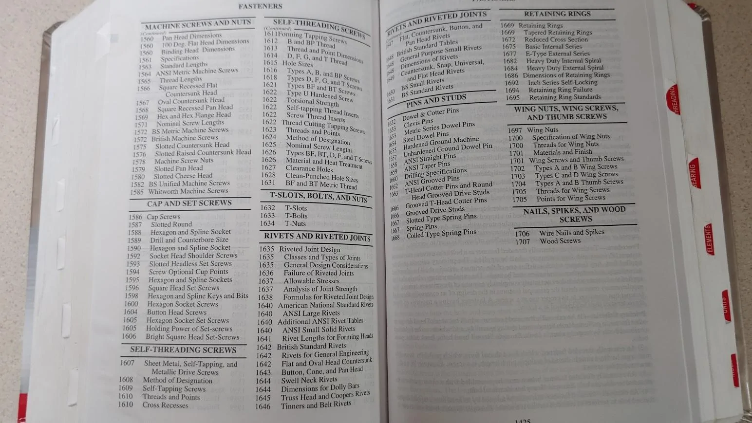

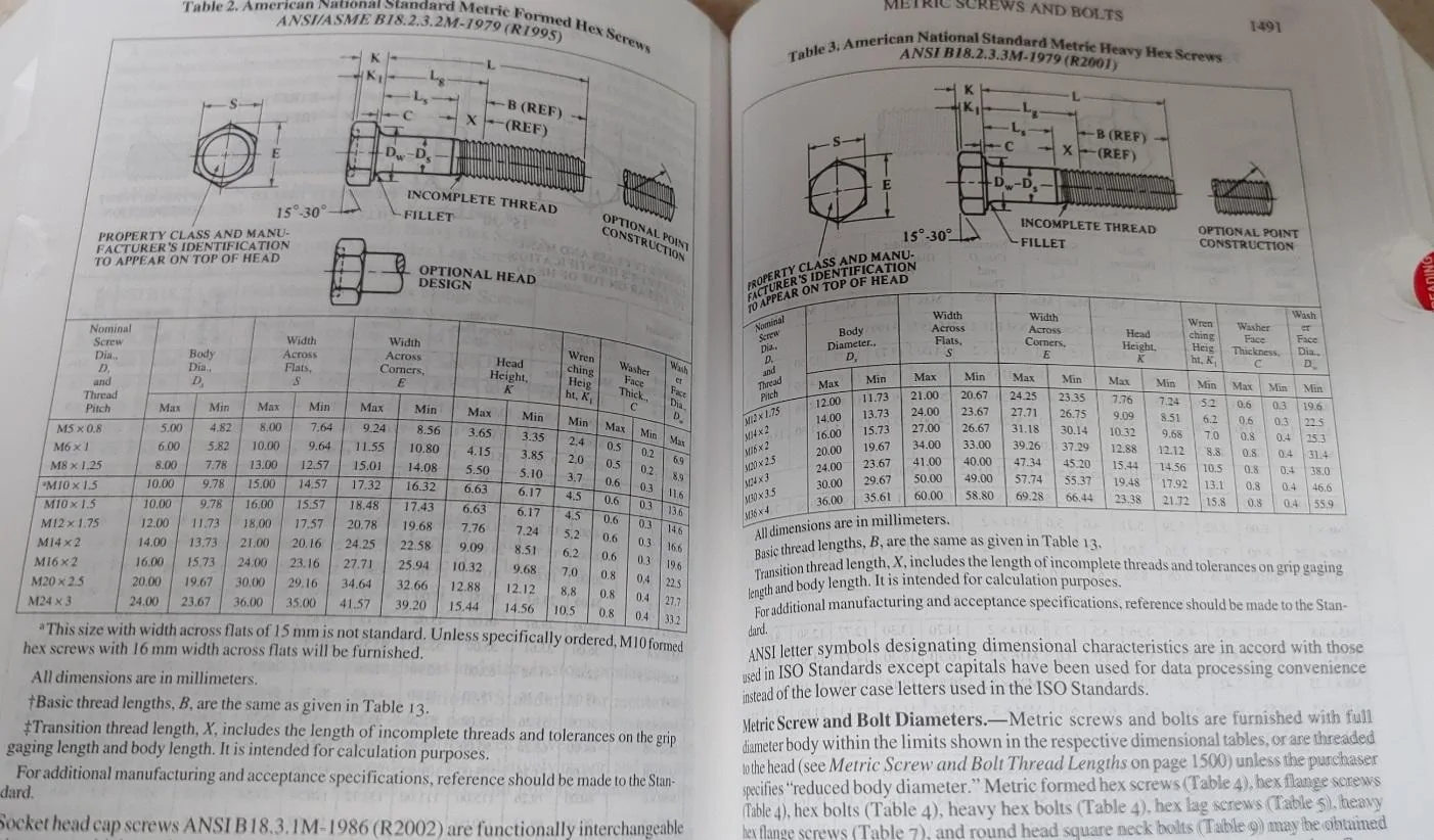

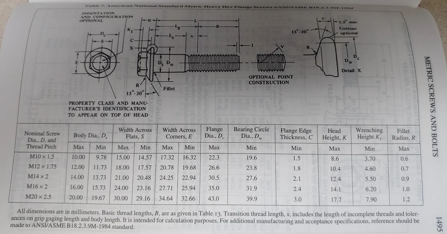

I'll post pictures from my machinery handbook 25th edition. There are dozens of pages covering the topic of "bolts" and several pages of tech specs! Wow, yet a bolt is just a bolt.
Here's part of why I say "a bolt isn't just a bolt" and "these aren't "just bolts""
If you walk into a hardware store and ask for bolts - you will likely first see the SAE section, grade 5 (3 marks, the most common)
And if you then ask for grade 8 - they'll take you to the US SAE grade 8 bolts unless they are ignorant of metric specs and have no clue that there's no "grade" on metric, they are "class. Look at the top of the bolt - it will say right on it 8.8 or 10.9
There are no SAE bolts in these trucks - they are metric. There is no such thing as a grade 8 metric bolt. Metric "bolts" are classified literally in classes. Class 8.8 is roughly equal to our grade 5 bolts.
Class 10.9 is roughly equal to our SAE grade 8.
So you don't want a grade 8, that's US standard thread. You want a metric in class 10.9..
Anyone who has any education on hardware will listen to grade 8 and take you back to the 1/2" bolts and not the metric area. Only those who don't know better and were flipping burgers last month will do otherwise. But then you get what you get in SOME hardware stores.
So, these are all metric, thus you need either a standard class 8.8 for non-important things, and for any suspension, steering or brakes will require class 10.9
The SHAPE and type of head is critical in the clamping force and how they torque.
Some may have heard of TTY - Torque To Yield, or "torque plus degrees or angle.
Critical spots usually use this method, not always it seems, but as an example, the steering gear to frame bolts are torque plus angle.
The stress on caliper bolts is tremendous! So the CLAMPING FORCE is critical. And it's that which holds the thing in place, not the sheer strength of the bolt in the hole, but how hard it's clamped. Thus, the specific shape of the bolt head.
OK, bolt vs. cap screw, etc.
PLEASE NOTE HOW EACH IS MADE - this is important because some hardware stores sell "bolts" as bolts and some sell CAP screws as bolts and I'll bet a big mac that 90% of those reading this thread had no idea there was even a difference, this was even a thing or that one was made by cold-heading and the other were made by hot forging.
Still think a bolt is just a bolt? Sure hope not. This alone should dispel that shade-tree idea.
Cold-heading vs forged, washer shape under head vs no washer shape.
SOME hardware stores sell them interchangeably. NOT ALWAYS, some will actually show them as cap screws next to the SKU number - good for them! So take a look - is your hardware store selling you bolts or cap screws?
Of the bolts/capscrews/flange head bolts shown below - which do you want stopping a 5,000 pound truck in under 5 seconds?
What is the difference between a hex bolt and a hex cap screw?
A hex cap screw has tighter tolerances on the body dimensions and features a chamfered end and a washer face under the bolt head. A hex cap screw is often called a finished hex bolt. Hex bolts have a flat end and lack the washer face under the head.
Now, which does YOUR hardware store sell as "bolts"?
Hex cap screws
  • Flat washer facing under the head that meet specific tolerances as described under ASME B18.2.1-1996.
  • They will usually be manufactured by a cold-heading process (large runs of standard sizes) or turned CNC operation.
  • A radius under the head at the shank.
  • Body diameter of plus nothing, minus .011″ for an 1-1/4″ diameter fastener.
  • Some common fastener specifications unless otherwise specified: ASTM A449 and SAE J429 Grade 2, 5, and 8.
Hex bolts
  • A die seam across the bearing surface is permissible.
  • The typical bolt is manufactured by hot-forging process.
  • Allows a reduced body diameter to be not less than the minimum pitch diameter of the thread.
  • Some common fastener specifications unless otherwise specified: ASTM A307A, A354, and F1554.
In the pictures below - notice the difference between a simple hex head "bolt" vs a cap screw. The cap screw has a sort of washer surface made right into it. What you get at a hardware store may be a bolt, or it may be a cap screw - depending on what they order or what their supplier gives them. There's a difference and true automotive professionals know this (as opposed to DIY experts that just put bolts in holes)
Then look at the style of bolt the OP bought - bravo! A true caliper bolt complete with locking compound and washer head. There's reasons bolts have flange heads or are threaded part way or all the way - differences in stretch, clamping force and more.
This shows dozens of pages related to various "bolt" types -

These are specs for "flange head" bolts. VERY specific on the sizes because that directly impacts the CLAMPING force and the TORQUE.
This is the type typically used on brake parts and other important parts.

And the cap screw - some hardware stores sell these as "bolts" - well, they sort of are, but are also different because of HOW THEY ARE MADE at the factory, and the shape under the head. Note the really close specs on that shape of the head and underside of the head.

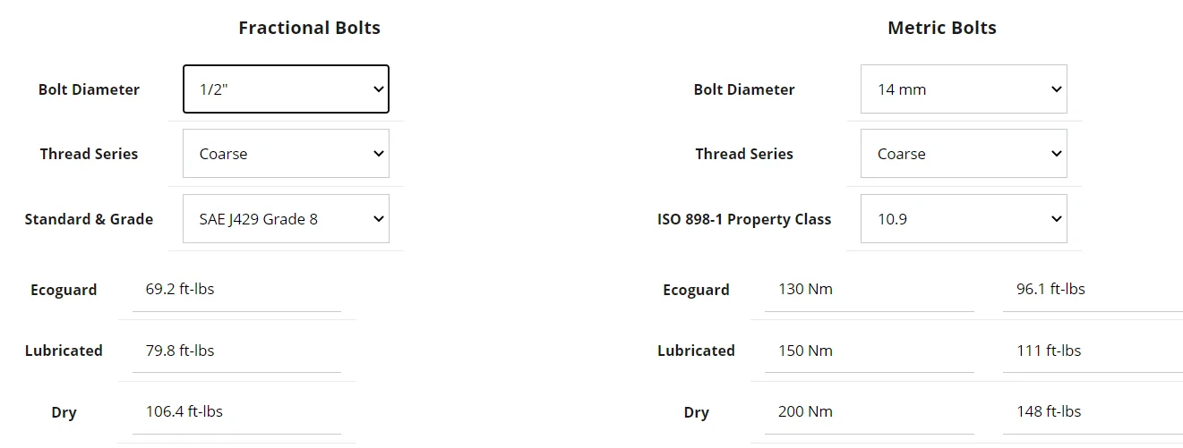

Comparing similar sized SAE/US to metric (grade 8 to CLASS 10.9)

Why it matters if that bolt is a bolt, a cap screw or a flange head bolt - TORQUE vs. stretch and clamping force.
Found this in my notes and documents -
During tightening roughly 90% of input energy is lost overcoming the mating friction under the head, nut, and mating threads.
Only 10% of input energy is converted into bolt stretch. (this is over-simplified of course)
In most situations there is a relatively simple relationship between the torque applied to the bolt or nut and the tension created in it. Usually this relationship is linear. For such cases, the equation:
Torque = K x d x F is applicable; where d is the nominal diameter, F is the clamp load, and K is a
torque variable (Nut Factor).
This equation implies a linear elastic zone of torque verses angle-tightening curve. For most
common fastener materials the engineering values of the first two variables (d & F) are well defined.
The problem with this equation lies in the Nut Factor (K).
The K, or nut factor, can be thought of as anything that increases or decreases the friction within
the threads of the nut. This is a combination of three sub-factors:
K1, a geometric factor- the shape of the threads. Variation in the shape of the thread may
cause friction to increase or decrease.
K2, a thread friction related factor- the friction between the threads of the bolt and the
threads of the nut. (plating or lube is a factor - zinc plating changes things)
K3, an underhead friction related factor
Hmmm, bolt has the entire hex head in contact with the surface below, cap screw has less surface area due to the built-in "washer" shape under the head. Flange head has more surface area in contact.
The question related to threads all the way to the head vs a longer unthreaded area - brake calipers rely on clamping forces to prevent sheer. The threads are the smallest part of the bolt and thus the weakest part of the bolt. If a bolt is going to break due to tension or sheer, it would most likely be in the threaded area.
I've got pages of information on clamping forces, bolt stretch, torque control, sheer forces and so on. When you modify suspension and brakes, and do restoration, or want to pass certain certifications or tests........
