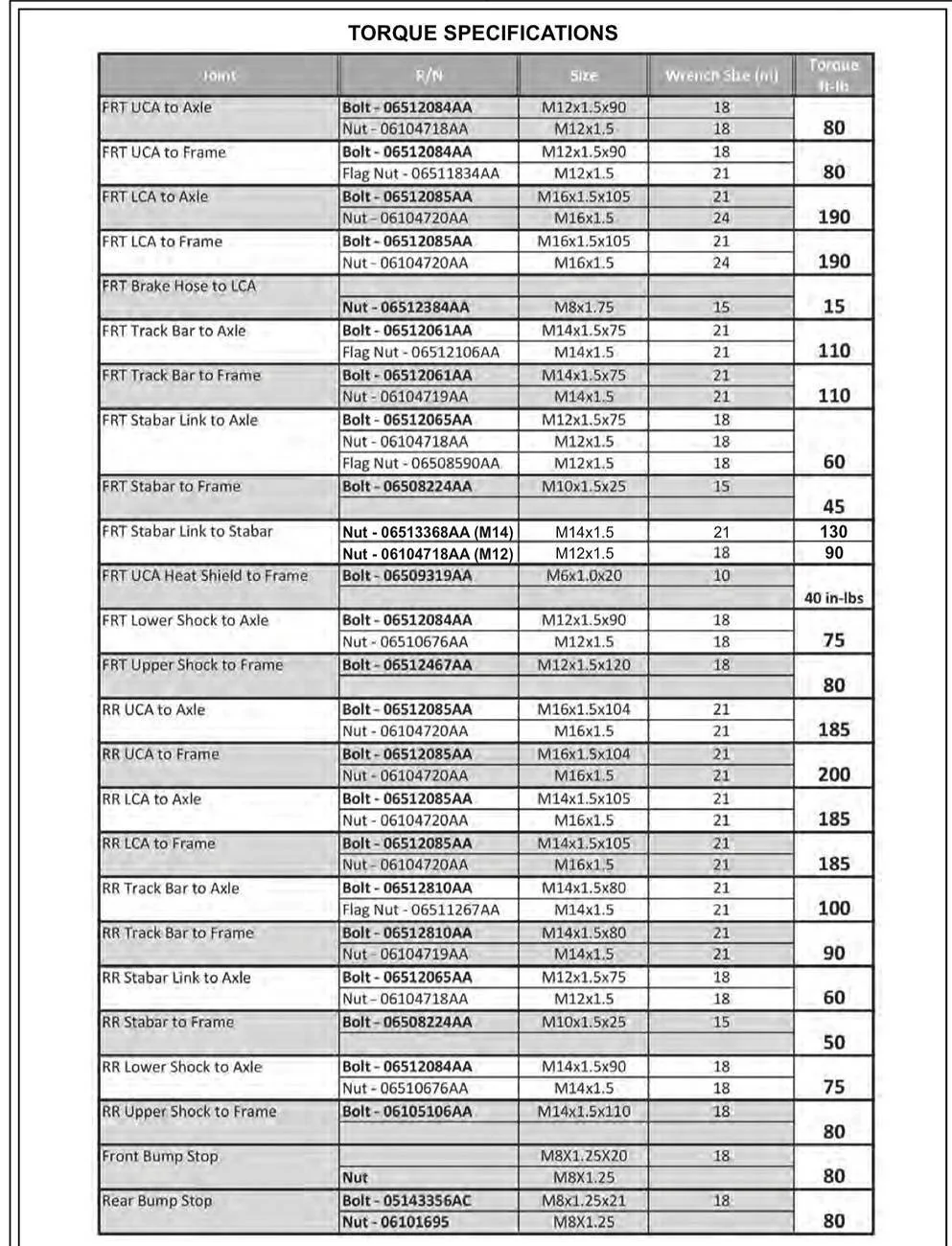

Just wanted to thank you all for the replies, tips, and advice.
Driving over the same highway with many “seams” I never had any issue with the wobble returning.
I also looked at the springs on both sides and both are vertically straight. I think the angle of the camera I had when taking the photo distorted the height of the sway bars and the angle of the springs.
I’m not sure about the sway bars - they should be the appropriate lengths on the front and back as they are the ones that came with the Teraflex lift
I am currently at discount tire getting a quick tire rotation and balance check.
I not it’s not a lot but getting my own 250lbs torque wrench and checking the torque on the bolts this weekend was a bit enlightening. At the end of day it is bolts and nuts. It has given me some light that I should pursue to work on my own JT.
I’d like to pursue that and slowly acquire a good impact wrench and floor jack / jack stands.
