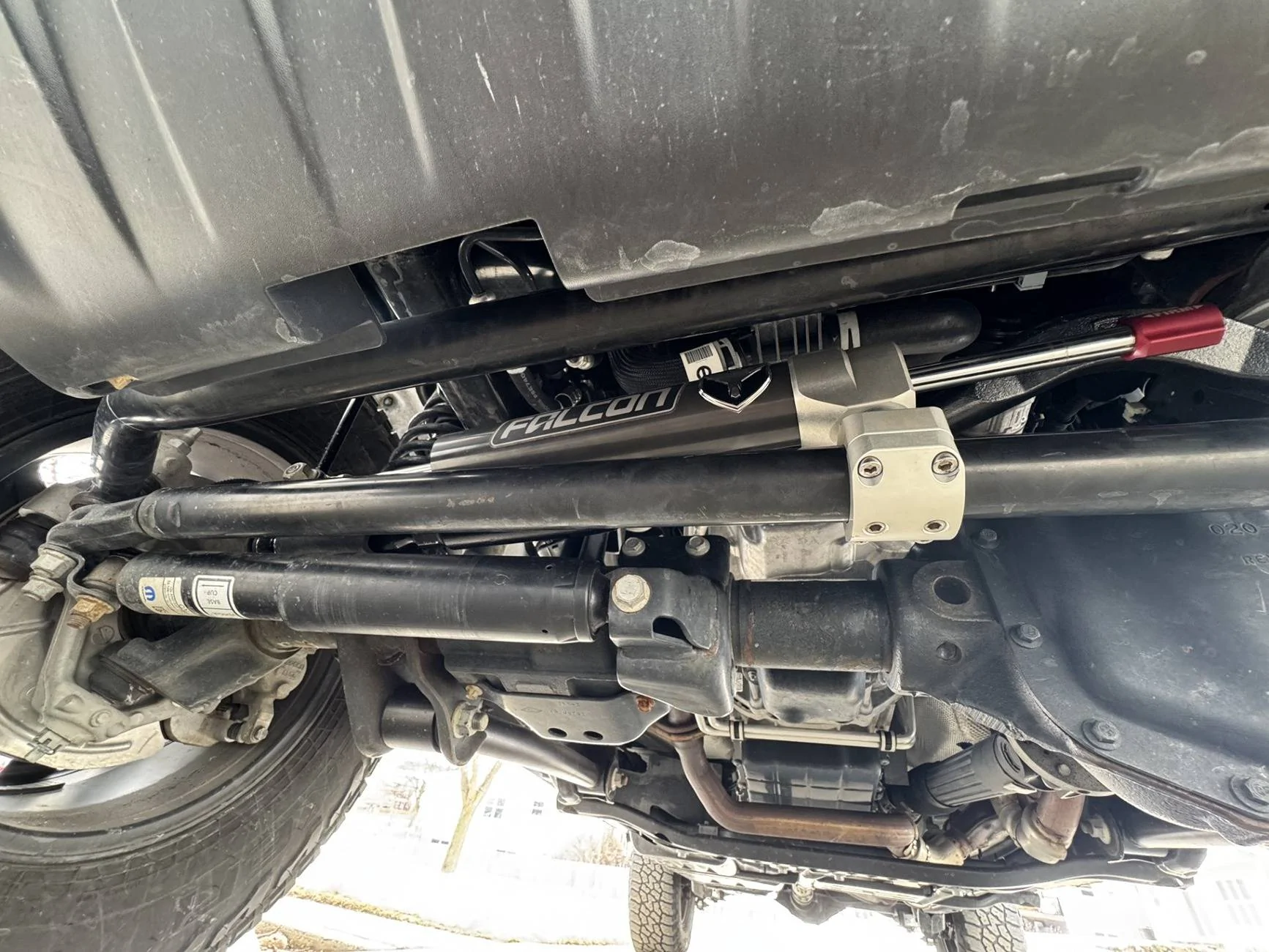

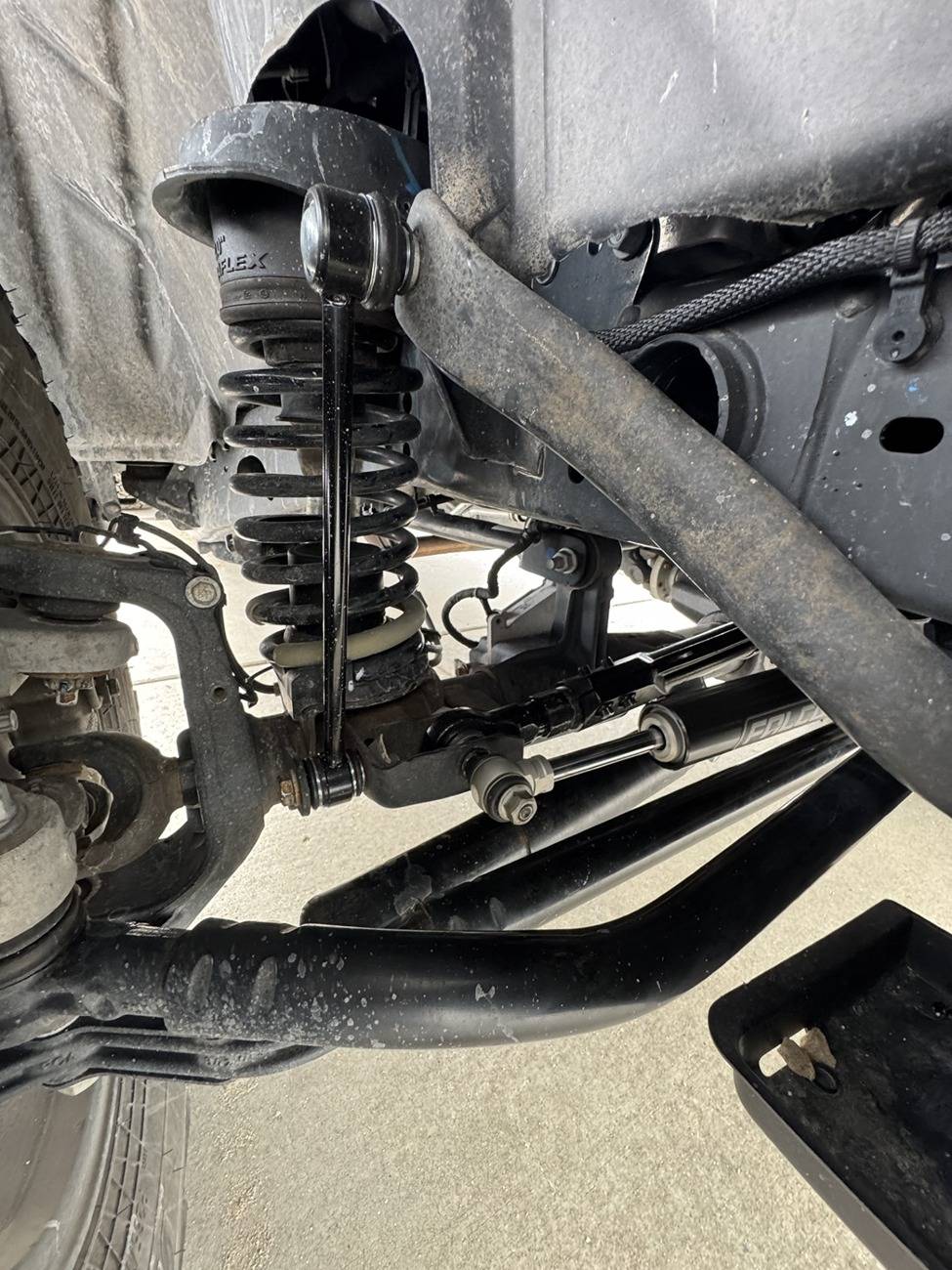

Welllll I was able to get it into the 4x4 shop.
The guys re-checked/torqued all of the bolts of the new parts, and did a look over of the rest of the front suspension and re-checked the alignment.
They summarized that everything checked out - and recommended the seemingly universally hated and dreaded "band aid fix' - a new steering stabilizer. He had the Falcon Nexus EF 2.2 in stock and ready to install.
Listen, I didn't want to offend the shop/mechanic as I have used them before without any issues - and again, they are very highly recommended. And my knowledge level goes as far as what I read on forums. So I went ahead and let them put on the stabilizer. He actually didn't charge me for labor which was cool... and the part was like $385.
I know, again I'm sure a lot of you are shaking your heads.
All I kept thinking in my head is - my wife is probably wanting to strangle my neck at the moment for putting a lift on my JT that I really only wanted for aesthetics, but now that I've done that I have allowed something to screw up to the point where if we take a trip on the interstate and I'm going 70mph and I hit a bump - my Jeep goes in death wobble mode as my three year old and three week old are in the back... Oh, and I let a 4x4 shop do the work on my slightly over two year oldish JT and not the "official" dealer who wanted to put on an incomplete MOPAR lift for like $4k total.
I know, I know. The real problem is not fixed apparently. But I drove home, went over the same line/seam in the road bridge where I kept getting the DW, sped up to 75mph and drove right over it without the shakes.
The one thing I am super confused about, and have to call the 4x4 shop back is.... it looks like the OEM MOPAR steering stabilizer is still..... on? Along with the new Falcon Nexus....
Is this right? I don't know. Again, I'm a noob when it comes to this stuff. Driving it, it felt right... but why is the old one still on along with the new?
Then I started watching a few youtbe videos and it looks like there are multiple ways of mounting these things..
It's Monday late AM and I think I need a drink or a reset to the point where I just go back to my JT with the simple 1.5 level.
