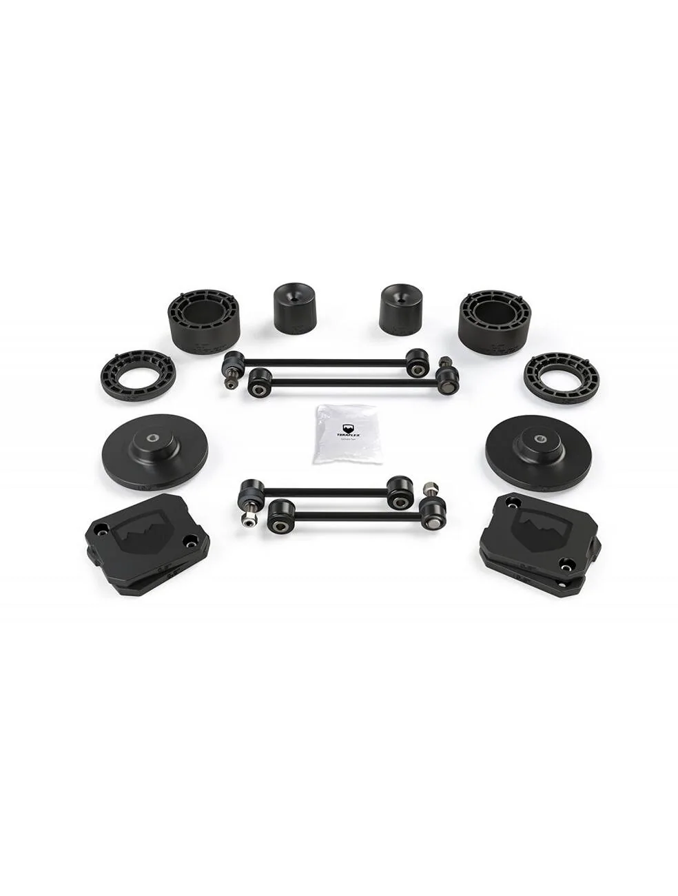

Spacer Lift:
Jeep Gladiator It happened to me: Death Wobble after spacer lift. Help! 1740239044095-wj

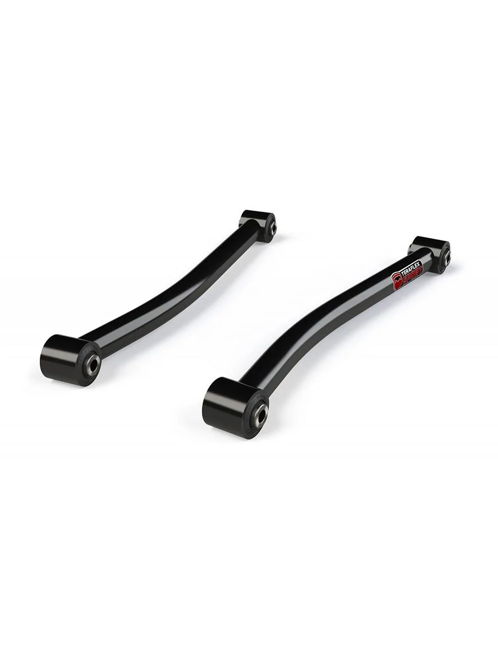

LCA's:
Jeep Gladiator It happened to me: Death Wobble after spacer lift. Help! 1740239074320-z6

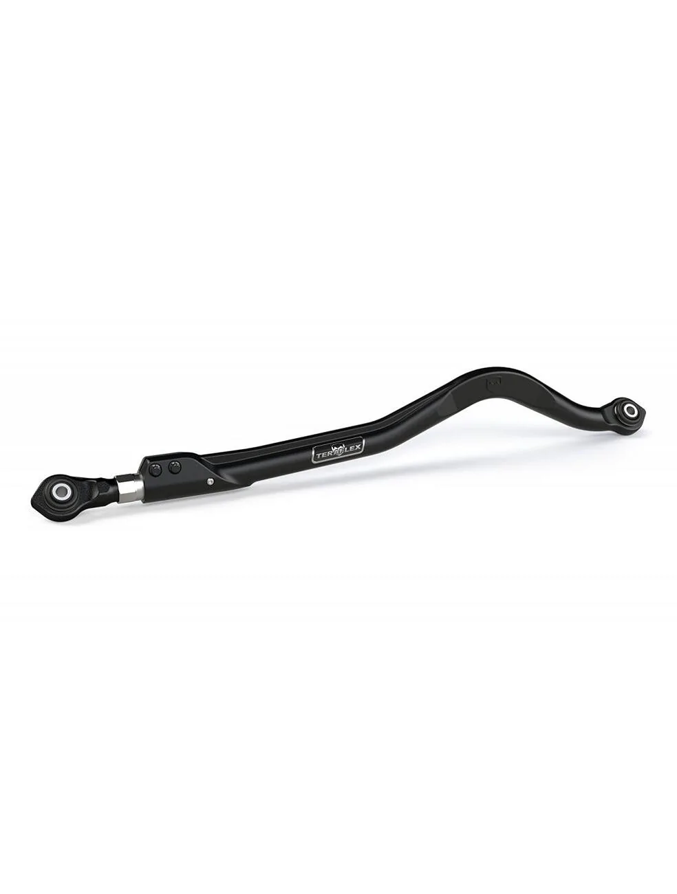

Font Track Bar:
Jeep Gladiator It happened to me: Death Wobble after spacer lift. Help! 1740239106266-0l

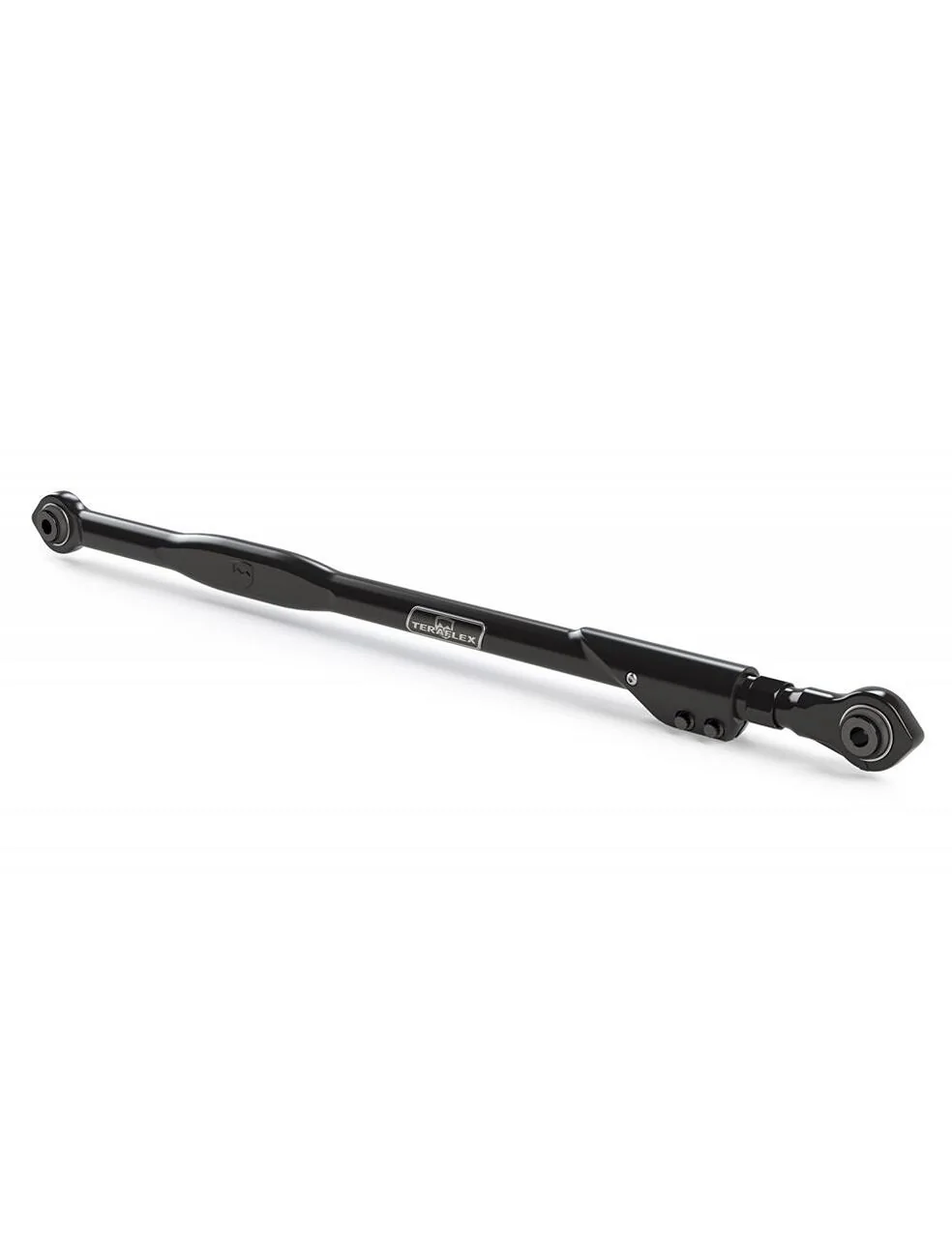

Rear Track Bar:
Jeep Gladiator It happened to me: Death Wobble after spacer lift. Help! 1740239130369-dl
