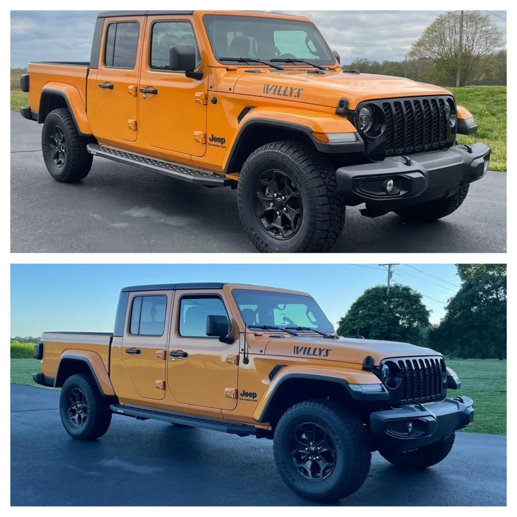

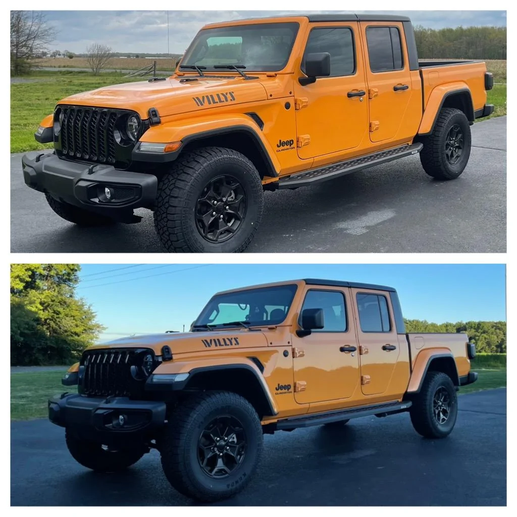

2021 Nacho Willys Gladiator
Here is mine with the stiffest gasser Rubicon front springs, max tow rear springs and the 1" front spacer from the Teraflex kit. Netted about 1 3/4".
Top pics are stock suspension with 285/70-17 tires. Bottom pics are with everything installed.
Jeep Gladiator Jeep Gladiator Sport S (Non-Max Tow) Suspension Question 2884DDA8-23B9-47ED-B9BF-D7D67A41ED26
Jeep Gladiator Jeep Gladiator Sport S (Non-Max Tow) Suspension Question B23E7474-D28C-4AAF-94F1-5D74EF602DF5
If I had it to do over again I'd probably just go with a good 2" spacer lift with 2" over shocks and call it a day. AEV and Iron Rock Offroad are much better options than Rough Country.
Love that stance and such a nice looking Willy's

I love your truck so you wouldn't install the rubicon springs if you had to do it again?
