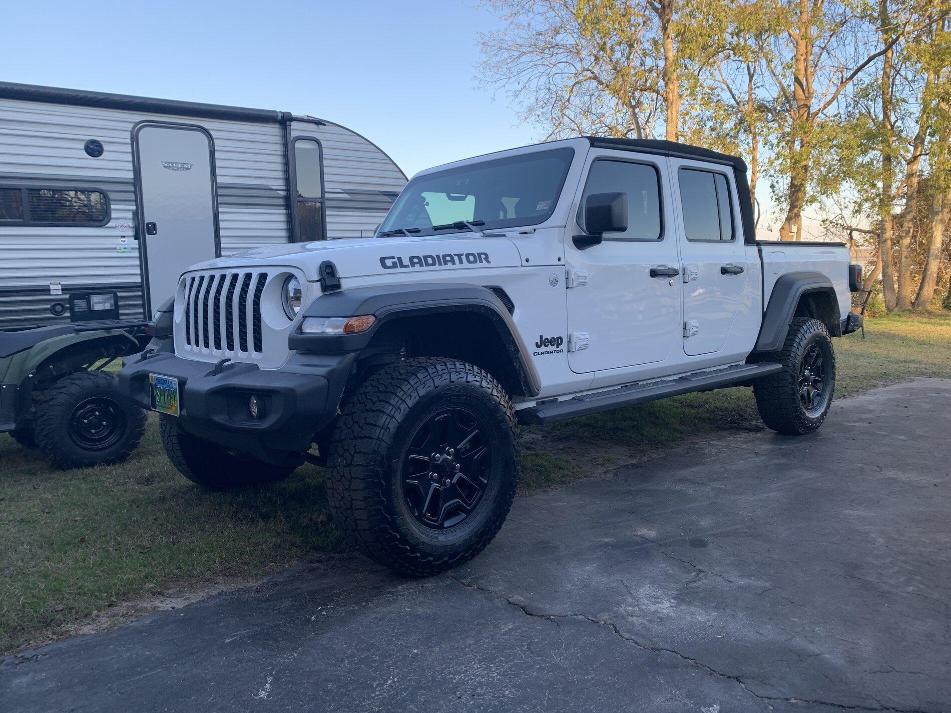

I have a max tow, did a 2” spacer lift and added front rubicon springs, which nearly leveled it. I would not alter the rear springs because this would alter the way it handles towing loads. I wouldn’t change then just to do it.
I tow a 6500 TT with this set up and no issues .
